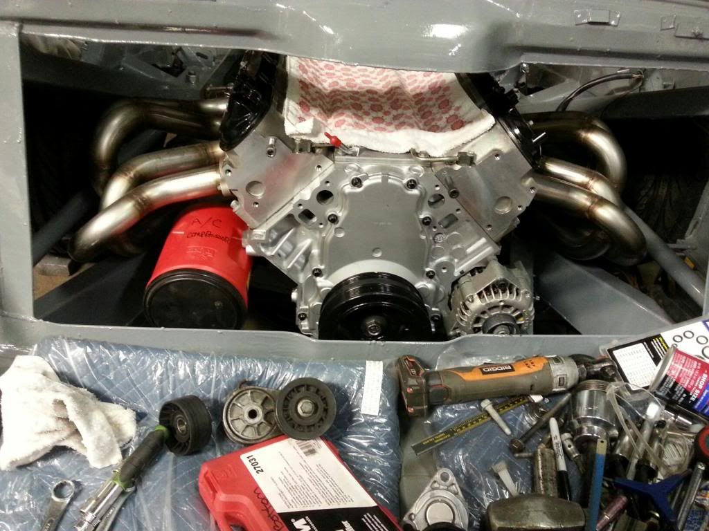

Starting to put things together. I am mocking up where to mount the A/C
compressor. I've seen a number of compressors that will fit the space represented by the coffee (red) plastic container. I am also looking for a power steering pump to put in the center above the crank shaft pulley to act as a pump and an adjuster. I was able to install the alternator quite easily, it didn't fit but was close. I had to cut a small amount off the case of the unit and refit one of the 3 housing bolts. Having done that it fits tight & keeping it low as I can. Trying to keep everything mounted as low as I can on this build as overall CG is paramount to me.

Moving along building this project, it seems almost endless. I am getting the engine together and building the cooling system. I've got the 914 wiring harness installed and have the LS1 unit ready to install. I'm going to use 2 Spal 12 inch fans. I think they seem small but they say each is rated at 3,000 cfm that's a total of 6,000 cfm. I'm going to call Spal and ask them about this spec. to be sure. I'm also looking at a clutch, its a pricy unit because I have to use a Porsche 911 unit.
