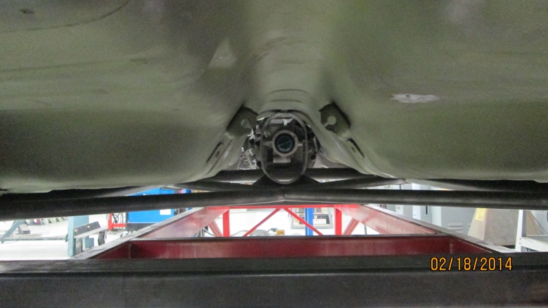

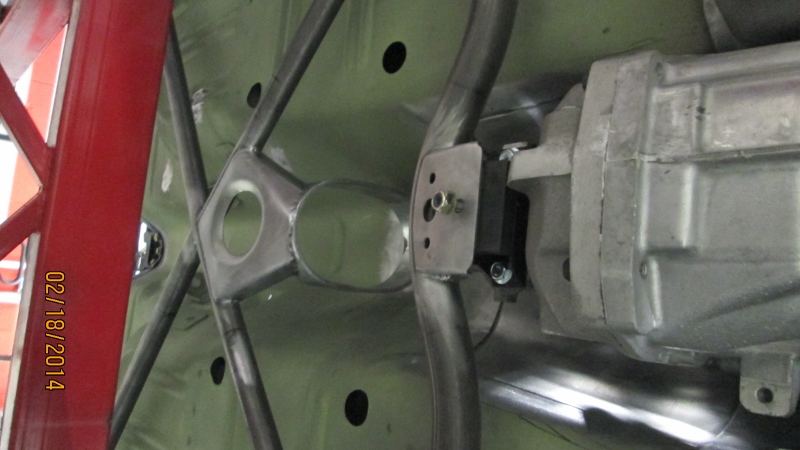

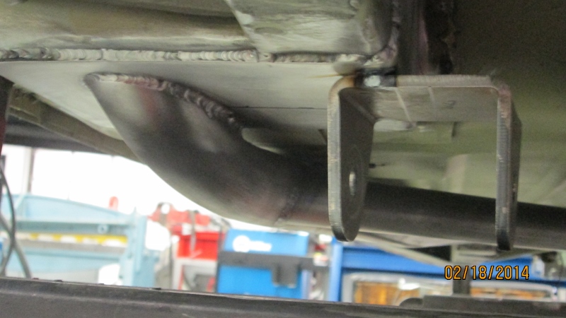

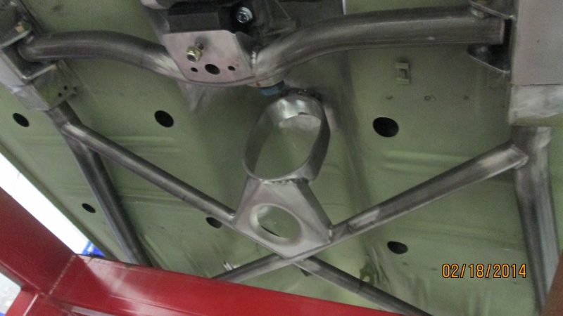

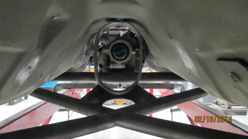

CNDbowtie, the SoT 3 link did come with the watts link. Had to due some fabricating to shorten it since I lowered the car and tubbed it. Still working on the 3 link setup to fit. The SoT 3-link is designed for a factory car with factory ride height, which I feel sits too high.
Worked on the frame rails and cross bracing. The tubing for frame rail tie-ins are run through original frame to the torque box and then plug weld inside the frame. (I don't think you can see the plug welds in the pics).

Just noticed. The first photo is the front mount for the trailing arm and is just tack weld for now. It'll be tied into the frame rails.
