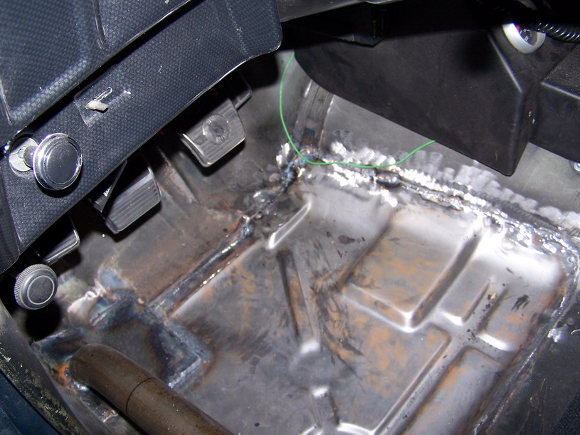

Thanks for your input guys. I am going to call Eddie's on Mon morning and ask him to add the cross bars. Thanks for your help. He is also replacing my driverside floor. I had a surprise when I pulled the carpet out a couple of months ago. A hole in the floor was repaired with a licence plate. You can kind of see it in the picture I attached. The car has no rust any where else on the floor so I wonder what caused the hole. Weird. I got a new stamped floor from Classic Industries.

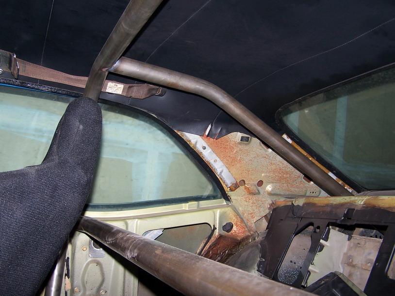

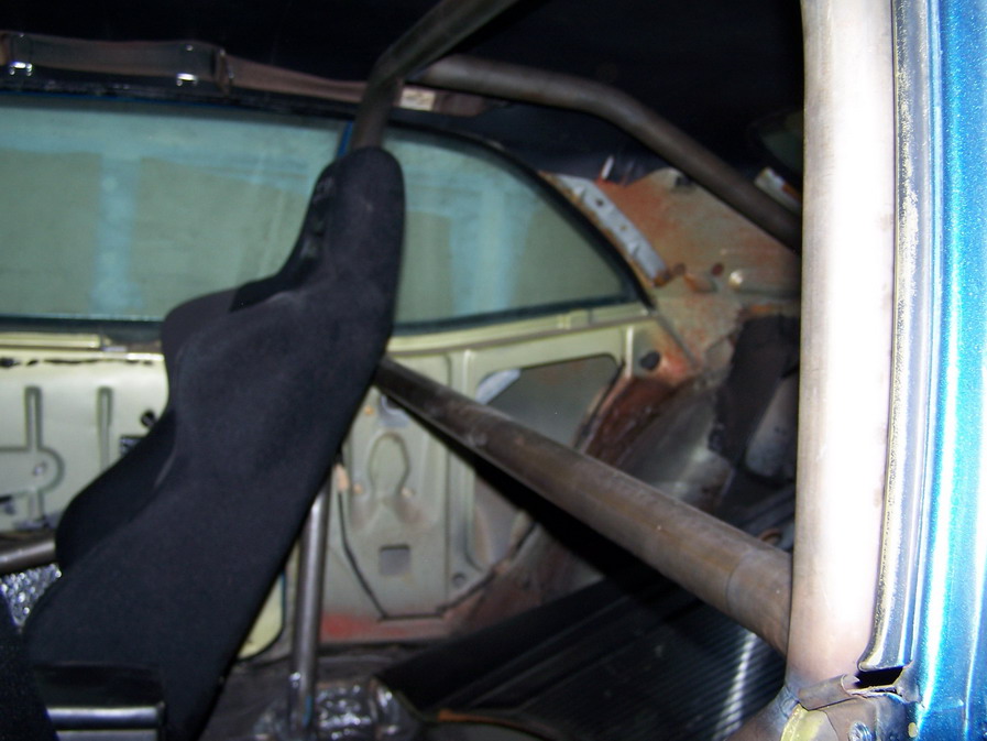

Marty I thought it was to late because I Already had asked him to put in the strait door bars. He called me today and told me that with strait bars I would need to remove the arm rests from the door. Then I asked him to put the curve in the bar and run the bars under the arm rest like yours is. He is also using the bar you have that goes from the middle of the bend to were the main hoop and the floor meet. Thanks alot for your pictures. I always wanted to build a 4.3 TT for a Corvair project.

PICTURES!! I got her back today!!! They couldn't get the bar that goes from the bend in the door bar to where the main hoop and the floor to meet without hitting the recline knob on the Cobra seats. We decided just to not use the bar. I think it turned out great. I noticed a huge difference in stiffness. The car does not rattle nearly as much as before when going over messed up roads. The floor patch was also done very well. Thanks guys for your input.
