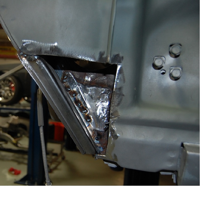

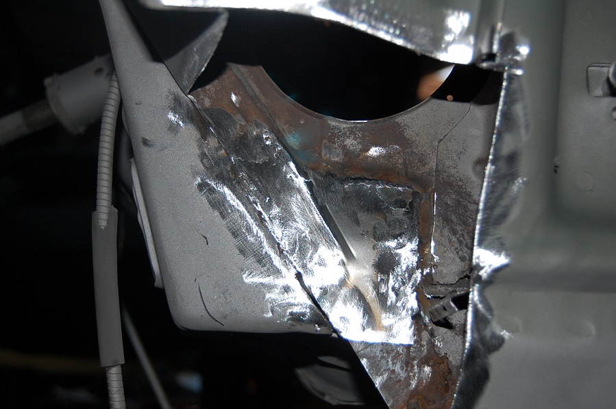

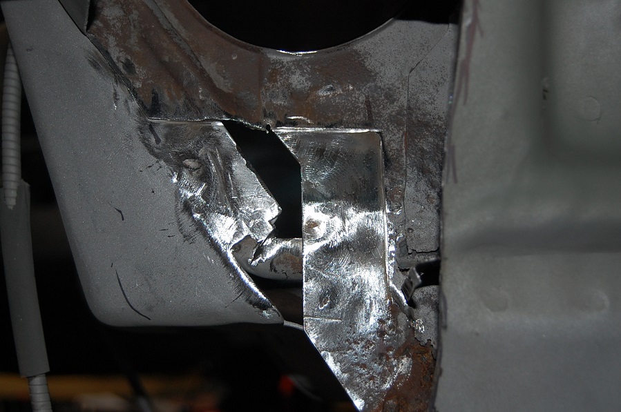

Some boring metal work....rust repair and treating.
Lower cowl tulip was badly rusted. I trimmed out as much as the rust that I could then reconstructed the missing parts with cold rolled 16 ga.
Before the outer cowl section gets welded in I coated the exposed metal in the lower area with POR15 and weld through primer at the weld areas.

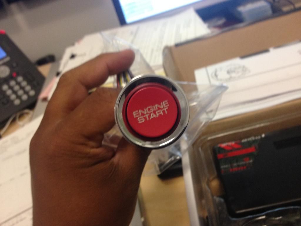

In with the new.... H.I.D headlights
In with the new LED Tail lights.......
In with the new VHX dakota digital dash
