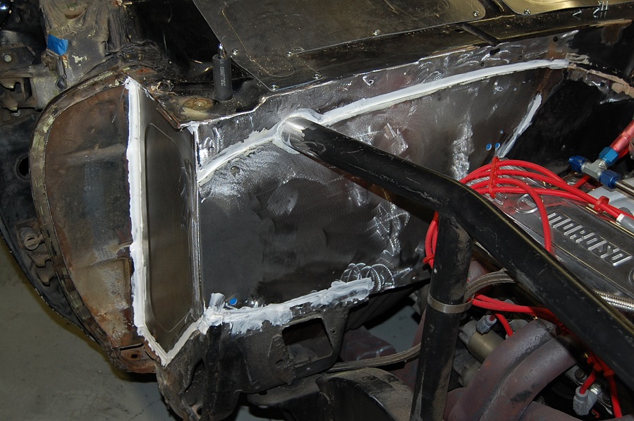

The tulip sections of the firewall were rusted up pretty bad so we decided to cut them out and I found a better place to mount the Moroso oil Accumulator.

More metal work.
We are closing up the firewall and down bars holes changing a few things around.
One of these changes is the clutch and brake master locations. We were unable to access the brake fluid due to the down bars so we went with a Strange compact dual screw off car master.
Usually I would run a master plate but in this case we needed more room up front so I recessed the clutch master a bit. Should clean the area up too.
Pictures tell the tale.
