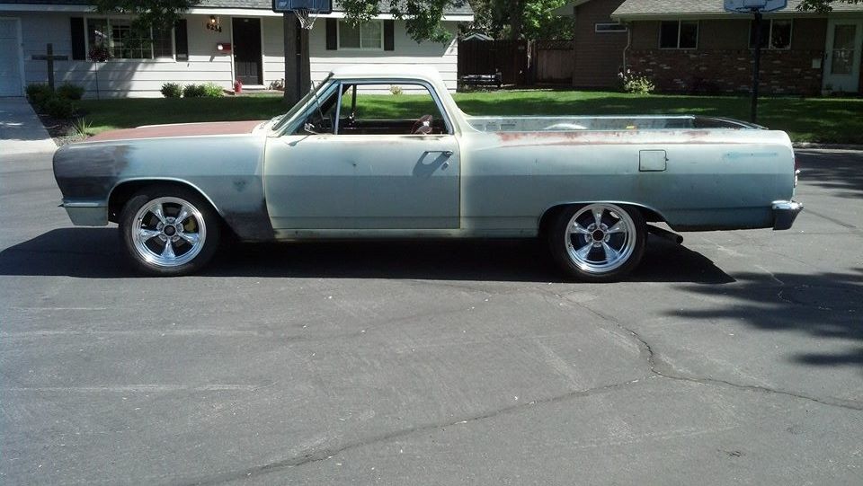

Got the tires and wheels mounted up today . Specs are 17x8 with 4.81 inches of backspacing on the front with a 245/45r17 BFG KDW-2 , 17x9.5 with 5.5 backspacing on the rear with a 275/40r17 BFG KDW-2 . The rear is fairly tight but I can get my fingers in between the tire and the fender well . If and when I have the money to order custom wheels I will run a 6 inch backspacing as that would have centered it perfectly . Still leaves me some money for a few other projects and gets rid of the rubbing issues .
