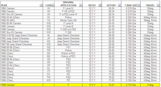

STEERING BOX Chart

I have a 600 box i got from Camaro Central. I got the 14:1 beeing the first time i was trying a fast ratio and not knowing exactly what would happen lol!! I have generally went with overkill from the start all my life and now trying to slow down from lessons learned.... I should have gone 12:1 dammit!!!
Yeah, i LOVE the upgraded feeling but after driving it for a summer, i feel like im used to it and its back to some lesser feeling. Is there a major difference between 12 and 14:1 ?
David, you mentionned you'd go with faster than 12:7, what would you use and who makes faster than that?
Would you use faster than 12:7 in any street driven car?
Thanks guys,
Lead.

Originally Posted by David Pozzi View Post
I would not do a faster ratio than 12.7:1
Thanks guys,
Lead.
Cars get real twitchy with too much.

I'm running a Lee 12.7:1 box with their firmest valving and love it. It's a little twitchy at times in rutted lanes and rough roads. 90* public road turns can be done leaving two hands on a 13" wheel. I think any quicker could get borderline dangerous on PT oriented cars.
