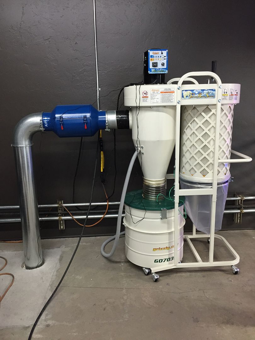

First you need a "DUST COLLECTOR" --- but don't forget to add a SPARK ARRESTOR (the blue piece) lest you start your dust collector on fire!!

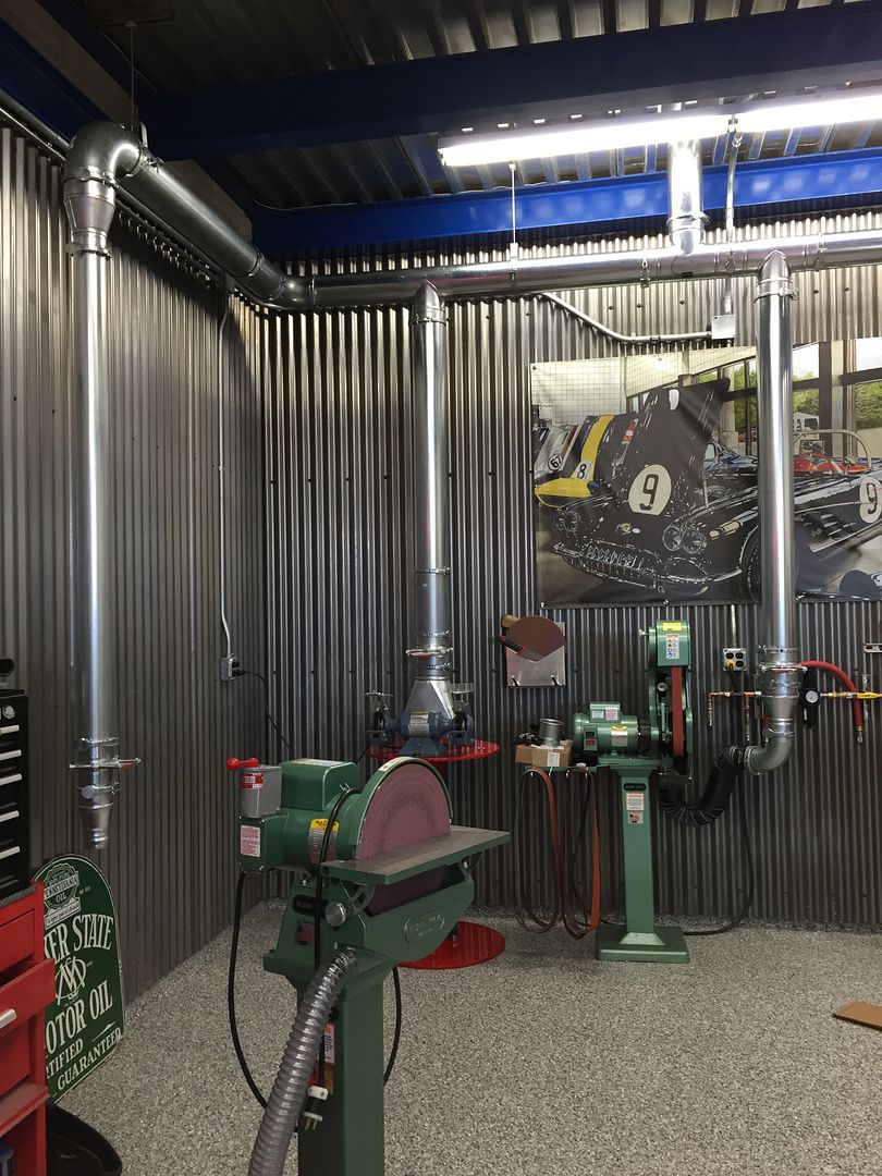

These pictures were all taken during the build out process so nothing is tidy'd up yet.... but you'll get the drift.
Then get yourself a bunch of parts and pieces from NORDFAB DUCTING. The beauty of this stuff is it goes together with clamp bands and can be adjusted or moved or taken apart and moved... Added to or subtracted from as needed.

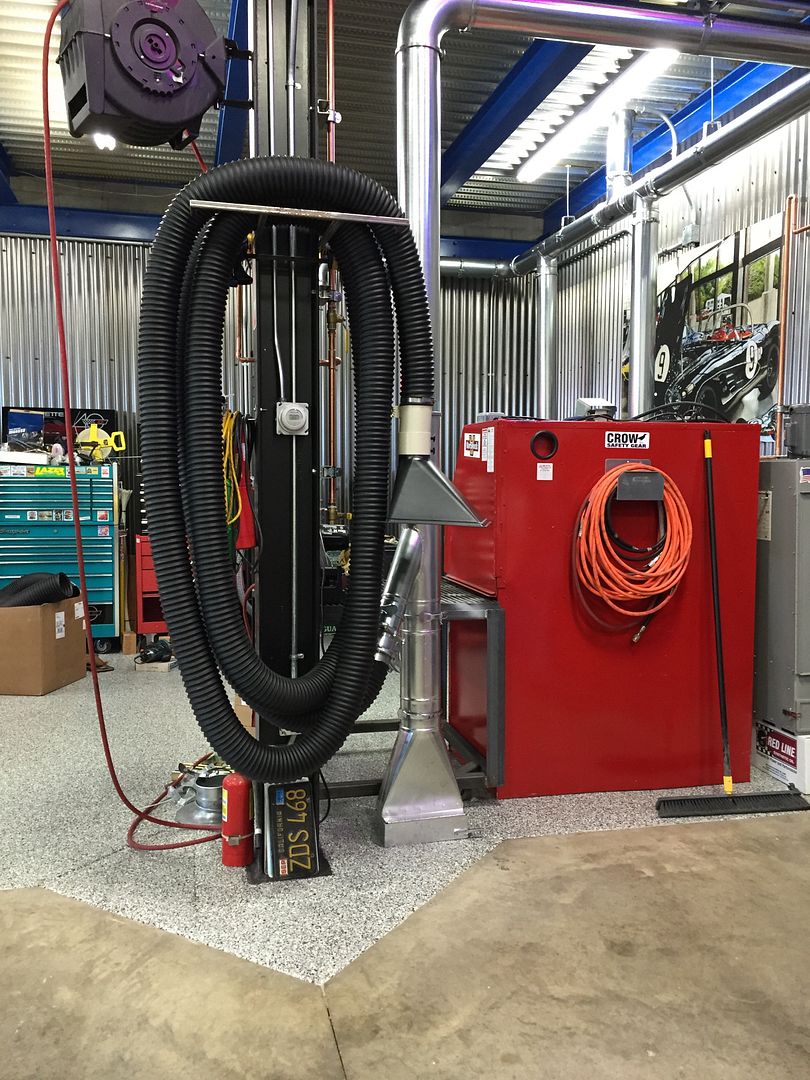

The 4" hose X 40' of it - allows me to put the "big mouth" (Grizzly Tools) either on a stand it came with -- or just toss it inside a car etc.... ALL of this is controlled by METAL blast gates to control the suction where I need it.

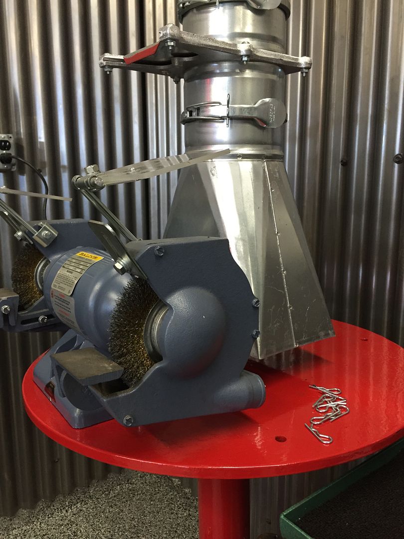

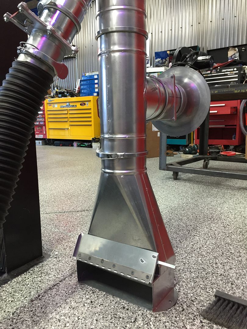

This leg - has the 4" "big mouth" on a Y -- and then a bell mouth pick up that will be fabled into a sheet metal "tub" that is being built to go under my grinding table (has a grated top)..... shut off the 4" --- or shut off the 6" grinding table with the blast gate - and kick up the "toe kick" dust pan. This is towards the front of the Lift in my shop..... I can just grab a push broom and push the crud this direction and up she'll go!!

The Dust collector is 775 CFM -- so think a big block with a 750 Holley at WOT.... It sucks pretty good! But NOT good enough to have multiple openings going at once --- so if using multiple machines at once and not having to use the blast gates you'll need more CFM! This machine is 1.5 HP and comes 110V single phase -- we ordered the option to convert it to 220V.... as it will then draw less amperage. My trunk run and laterals are 6" ducting.
http://www.grizzly.com/products/1-1-...-Series/G0703P
I may decide to replace it with a more powerful machine.... Now that I see how great this is going to be!

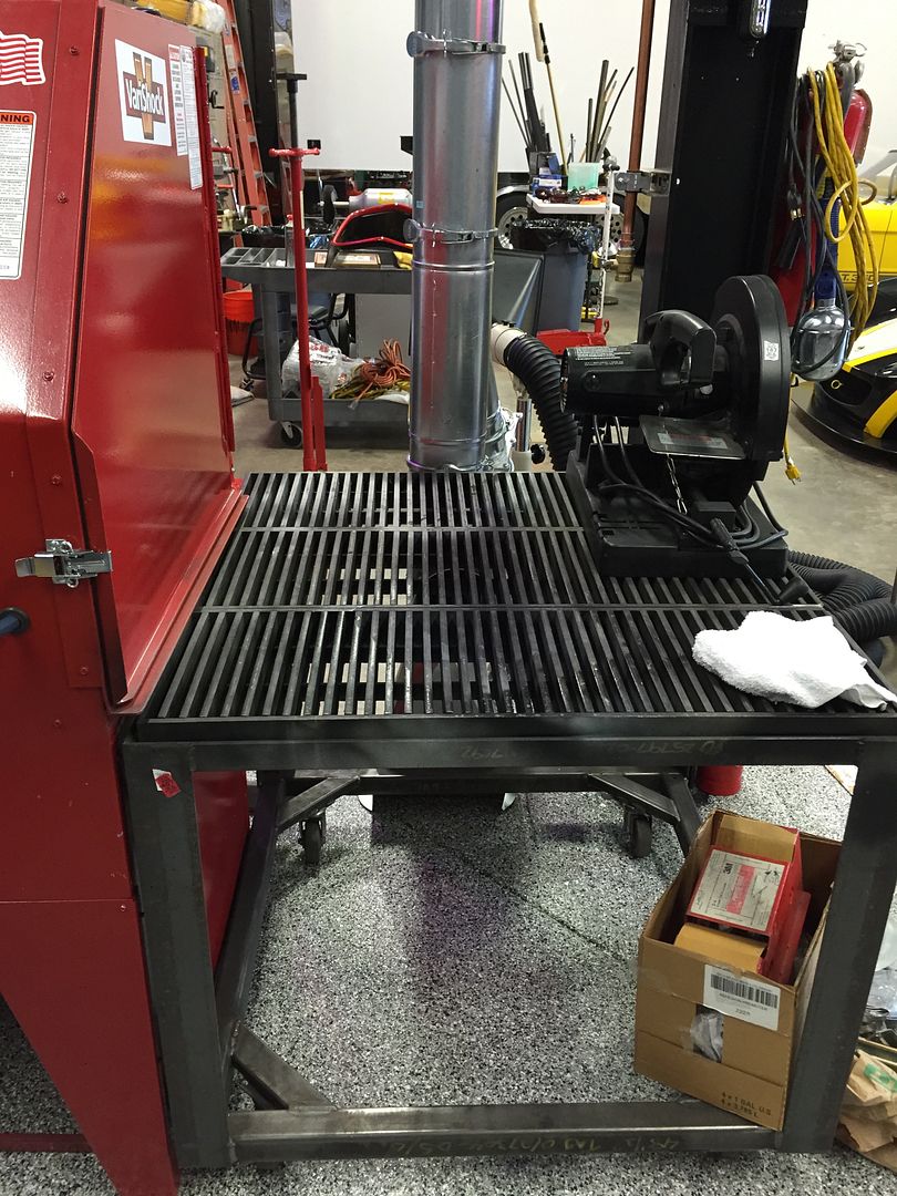

This is the downdraft table I'm building.... just haven't finished up the collector pan under the grates. I paid $5 for each grate at Boeing surplus... they weight 120 pounds EACH -- 1 foot X 3 foot.... The "heavies" should fall to the bottom of the pan - while the dust should be contained and or sucked up in the 6" ducting. I'm making 2 removable sides (the third "side" is the bead blaster)... to 'direct' the grinding dust back down into the grated area.
I don't expect to contain 100%.... But if I can keep a majority of the filth from just floating all over the shop I'll be happy.

Storm drain grates. 3/8" X 3" strap built into a 1 foot X 3 foot grate - $5 Each. You couldn't buy a 10' stick of strap for the $5.
My biggest regret is not having bought the whole pallet of them. I probably could have gotten $10 each in scrap price.
