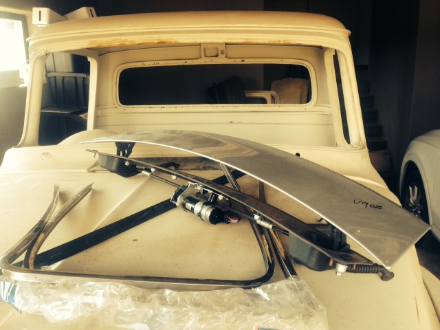

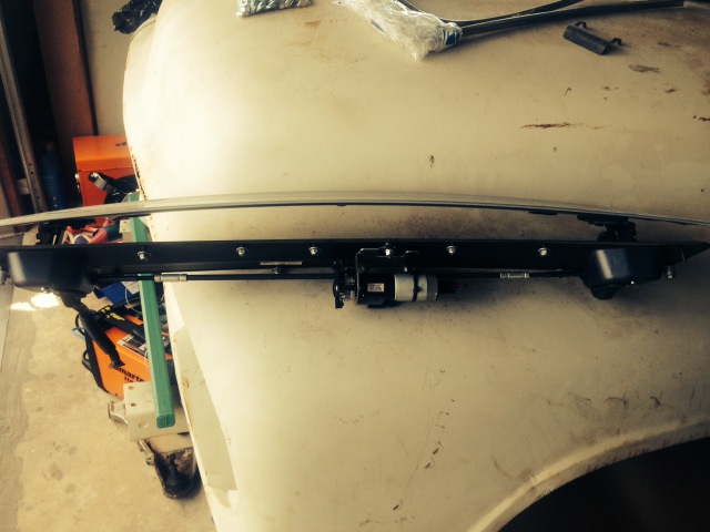

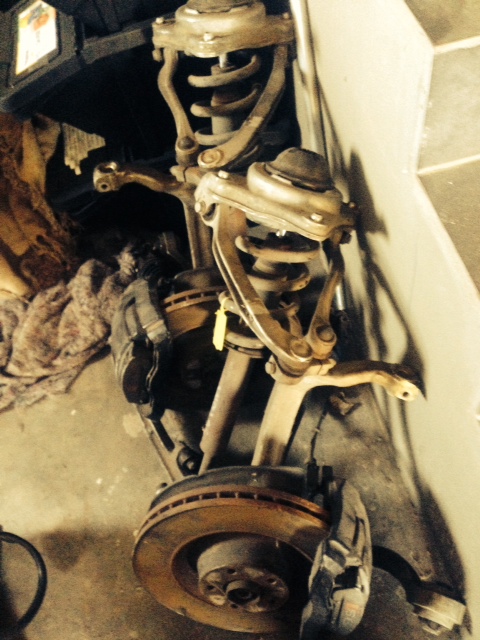

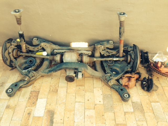

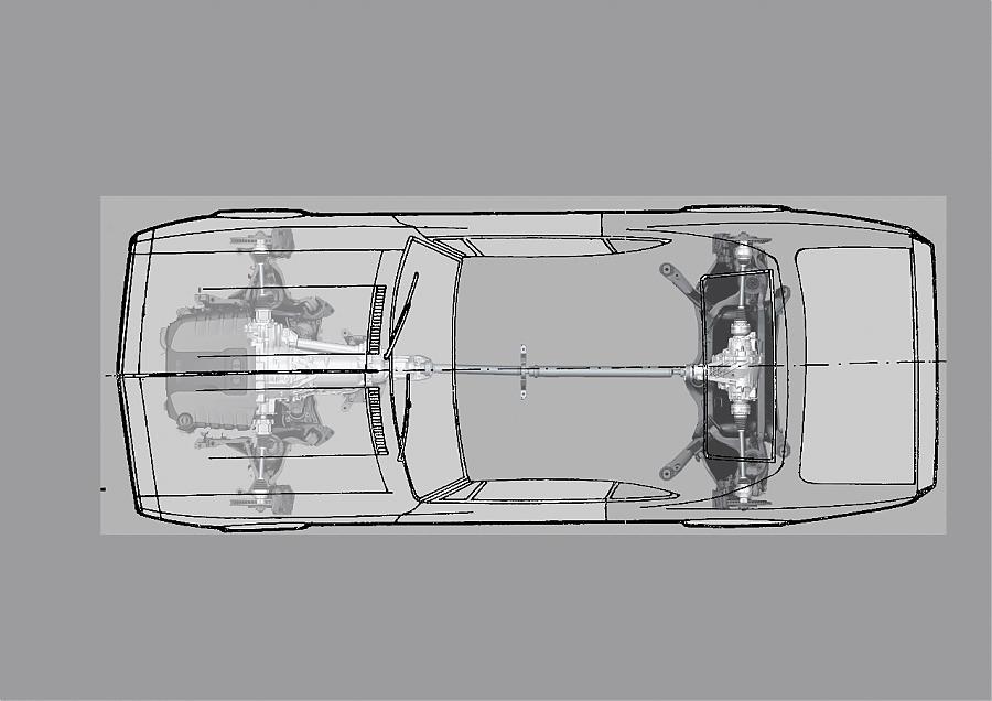

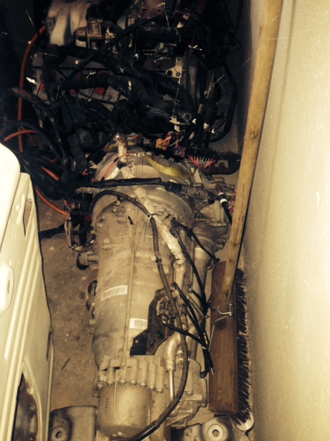

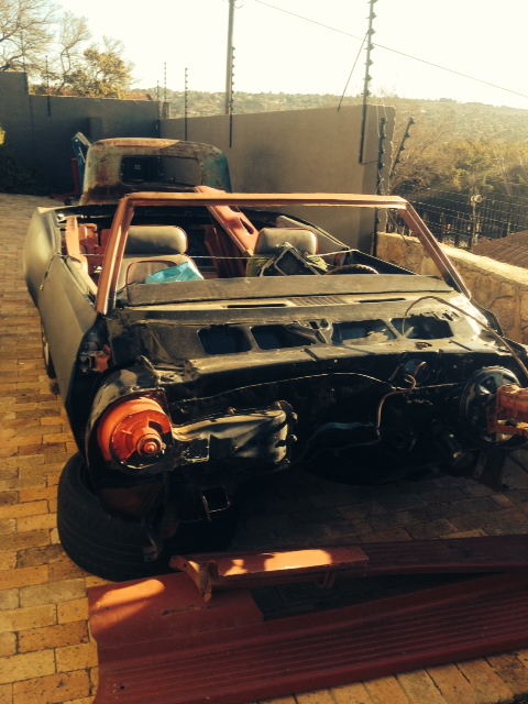

so guys here you go a few pictures of the the components that are going to be used
and then a little overlay image as most people say a post like this is useless without pictures

So to give everyone a little more information
doing research and sitting with Audi South Africa you is prepared to assist me in a large amount of the Audi Components
We have been able to establish some really good metrics
Firstly the 69 Camaro and the S6 have the same track width and wheel-base so that is a real real big Score.
I have lucky with the Audi drivetrain been able to to get both the front and the rear suspension cradles for the Suspension location in relation to the motor transmission etc.
We have confirmed with Audi I have the complete engine and drivetrain management system with the diagnostics ecu and On Screen Display.
Also have the ebrake, ABS, Launch control and Variable Speed Air Suspension.
have the complete steering setup to.
Basically what happened was this Audi S6 was being hauled up from Cape town to Johannesburg and in transit the top deck of the hauler collapsed on the car so I basically bought the entire bottoms section from the salvage yard for $4700.00

Least I have the shell will put her onto the rotisserie flip her sideways and take measurements and then with all this info and info from Audi I will build my own custom frame

I had no idea that the engine in those cars was so far in front of the axle centerline. Am I looking at that correctly? Probably not...
It doesn't appear to me that the cooling units will be able to sit in a normal location for a camaro, because the engine will be so far forward, but that is obviously the least of your problems at this time. I can't wait to see your progress in this build.
