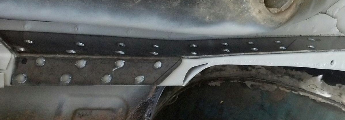

I had to resize and crop the pic.

The other half

Hey JR, thank you for taking the time to resize and post my picture. The first picture JR posted for me is the inside frame rail on the passenger side towards the rear leaf. The second picture is toward the front. In the picture nothing is welded in yet and cut free hand with a plasma cutter. I'm in the processes of the Patent for these frame rail reinforcement plates and I'm going to try to produce them for about the same cost as weld in subframe connectors. They'll be water Jet cut and folded accordingly.

Who did the welding? Are you going finish that weld and close that opening in the original frame? Should a person clean up or grind the are a little better so that it would look finished?

In the pictures posted nothing is welded in. I made a bunch of rosete holes for welding and attaching along with welding along all the seams of the frame reinforcement plates.
Before I welded the frame reinforcements in i completely inspected the frame rails for rust, cleaned the coating/paint off to bare metal. I then sprayed weld thru primer on the factory frame rails and frame reinforcements before they were welded in.
