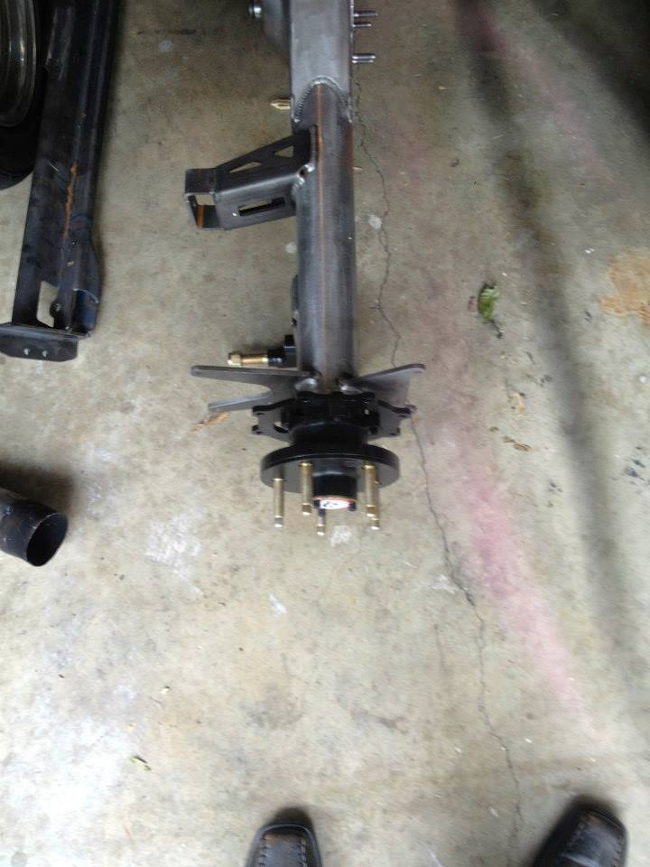

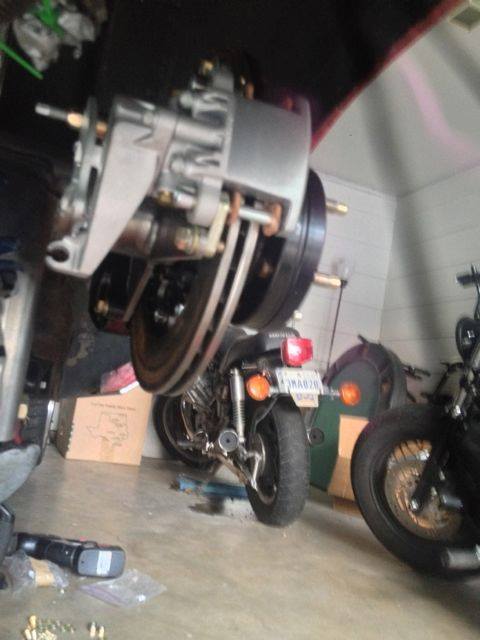

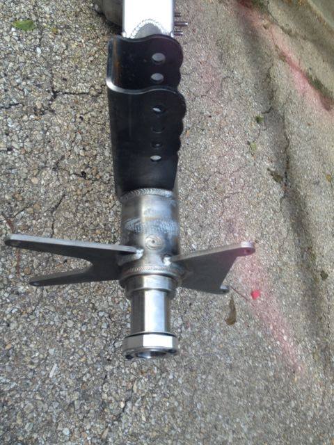

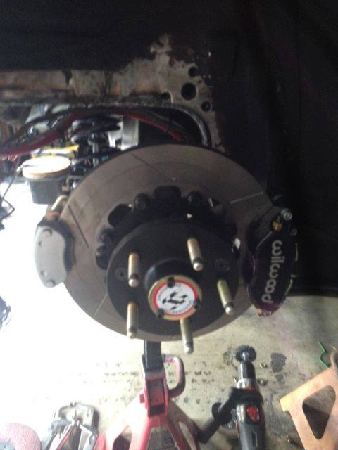

I used the new Wilwood parking brake when I set up my floater last year. I'm running the Wilwood spec 53 12.19 rotor with the Wilwood 4 piston calipers. I think the setup works really well. Speedway set everything up for me and had the brackets made. Overall the price was not bad and I think the replacement cost for the components is fairly reasonable as they wear.
One thing you do need to remember is to add the inner axle seal near the pumpkin. I tired running without one and ended up with gear oil all over my rotors. Not a good thing...
