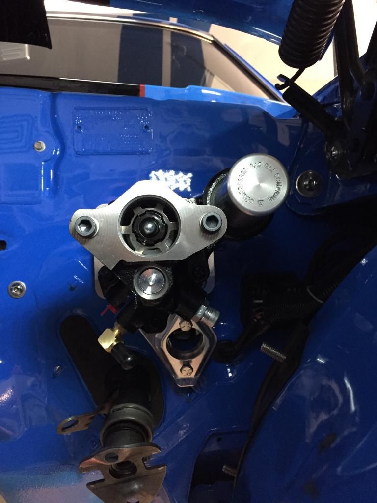

what changes did you have to make to the bracket to use the hydroboost?

Vince ... to answer your question .. perfectly lined up, it couldn't have been easier.
Randy, Vince has this setup dialed in, they absolute bolt together system like it was all one kit

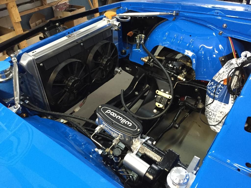

Default LS7 ready
Ready for the new motor ...

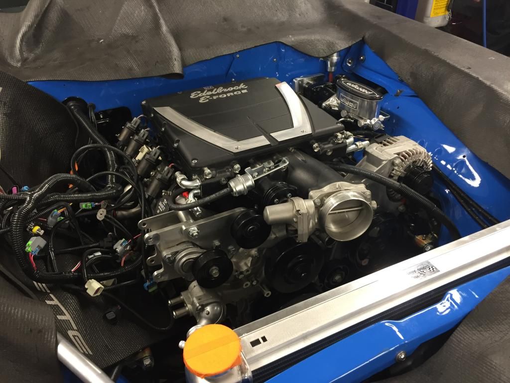

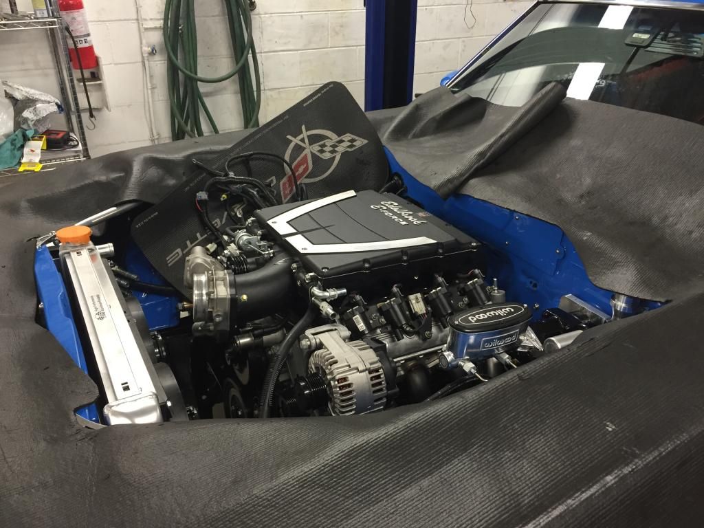

Default Update
Motor is in, and I think its looking pretty sweet !!
OK, so no clearance issues whatsoever ...

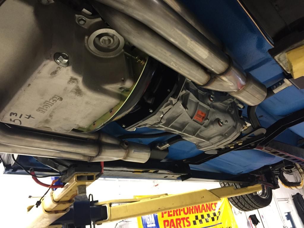

Default Update

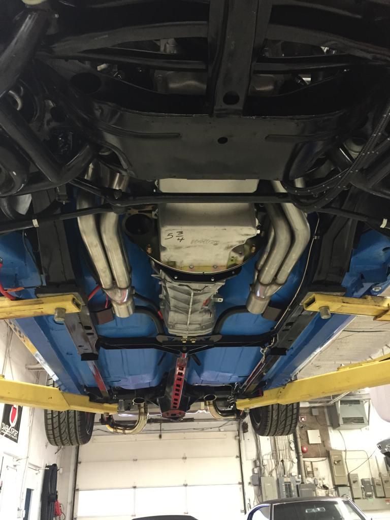

And underneath ... The American Racing headers fit PERFECTLY and the 1st thing i checked was ground clearance .. happily saw they did not hang any lower than the bottom of the frame rails ... Phew !!

Scheck44 what conversion plates did they use to install the motor? I have the same headers on an LSA but its going to be a 4L80. Appreciate any help. Is that a Speed tech cross member ?
Thanks

Hey Wayne, we used the Dirty Dingo sliders with the Speedtech poly mounts on top of OEM style 350 302 engine stands, and yes that is the Speedtech torque-arm rear
