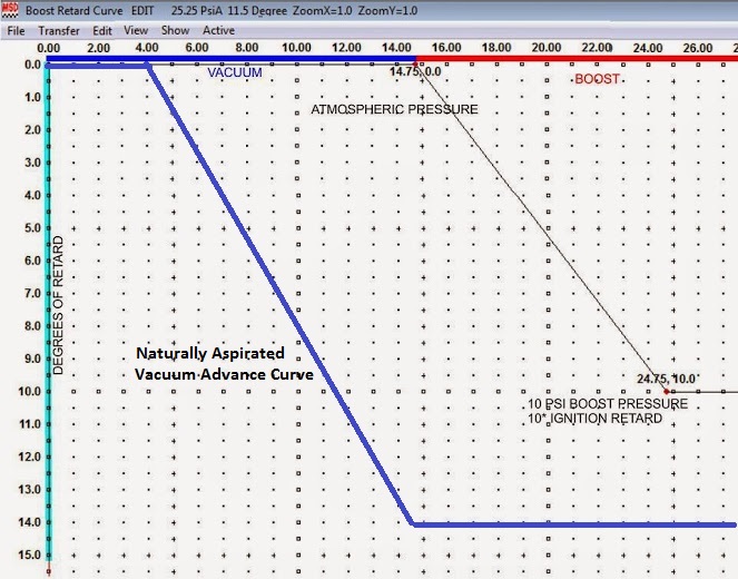

and this graph...
OK... is this your boost retard graph, if so it is currently doing nothing!
This is an "example" curve to dial in 10 degrees of retard progressively with 10 PSI of boost. Your car is naturally aspirated - correct?
The 14.75 point you see on that chart where the red and blue meet is "0" boost -or- "0" vacuum. It is the 14.75" reference point of atmosphere, the same pressure as your outside air.
If you are not running boost, to get 14 degrees of "advance", do the following: From 0 to 5 PSI on that chart set the "degrees of retard" to "0" (same as it is now). Then, from 5 PSI to 14.5 PSI have the chart slope down from "0" to "14" degrees of retard. From 14.5 PSI to the right leave it at "14". After setting this curve, set your timing to your current 7 degrees initial with the vacuum unplugged from the MAP sensor. When you plug in the MAP if the vacuum is 20", it should jump to 21 degrees. If you have a hand vacuum pump you can test this through the range to make sure it does what you think. Anytime you want to disable the advance and go back to your base curve it can be as simple as unplugging the vacuum line from the MAP and capping the manifold port. This will dial in the full 14 degrees "boost retard" and effectively put you bask to your 7 degrees base timing.
I took the example they sent and superimposed the curve I described as a purple line, why MSD does not illustrate this is beyond me. If you like the outcome and want to dial in more, say, up to 20, then instead of going to 14, go down to 20 at the same point and reset your base timing.

Okay, I think this is starting to sink in...thanks...
How my brain looks at this now is 14.75 PSI on the graph is zero vacuum or WOT and at that point there is no advance from the MAP sensor\boost retard curve. When the throttle is closed and vacuum increases, the graph moves to the left and the further it goes to the left the more advance is being added to the distributor. Furthest left is full advance at max vacuum at idle (based on your curve shown anyway).
Last night I drove the car with the laptop and vacuum gauge inside the car so I could watch. At idle and when at high vacuum when running the red line in the Boost Retard graph stays right around 7.00 PSI with the vacuum gauge at 20"
I never saw the red line go less than 7.00 PSI. So should I start the left side of the curve at 7.00 PSI or at 4.00 PSI as in your graph. And the bottom of the curve should level off at 14.75 PSI all of the time right?
The one thing I'm still fuzzy on, the relation of the 20" on vacuum gauge to 7.00 PSI on the graph.

Sometimes I do some of my best thinking in the shower in the morning...
I did some playing around with the curves, please let me know your thoughts on these. I haven't put them in the box yet.
First, my engine likes 7* at idle and 32* total. Actually I think it would like 6* and 33* better, more on that in a minute.
Here is my current Run Retard curve
I don't think I want to add any vacuum advance in at idle, I think I want it to kick in just off idle...so here is my idea for a Boost Retard Curve...
It currently idles at 850 RPM and around 7 PSI
Now...and this is where my brain starts kicking in... Can I use the Boost Retard Curve to pull even more timing out at idle, say instead of the curve being at 14.0 from 6 PSI to 8 PSI, can I put that at 16.0 to pull another 2* of timing out at idle?
This would let me bump my full advance up to 33* and still let it idle at say 6*...
Lance
I would not make sharp transitions like that, it could cause the engine to surge, oscillate between two points or do something funny. Sharp transitions in control systems are never a good idea.
Why the aversion to running so much advance at idle under no load? It may actually let the engine run cooler. As soon as you put a load into it the advance will drop out. People run locked out distributors at full advance on race cars, I don't think your idle speed is going to run away or anything funny. Just try it out and see how it behaves, you can always plug off the vacuum port and disconnect the MAP sensor until you can change it back if it does something you do not like. Disconnecting the MAP sensor will trick it into thinking you have no manifold vacuum and it will pull out all the timing. If you are worried try a smaller amount to begin with, like 7-10 degrees. Just match the amount of advance you put into the initial timing with the amount you take out with the "Boost Retard Curve".
It doesn't matter much if you start at 4" or 7", it just changes the amount of advance a little. Starting at 7" should be fine since that is where your MAP sensor is telling you the engine runs. You can also cheat the end point on the right a little. When you disconnect the vacuum from the MAP does it read 14.75"? I would want the full amount of spark advance pulled out before that point, maybe set it to 14" even to have some margin
The difference between 5" and 7" could be the MAP sensor calibration or your vacuum gauge, either or both could be a little off. 20 sounds like a lot to me for an engine that is not stock, maybe your gauge is a little generous or non-linear. It does not matter much, it is just a reference point, use the MAP sensor since it will be controlling the spark.
