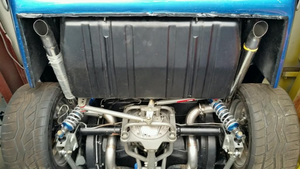

Just one thing to consider before you finalize this plan (from someone who has one). Make a plan for your exhaust routing before you commit. I run dual 3" pipes under the car and all the way out to the back. The Torque Arm prevents you from tucking the pipes into the driveshaft tunnel. For clearance on mine, about 1/2 of the intermediate pipes was re-made from oval tubing to add clearance.
Note that I don't have the BMR setup, but I don't think it will offer a lot more clearance in the tunnel. I also have a Watt's Link which added to the complexity. You will have to deal with some of that with any coilover setup as compared to the original leafs though...
This said, I like my Torque Arm setup. It just adds to the complexity of exhaust routing and ever having to remove the driveshaft...

I have the JRS Apex torque arm setup. Eric did some work on the front mount to allow it to do double duty as my transmission mount also. This TA is a heavy sucker, and the Watt's Link creates some nice challenges for exhaust routing. Here is one example: you can see most of the welds in this one tube, although I think there are 2 others behind the axle (at least 1 for sure).

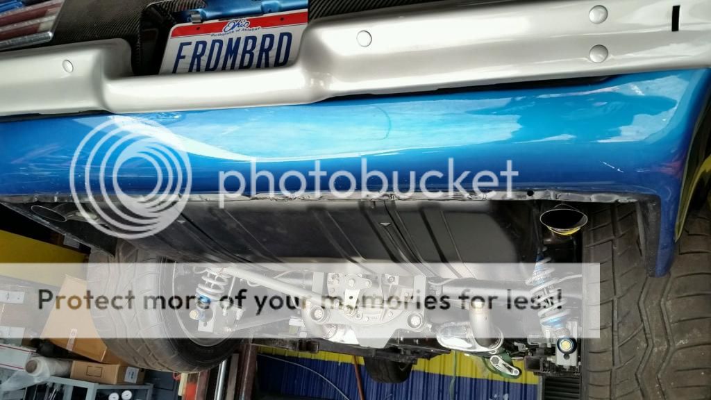

I have BMRs Torque Arm on my car with 3" exhaust out the back...
I also have BMR's upper and lowers as well as their sway bar up front.
