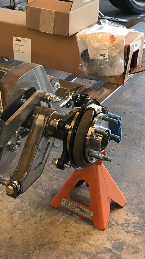

Old 04-16-2015, 12:57 PM
efs69's Avatar
efs69 efs69 is offline
Join Date: Apr 2012
Posts: 253
Jay,
Here are some pictures of my Moser set up. It does have the inner seal as well. Hope these shots help.
