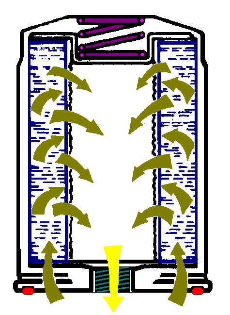

An oil filter works by "filtering" the oil through the filter. Oil enters the filter under pressure through the holes on the perimeter. It is forced through the element and exits through the big hole in the middle. Here is a pic that show the route....

Theoretically.. however most cheap filters trigger the bypass before the pressure is enough to force it through the paper.
Also, at WOT and high RPM's (when your oil pressure is high) the bypass is full open and the oil travels the path of least resistance which is NOT through the high resistance paper.
So, when you are racing your oil is nearly unfiltered..

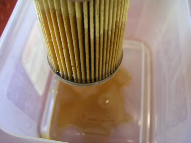

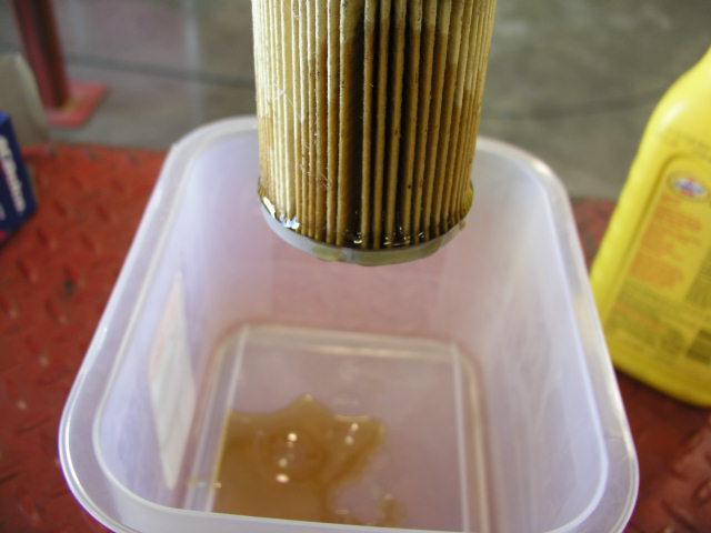

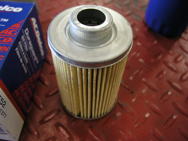

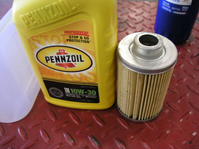

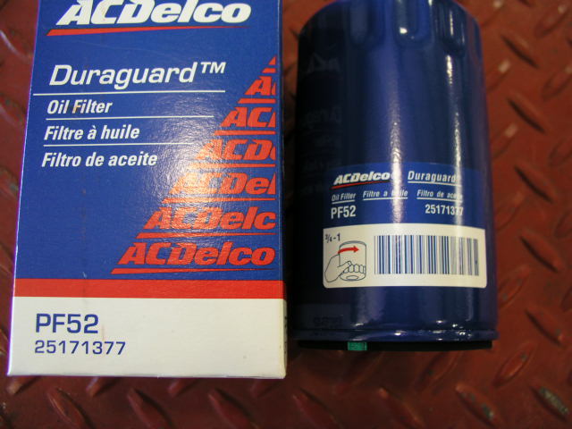

This whole subject is so outrageous I went and bought a oil filter to prove it. Here is a new AC delco PF 52. I cut it out of it's housing with a oil filter cutter. I can breath thru it with no problem. I poured oil in the center and before I could even fill it up the oil was running out thru the paper !!!!!!!!. Steve...Go duplicate what I just did !!! The factories have been using this system for 50 years because it works ! It takes no pressure for oil to pass thru the paper.
