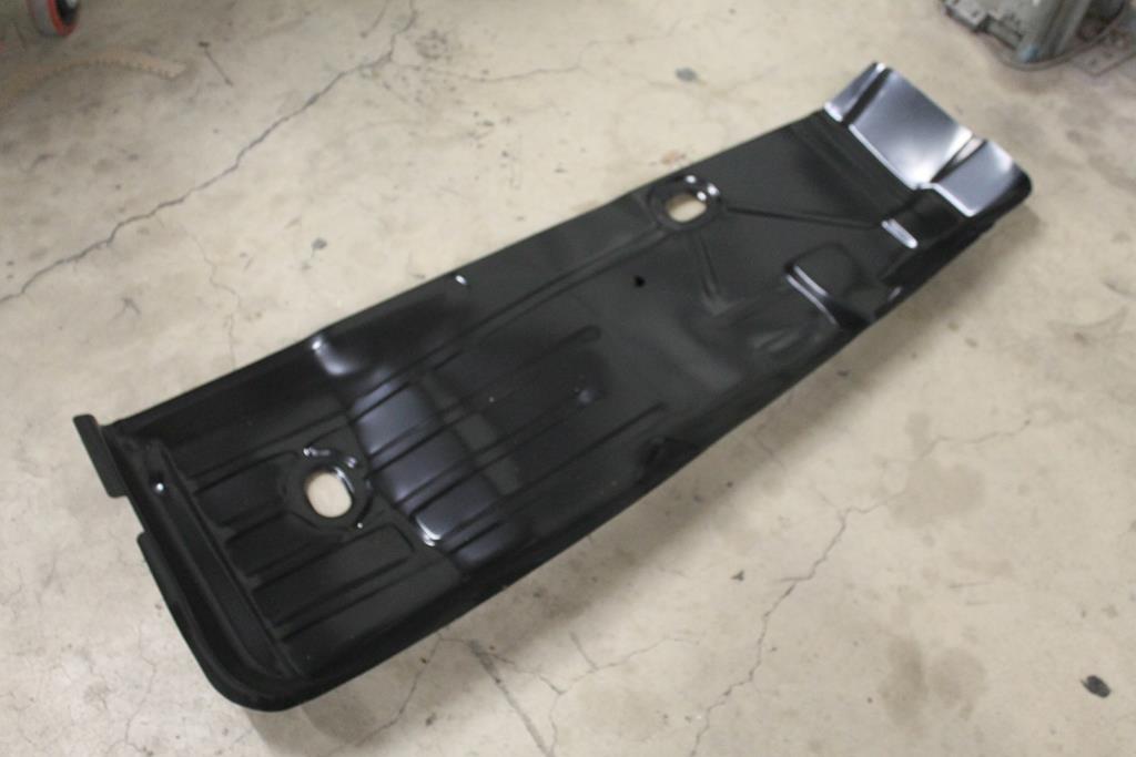

Replacement panels
Originally Posted by
Che70velle
You guys have been busy! What brand of Sheetmetal will you guys install on this car? Can't wait to see more...
We are using
http://www.autometaldirect.com/
panels

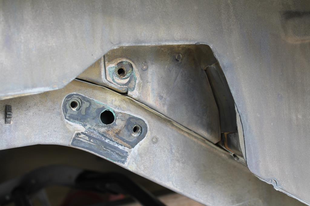

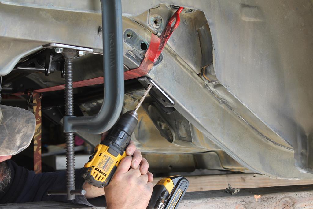

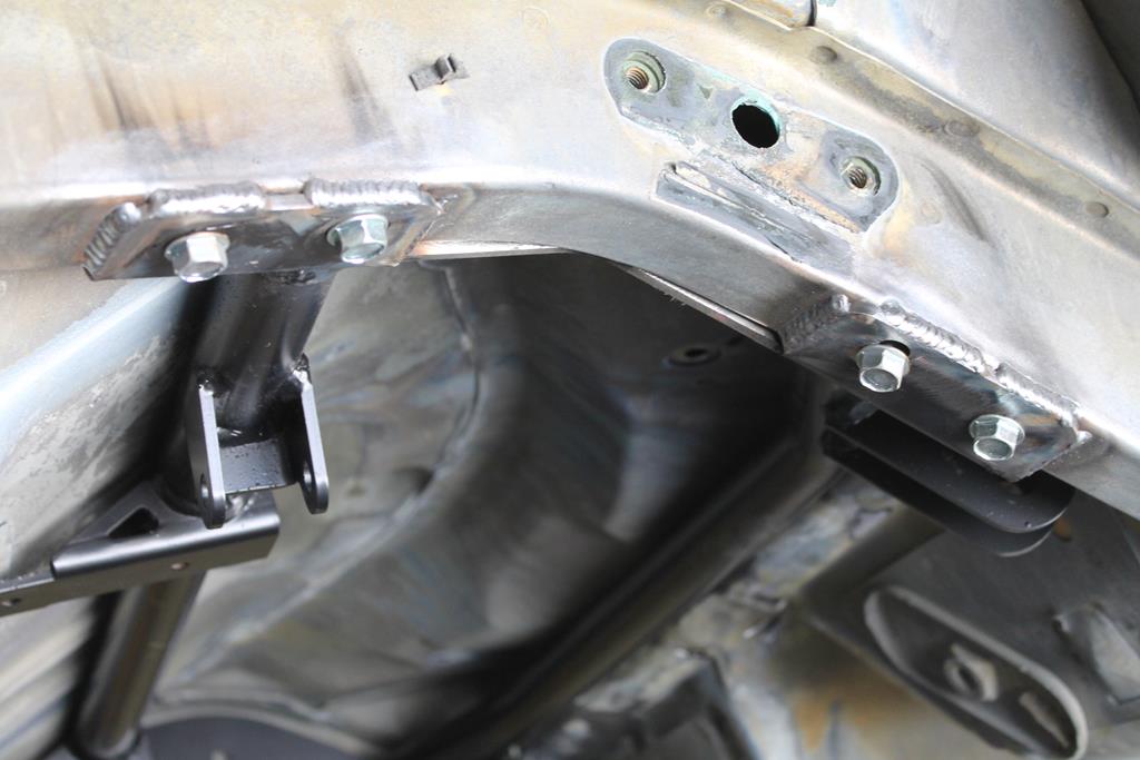

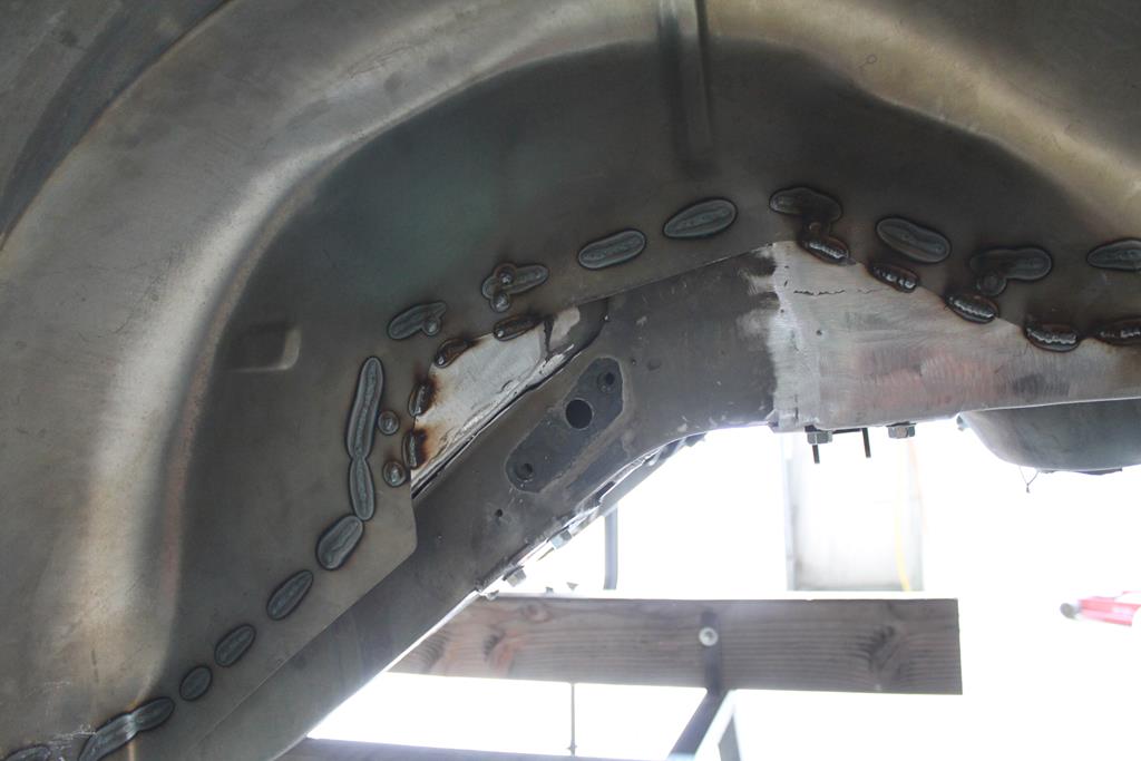

Installing the Ridetech "Bolt-On-4-Link"
We opted to both bolt, and weld in our mount pts for our Ridetech 4 link kit.

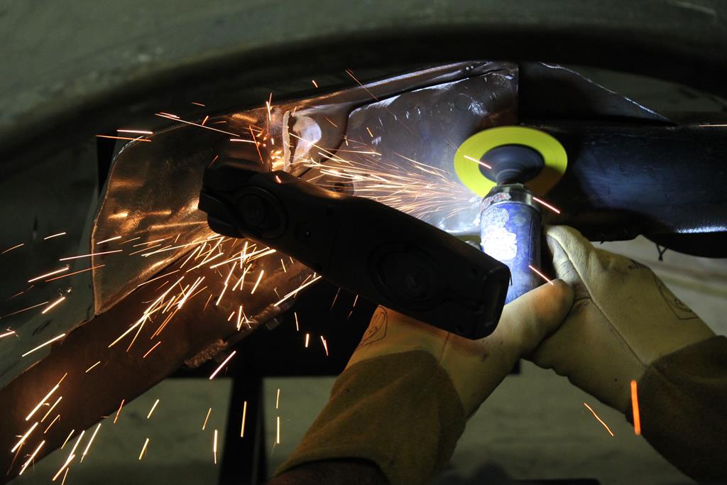

Mini-tub install
Here we are installing the drivers side mini-tub allowing for a nice size rear tire within the wheel well.

The four link cradle is looking good. I bolted my cradle in and had Dan Holohan weld it in. After putting it in and bolting it down I just felt better getting it welded. Car is coming along nicely.

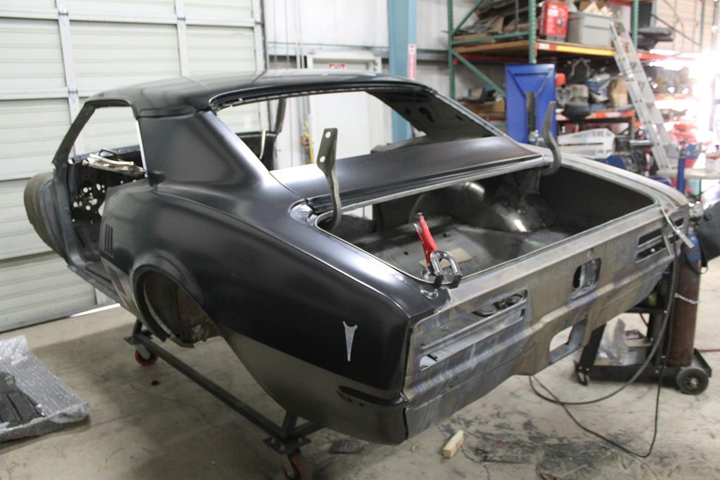

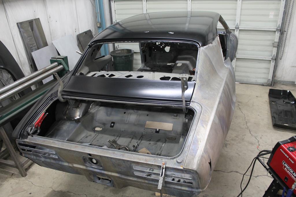

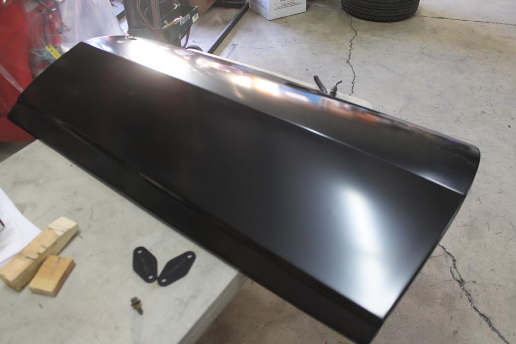

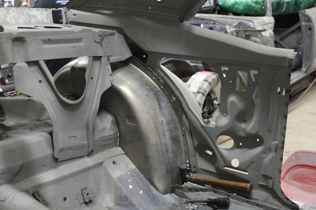

Sheet metal mock up
Now it's time to start putting some sheet metal back on this naked bird...here we are mocking up the replacement pieces.
