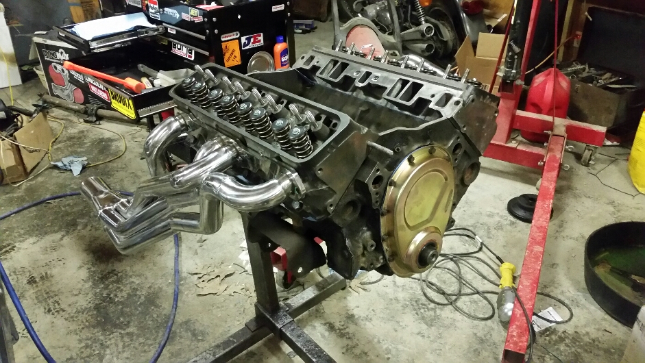

Built a 305 small block with Lunati .471/.480 cam, 350 heads, 350 tbi, Texas Speed LT1 headers, Jet performance chip, and some Borland mufflers
