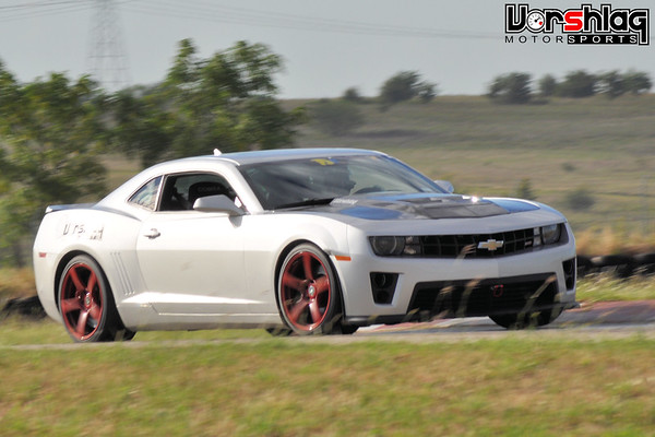

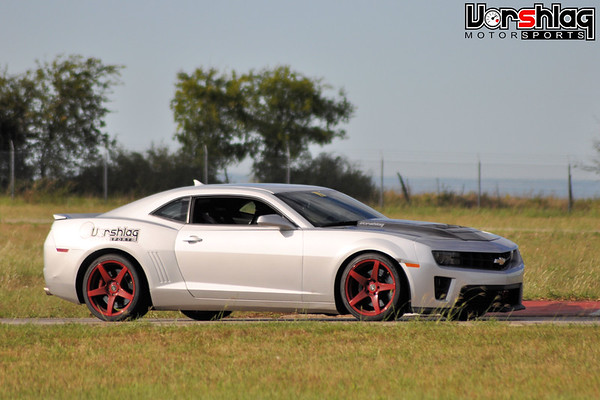

TRACK TEST - MSR-CRESSON, SEPTEMBER 16, 2016
If you have been waiting through this MASSIVE write-up for some road course testing, its finally time! I have driven the MSR-Cresson 1.7 mile CCW course dozens of times over the past decade but starting in July, I have been there almost every week testing several cars in various states of tune.

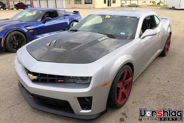

On this beautiful Friday morning in September we had both Joe's 2013 1LE and his newly acquired 2017 Corvette Grand Sport 7-speed manual on hand for some test laps. Joe asked me to trailer out the Camaro while he drove out in the GS, and I was slated to take some "baseline" laps in both cars. I also ended up driving a customer's stock C6 Z06 the same day. Good references to compare the Camaro to, but I was worried the 1LE would be far out matched by these two generations of Corvettes. I was pleasantly surprised at the results.
This was only the 2nd time Joe drove the Camaro on track after the gaggle of changes we made in 2016, but it was my first time to ever put any miles on a road course in any 5th gen Camaro. Or any C6 or C7 for that matter. What should I be worried about? They are just cars, right? If it has a V8 under hood and drives the rear wheels, I'm down for whatever!
We got there early on a member day and the weather was good. I managed to get out on course in the Camaro when the course was devoid of traffic - Joe was in his GS and I was in the Camaro, without another soul on track. This made for some easy laps where I clocked off some quick ones.
Car handled beautifully on track. The setup that had a touch of understeer in autocross was perfect for road course use. I was able to put the car to about 90-95% of the limit and get a good lap time in it safely. The racing seats and harnesses made driving effortless and I wasn't having to "hang on" like I did in the C6 Z06 (which frankly had terrible stock seats).

The Camaro's stock brakes (with cooling, good pads, and proper fluid) were absolutely infallible - watch the g-traces and you can see how I abused them (1.1-1.2g stops on every corner, every lap) and yet never had a hint of fade. The Hankook tires worked great, generating 1.3g lateral in some places, mostly 1.1-1.2g. Joe drove the GS twice and the Camaro once at MSR that day - and was quicker in the 1LE! We both felt it was easier to drive fast. Of course the $76K Grand Sport was GLORIOUS in its own right.

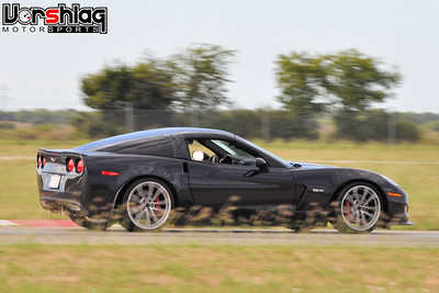

The C6 Z06 was the slowest of the 3 cars I drove that day, which was the biggest surprise. It was rolling around like a wet noodle and the seats were terrible. Both the C7 Grand Sport and C6 Z06 were on very fresh 285F/335R MPSS tires. Nobody running with us there that day could believe the Camaro's times until they saw it and timed the laps themselves. Amazing lap time for a 3800 pound with some tweaks and bolt-ons. This is a beautiful car to drive on the street, other than a little brake pad noise.
