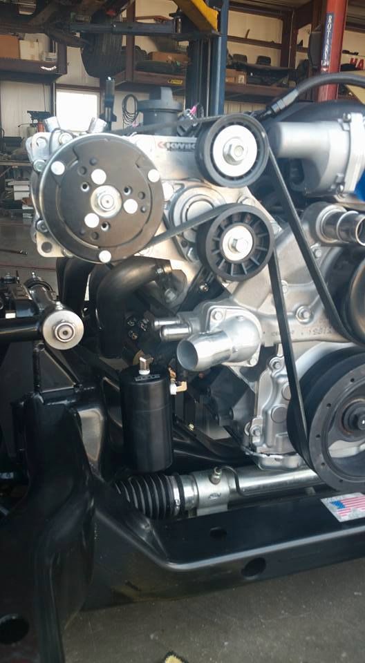

That is what i used to then run to my oil catch can. Here is my setup
Nice set up, added to my "to do" list.
