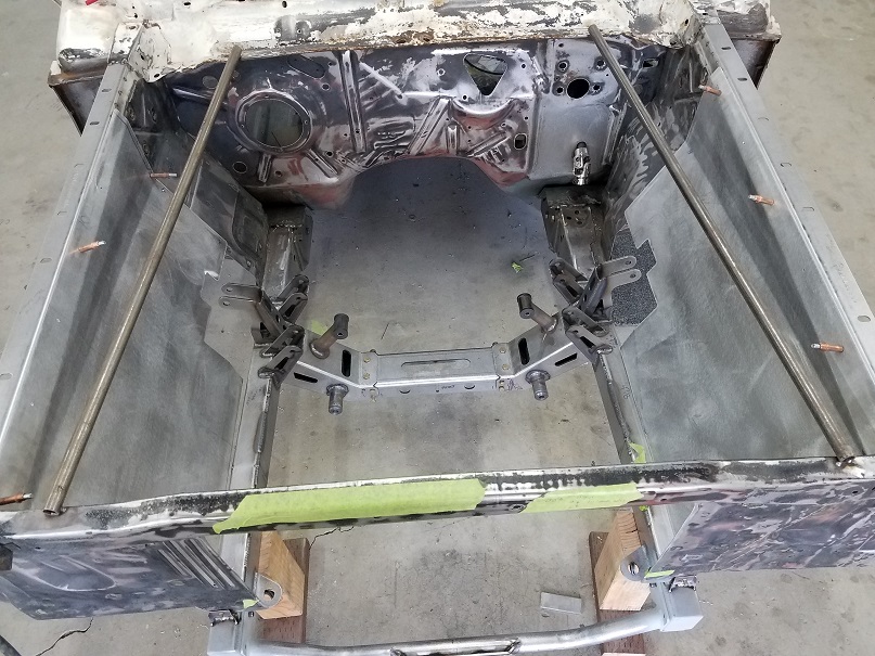

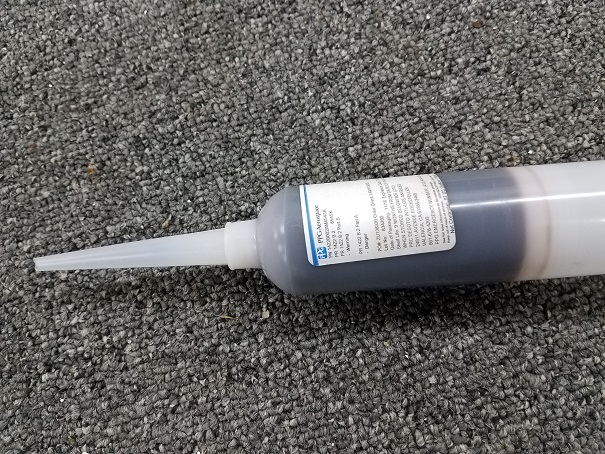

Seam sealed the interior last week. For anyone looking for the BEST seam sealer, there is a picture of it below. Made by PPG and is called Semkit. It is aircraft fuel tank sealant. 2 parts that mix together in the tube then is dispensed with a caulking gun (pneumatic gun usually). It works excellent, nothing will touch it (acetone, lacquer thinner, gas, diesel, MEK, nothing...) and will stay flexible forever. It bonds extremely well and can be used as an adhesive to some degree. I remove this stuff from military equipment that was in Vietnam, and it is still just as good as the day it was applied. It is expensive, but check ebay for good deals...outdated stuff works just fine for our needs.

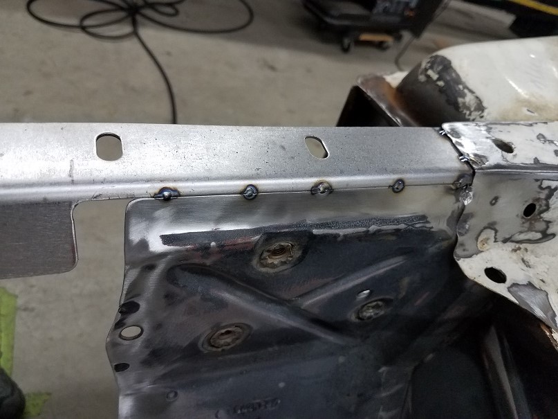

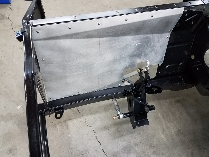

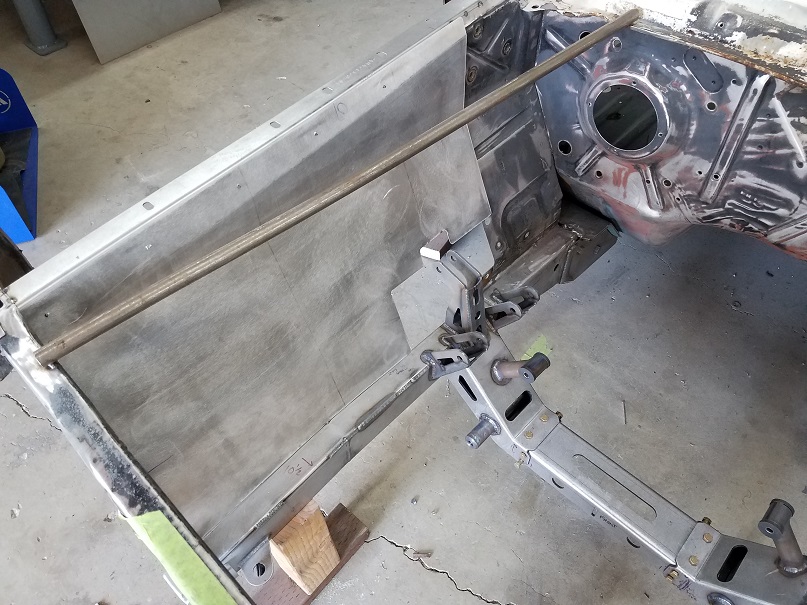

I also was able to get the inner fender panels made up. I made the steel parts to graft into the stock sheetmetal, punched the obround holes in the factory locations, and even put the VIN number in the original OE locations. From there, I made aluminum panels that span from the upper pieces down to the frame rails. Definitely cleans stuff up nicely. I dont think I will paint them as of now...

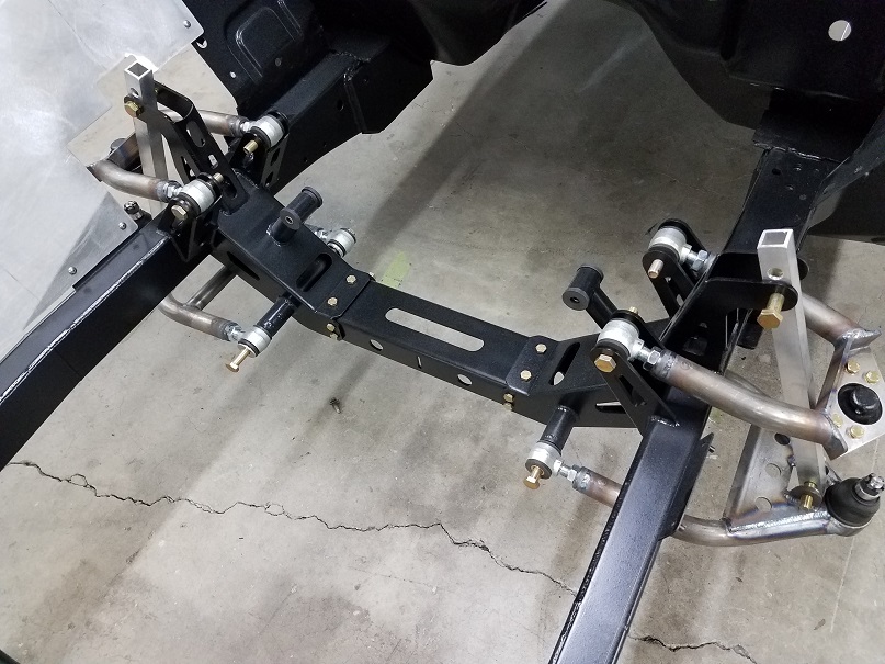

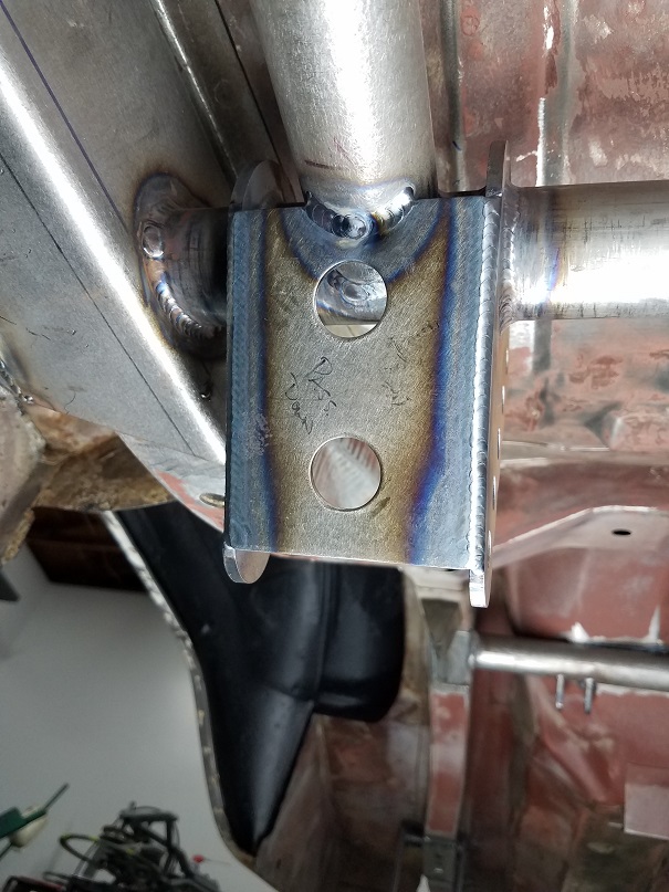

I also added a gusset to the front of the front leaf spring mounts, tying the 2 individual brackets together as one. It looks more complete and helps to keep everything together.

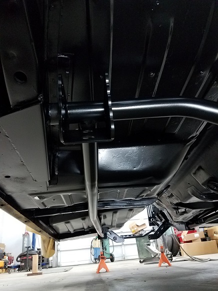

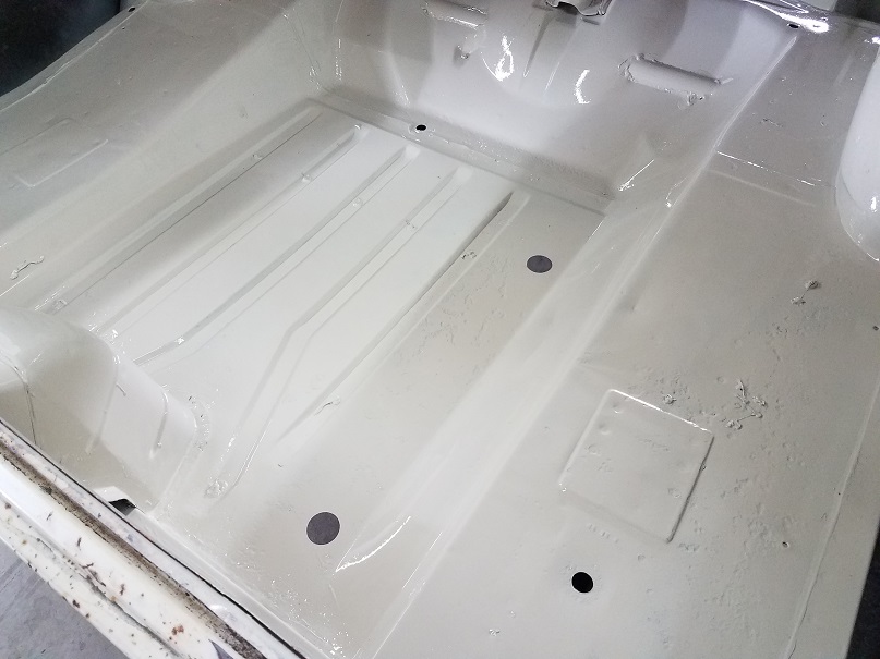

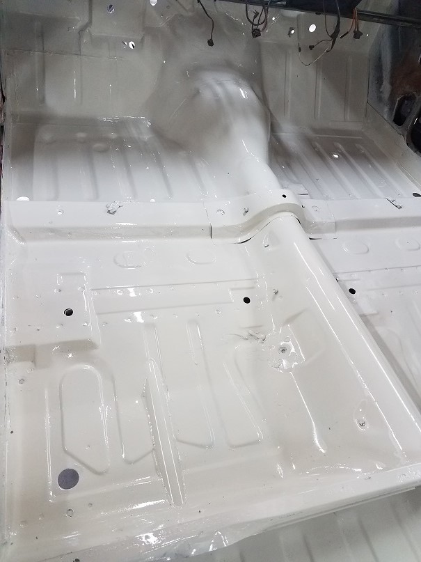

I have been busy with the car, but havnt had much time for pictures or posting here. Here are a few shots. The idea was to get the underside painted, engine bay painted, and interior floors all painted. From there, I will remount everything, making the car a roller. At that point I can advertise it as a roller needing paint, wiring, plumbing, and some odds and ends.

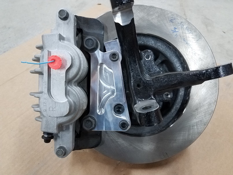

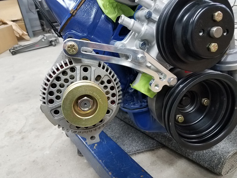

I was able to get some billet pieces finalized as well. The front disc brake brackets as well as the alternator mount. This is a new 3G alternator and an old style water pump with the outlet on the passenger side. I couldnt find anyone who made a mount for this setup, so I made my own. There is a adjustable turnbuckle with heim joints that goes to the lower alternator hole, and the threaded hole in the bracket.
I also went ahead and made up some aluminum inner fender panels for the car. I dont blame on painting them as they are removable, and I figured it may be a spot for the next person to add a little of their own touch via paint color, anodize, polish, etc.

Nice work. What kind of fasteners are you using for the inner fenders?
  #20
Old 03-02-2017, 11:38 AM
curleysracecars curleysracecars is offline
Join Date: Mar 2012
Location: Granite Bay, CA
Posts: 28
Those are stainless panhead machine screws. They are threaded into aerospace rivnuts which are locked into the panels behind the aluminum panels.
