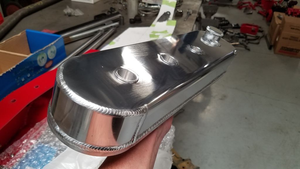

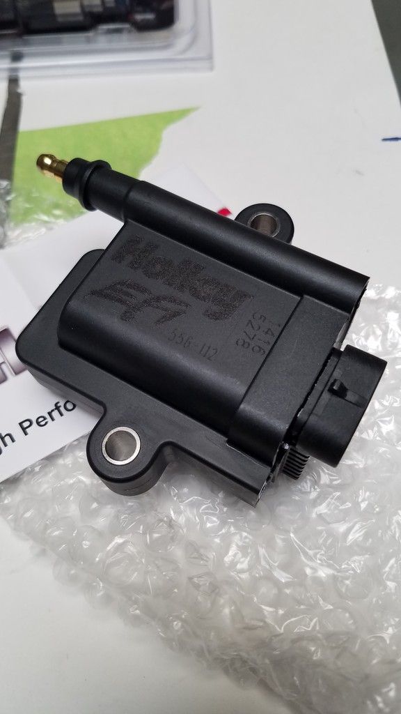

I've got some ideas for a coil mount that involves the valley cover. The intake manifold hasn't arrived yet so that'll have to wait.
Coil harness adapter for a factory type engine harness

The Holley Hi-Ram is in our possession now so we can actually do some mock up with the coils. There is plenty room to mount them underneath it. We just want to make sure that they are serviceable somewhat easily. Probably make a one piece removable shaft so they come out as a unit.

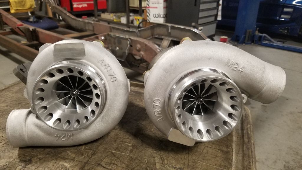

So the thing about boost. It's just a measurement of restriction. Less restriction, more flow at a given pressure. On a naturally aspirated LQ4 these 230cc AFR heads would be overkill. I've already said too much. Those that know me, know the direction this is headed.

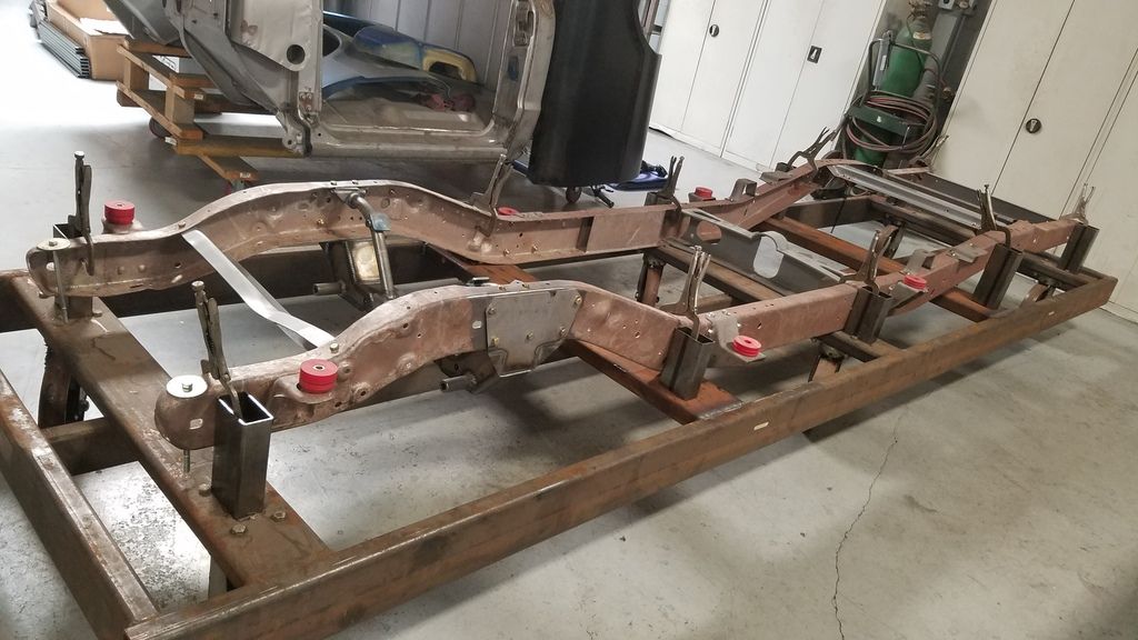

We finally got the frame rails back from sandblasting. Well......they only baked it apparently. Anyways, waited this long so we are moving on.
One of the guys in the shop mentioned that we had a chassis dolly in storage. He thought it was sturdy enough to build a temporary fixture out of so we took a few guys down there and grabbed it. Sure enough, this thing is a monster and honestly I am kinda glad that it is short. This way I can place the cab and bed on it if need be. Will come in handy with doing a body drop.
I had to install a CPP driveshaft loop because the stock one would interfere with the chassis dolly.

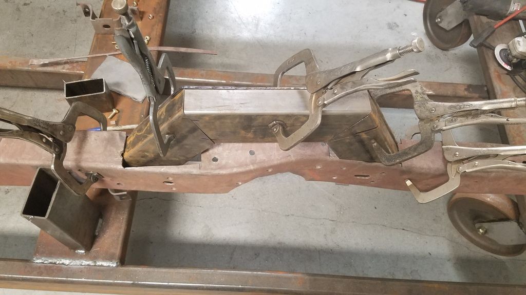

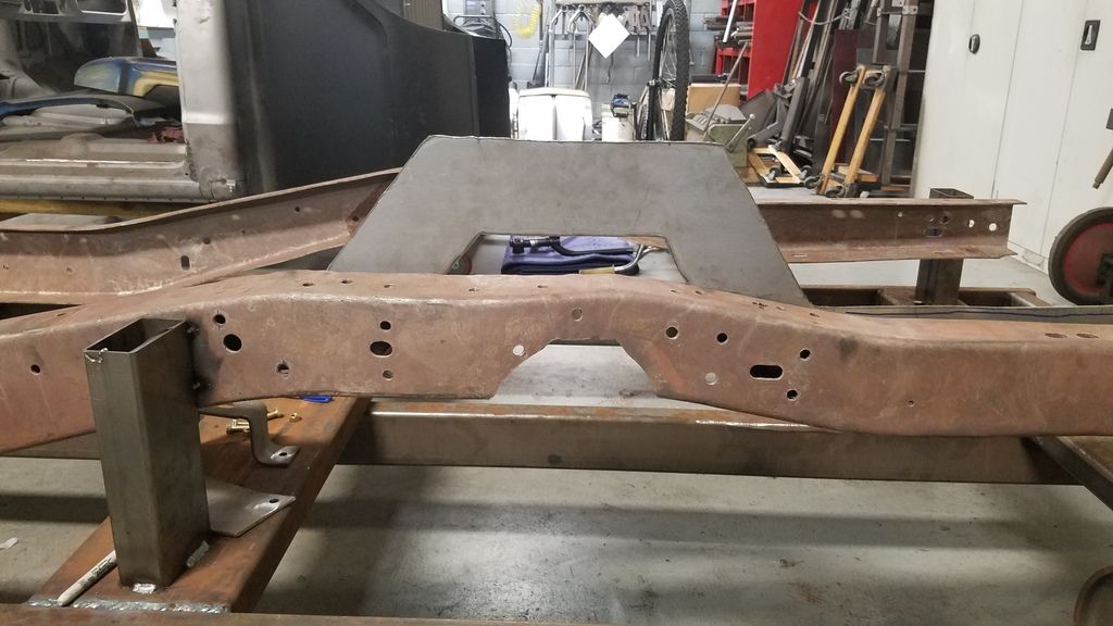

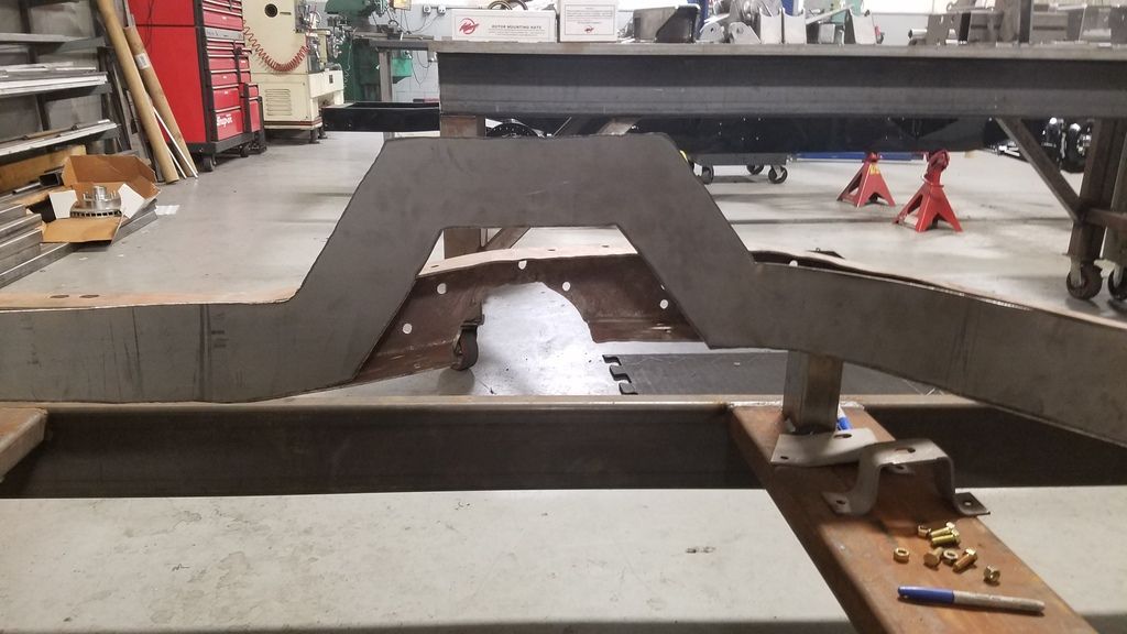

I am finally back in town so it's time to make some real progress. I spent my lunch today tracing and cutting one of the rear boxing plates. It's sucks that I had to cut it with the hand held plasma vs. the hi-def but I can't wait for R&D to draw the plate(they're super busy finishing up the squarebody 4-Link).
So basically what we have done is give the rear suspension an extra 3.5" of travel. The bottomed out height before is where the new set up will be at ride height. I left the rail height at 6" at the step so there is plenty of strength for towing.

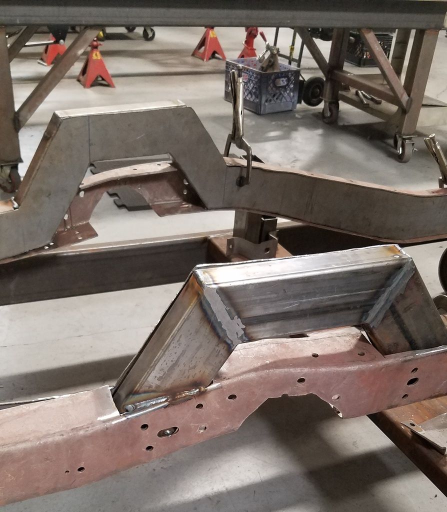

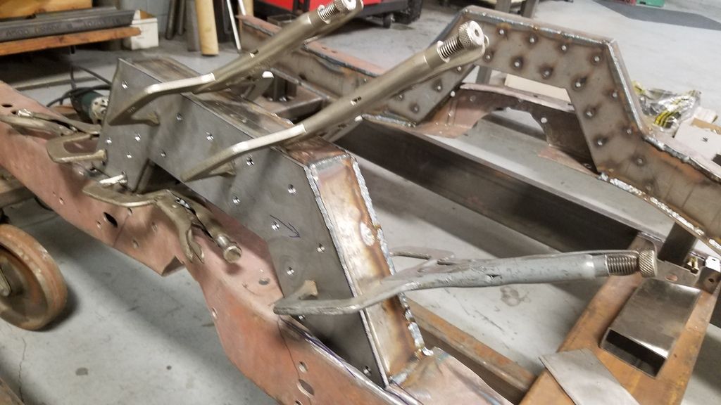

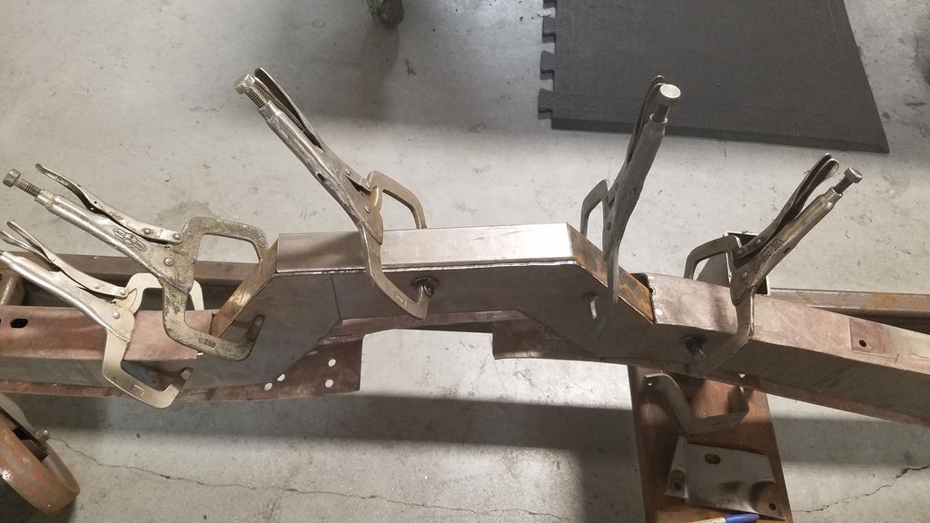

Making progress on the stepped rails. Just a lot of mocking up, grinding, cutting. welding and not necessarily in that order.
Dimensionally I am pretty happy with the outcome. Side to side height is perfect and front to back placement are within 1/32". I am off .25 degree of vertical on the driver side(should have cross braced it before the heat). I've still got work to do on it cosmetically though.
I am going to lay another panel on the outside here that butts up against the top of the stock frame.
Still need to drill a few holes for Rosettes.

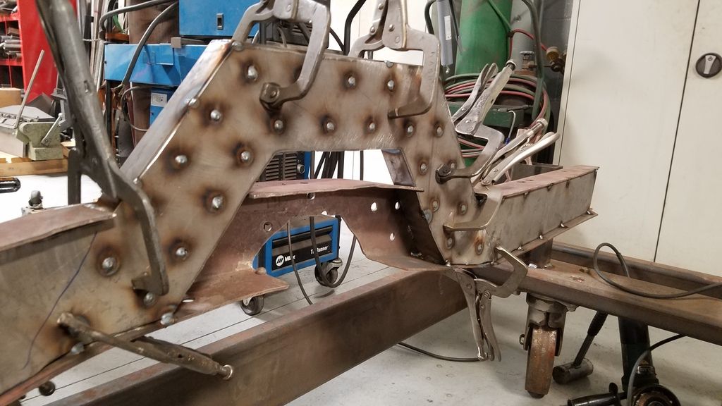

Braced the top of the step and cut the stock frame piece out.
Got some cool(errr hot) parts ordered this week. :mm: No picture tease yet but parts are on the way. Getting real close to engine/tranny mock up.
The frame is absolutely ugly right now but the fitment is pretty darn good. Had to section the top and bottom(note the cut) in order to pull the outer wall of the frame into the step. Still have to clean it up before laying down a bead.
I wanted to add a little extra bracing inside the frame rail where the front shock mounts. Main reason is our engine mounts triangulate the frame and the crossmember but I am setting the engine back. It's just a piece of 1x2.120w tubing
Started working on the front boxing plates. I cut the driver side with the handheld plasma like I did the rears. Once it fit I used that as the tamplate for the passenger side. There will be a filler plate added to the top of the rail to close the gap.

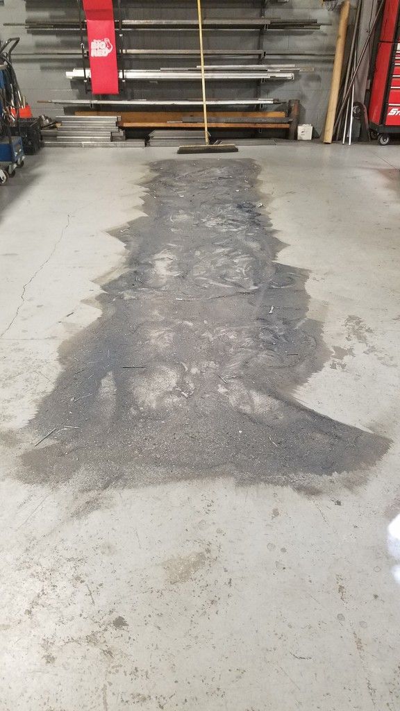

Not a whole lot to report the last two weeks. Spent roughly 20 hours grinding all the excess pieces of frame/weld.
12.5 lbs worth
