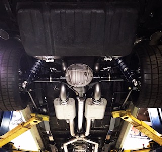

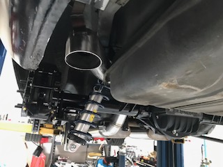

Here's a 69 we did a few years back, this one is obviously minitubbed but you see we went under the axle.
-Dale

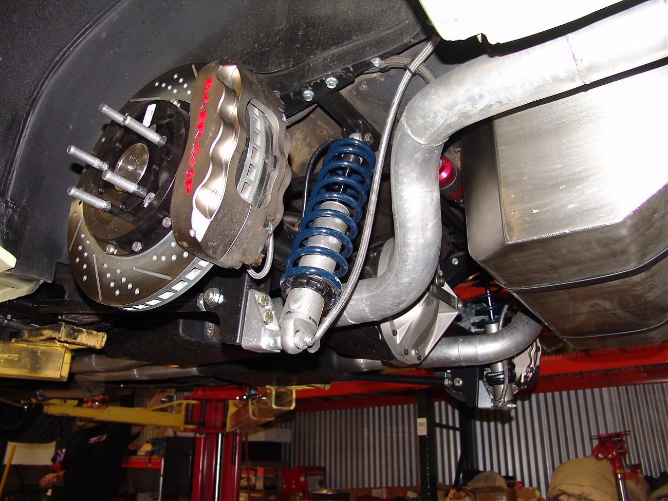

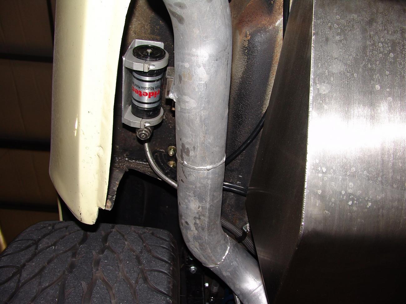

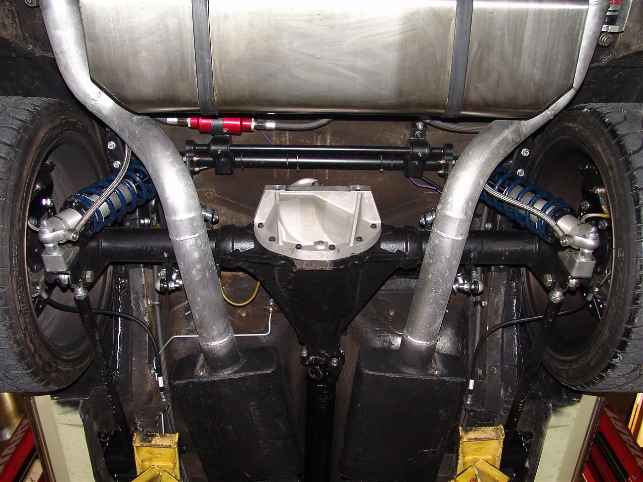

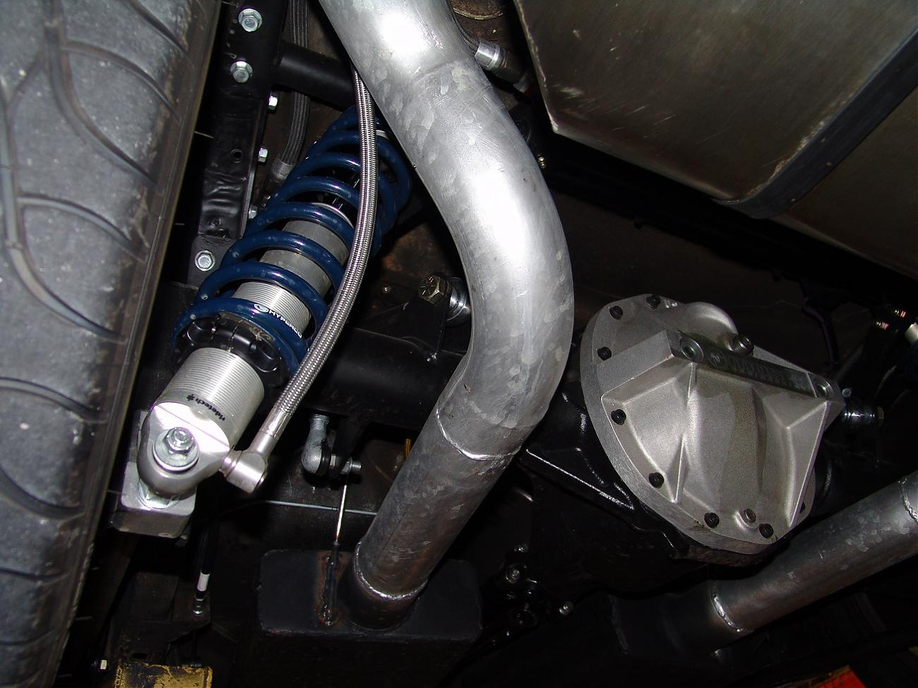

Glad to hear that Dale got you taken care of! Bret may have some other pictures that he might want to throw up here when he gets back but I thought I'd add the pictures that I had to the thread for you. These were back when the 48 Hour Camaro was first finished:

My exhaust dumps in front of my Strange 9", but would like to extend it out a further. When my car is up on my 2-post lift, the rear droops all the way down to the point where the springs are unloaded and the rear appears to be hanging on the shocks, four-link, etc. If my exhaust went under my rear, the rear would be sitting on the tail pipes when I jacked the car up by the frame. How do I prevent this or what am I doing wrong?

Put the tail pipes up and over the rear end?
IMO tail pipes under the rear are just ugly and are a copout. I have done it once in my car building career when i was 20 that was on a Prostreet 85 Mustang with a 4 link and 33 x 21.5 Mt tires on it.
