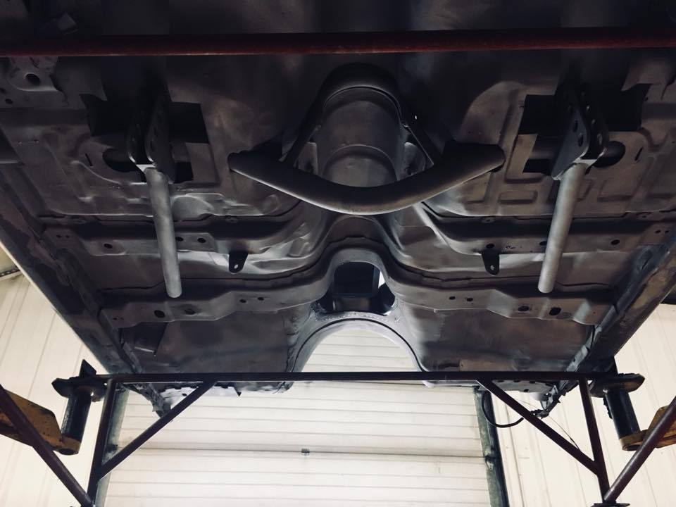

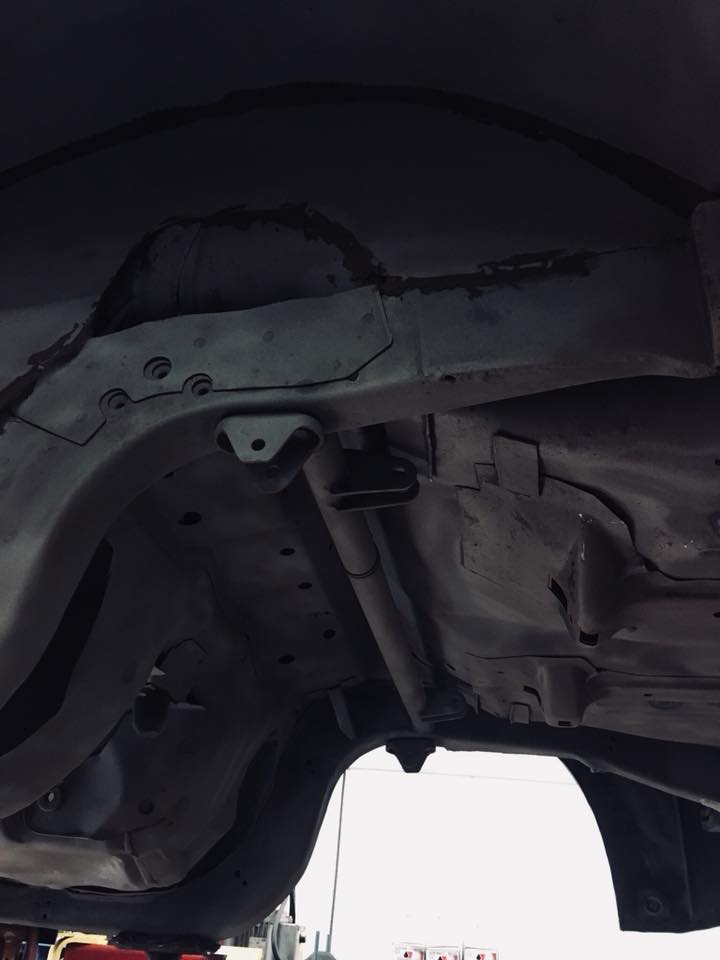

Took a few photos of the undercarriage after media blast round 2. I still have to tighten up a few areas with some extra welding prior to laying more seam-sealer / dropping it off for paint. Here are a few photos of that.

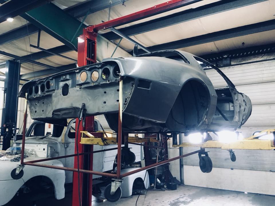

2/2: Update
Back from paint. Solid body mounts, sub frame, sub frame connectors, and rear suspension all installed. Wrapping up a few loose ends and then she goes back in to hibernation while my funds build back up.
