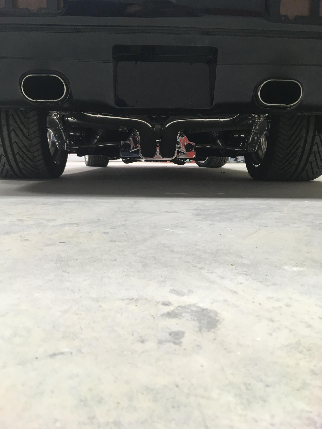

It is not difficult to run the exhaust pipes under the pumpkin of an IRS. This is my '67 Camaro.
That is a SWEET setup! But it is more involved (expensive) than I want to put in the truck at this time. But I certainly will keep this type of routing in mind if I take this thing to another level...
