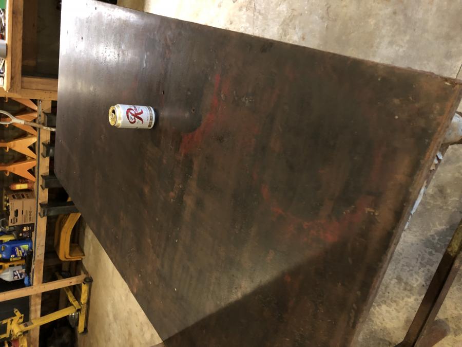

A buddies CL score. After cleaning the top with a wire wheel and flapper disc it’s ready to do work. It’s as heavy as it looks and doesn’t move.
