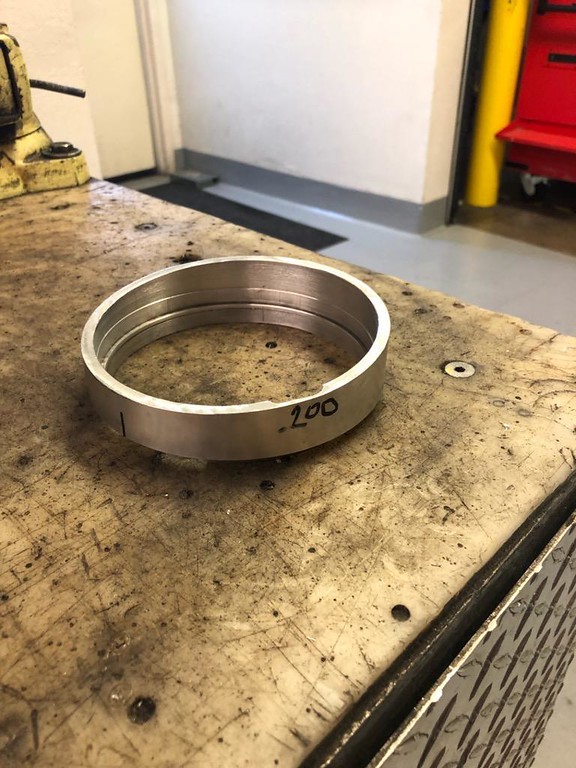

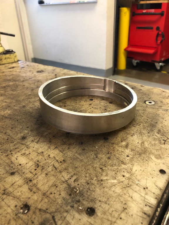

So one of the things I had to deal with on my EFI swap was the air cleaner tilt angle also. The Dual plane intake was tilted so the carb sat level and the single plane intake was not.
I already had a custom spacer to raise my cowl induction air cleaner up to seal against my hood but had to take about 0.600" off of the front of it and 0.200" off of the rear of it to set my air cleaner back against the hood.
I also had to bend about a 3 degree angle into the air cleaner stud so it lined up with the hole in top once again.
That doesn't fix the off to the one side issue but for front to back it worked like a champ.

Originally Posted by carbuff View Post
Lance,
Did you use a mill to cut that angle? I've contemplated doing something similar, but as you said, it doesn't solve all of my problem...
Yes, a friend chucked it up on a mill he has access too and shaved it down. Its funky looking for sure but solved the issue perfectly.
