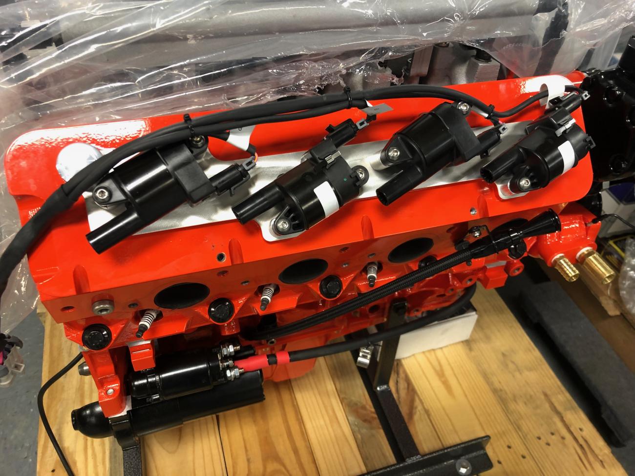

Originally Posted by CarlC View Post
The MH part, like the Provent 200, is meant to be used in-line with a PCV valve. Basically...
Drivers valve cover -- PCV--MH-- throttle body vacuum source.
Vacuum is needed for the drainback valve to actuate.
Just looking at the Godfathers last post and didn't see mention of a PCV in the system?
  #16
Old 01-16-2020, 09:49 AM
Whitepark Whitepark is offline
Join Date: Jan 2020
Posts: 10
I'm still working on location of the PCV. A traditional PCV in the valve cover is problematic because the (fake) valve covers are closed and non functioning - they sit on top of this spacer on the cylinder heads that mounts the coils, and do not offer direct access to engine breathing.
