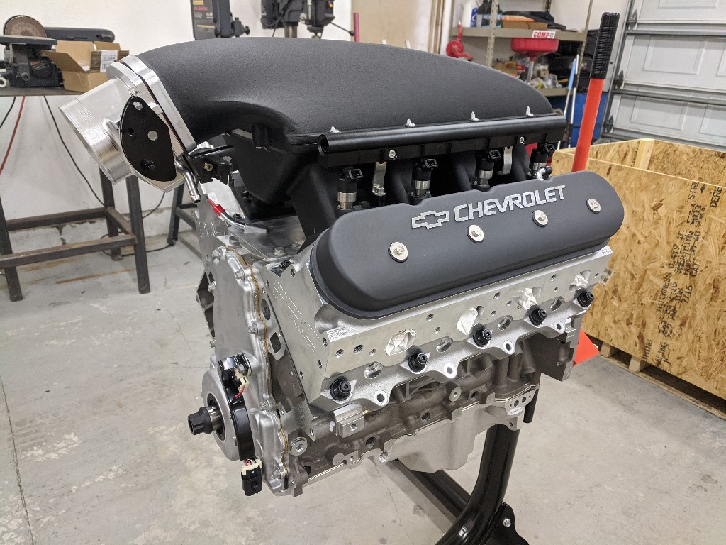

Working on getting some pics of the tear down. The engine from Texas Speed showed up yesterday, and I had to mock up a couple pieces to get an idea of what it was going to look like.
You're pics are the perfect size btw!

Looking forward to this build Jody. Been following your builds for years haha.
The 427 matched with the 7675 is going to be a light switch. Instant spool. We did one on a 5.3 and its a riot on 20psi.
Hope you're right because that's the plan.

Intake looks tall Jody... do you foresee any hood clearance issues?
I was just thinking the same thing....

Oh boy, do I know the feeling!! Please don't mention hood clearance issues. It's been a nightmare for me.
We'll find out, the pic makes it look taller than it is. Should clear with a cowl hood, but may require inner structure trimming or an aftermarket hood that doesn't have any. If I can't make it fit I'll sell it and go another way.

Why not DBW?
