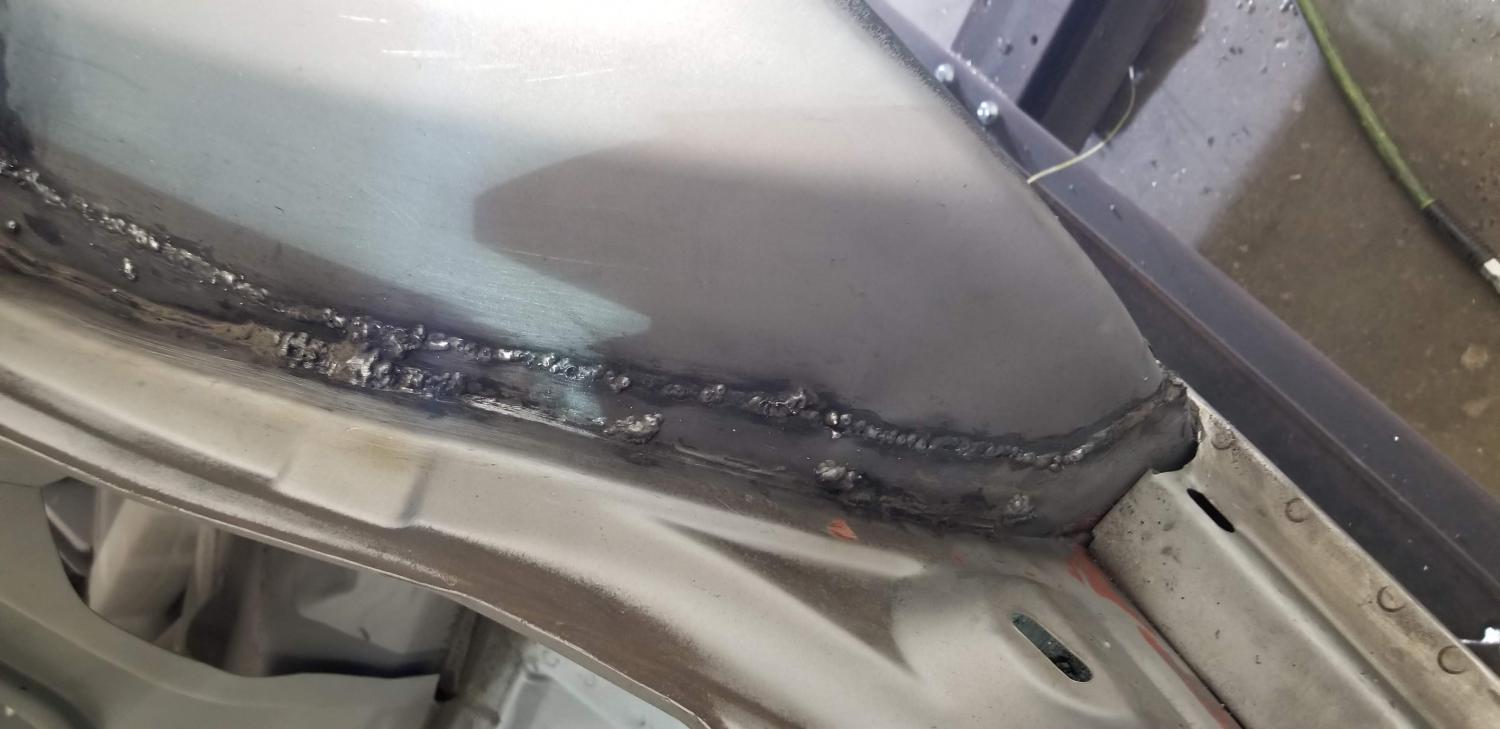

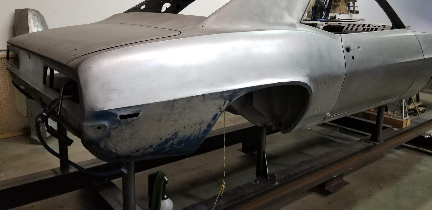

I sourced an NOS left side quarter panel from Camaro Central, they are great to work with, high regards.

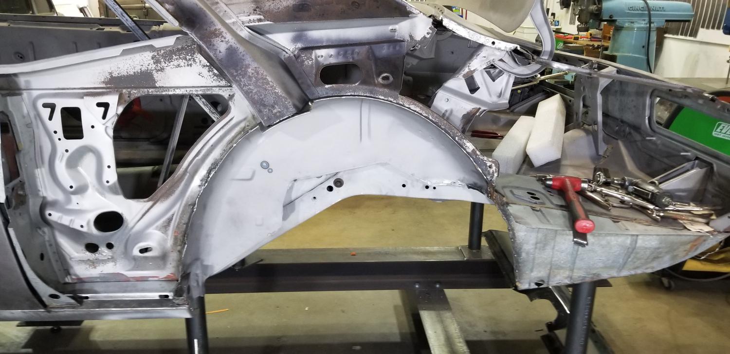

We found hidden damage under the quarter that had been reskinned, the outer wheel well had been repaired which made it impossible to fit the new quarter.
(Thinking a tire blow out or an axle let loose)
So I did some research and found a Sherman outer wheel well.
From what I could find Sherman was stamping parts in the US or North America a while ago and I was able to source one from Camaro Specialities, It was cheap and fit like a glove so did the NOS quarter.

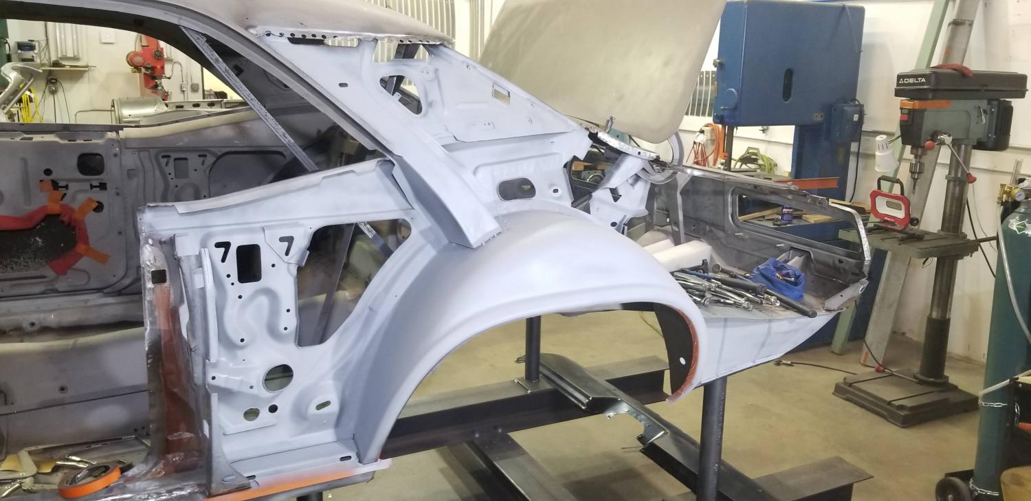

Man that’s a clean car. What did you paint the inside of the quarter panel (looks white) with?

Hey Jim, it's just a 2 part epoxy primer, it looks white in the pic but its actually light gray

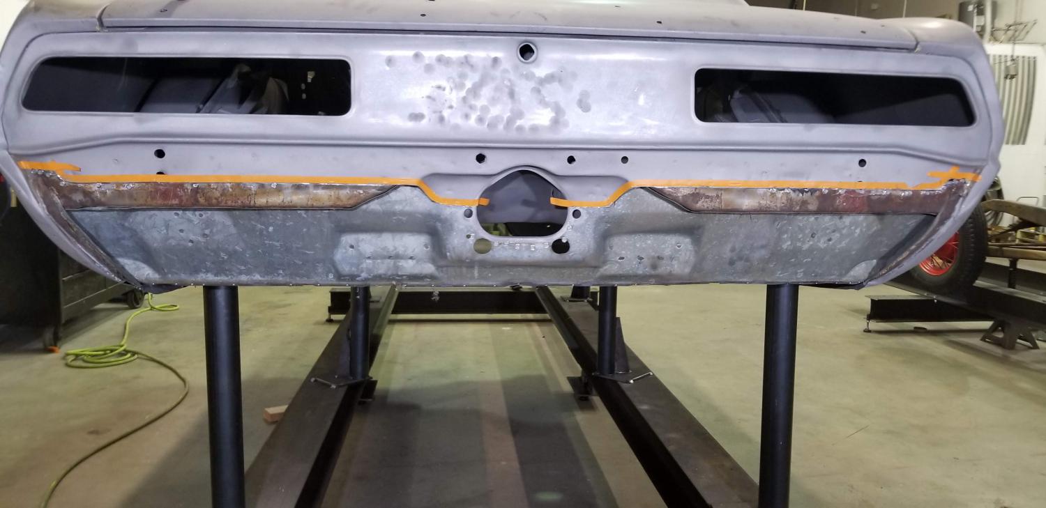

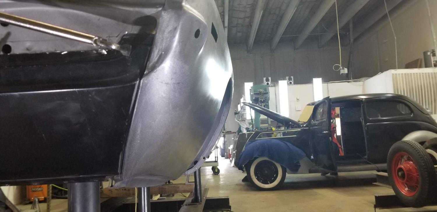

The lower tail light panel was riddled with small dents so we decided to use a patch panel, surprised how clean the galvanized structure was underneath

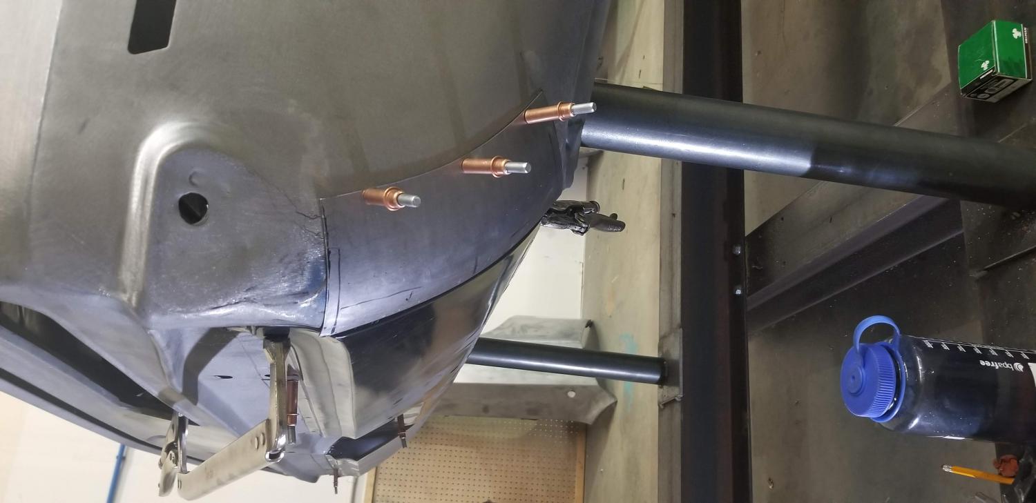

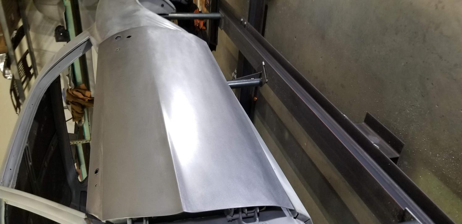

moving on to the right quarter

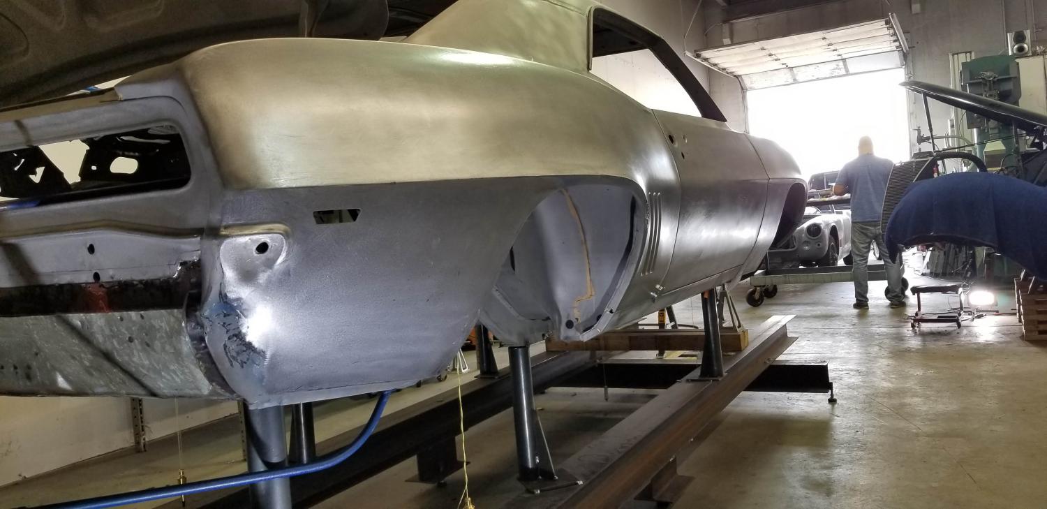

A couple more of the right quarter

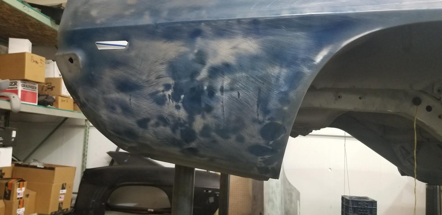

Old 09-03-2022, 01:26 PM
Wow! nice work straightening those panels.
Yeah, Craig at Kennedy Coachworks has skills

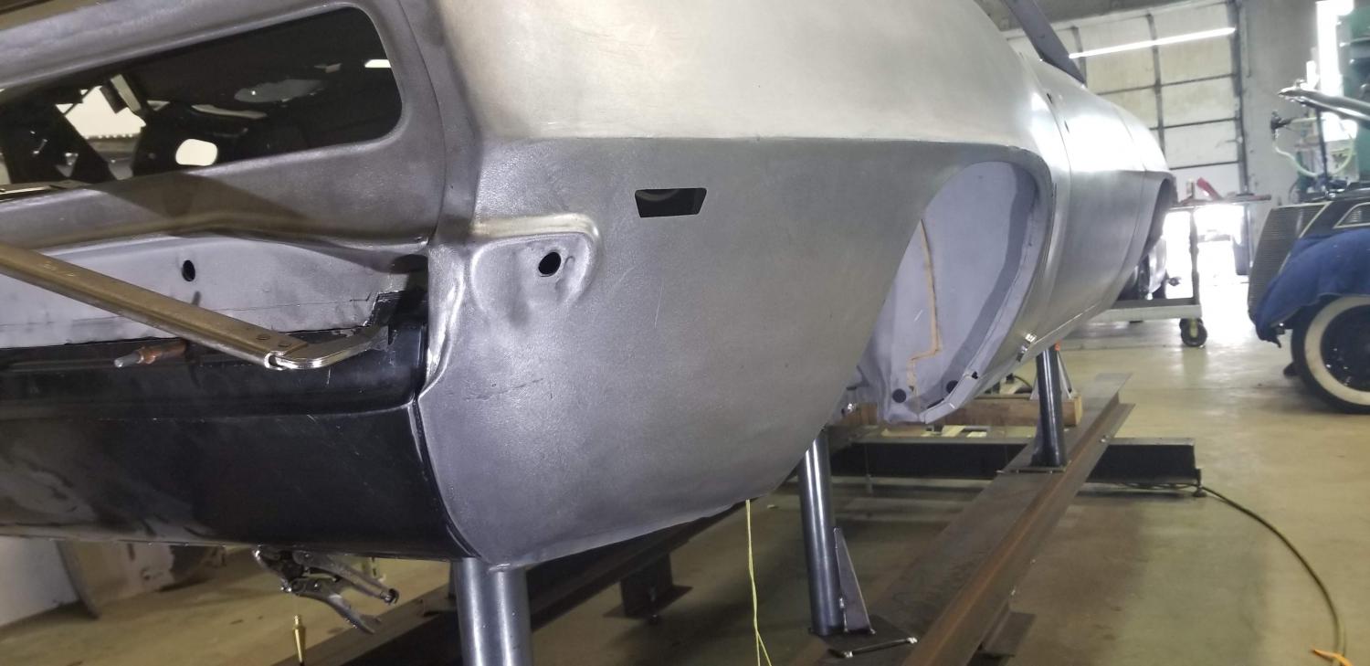

The doors
