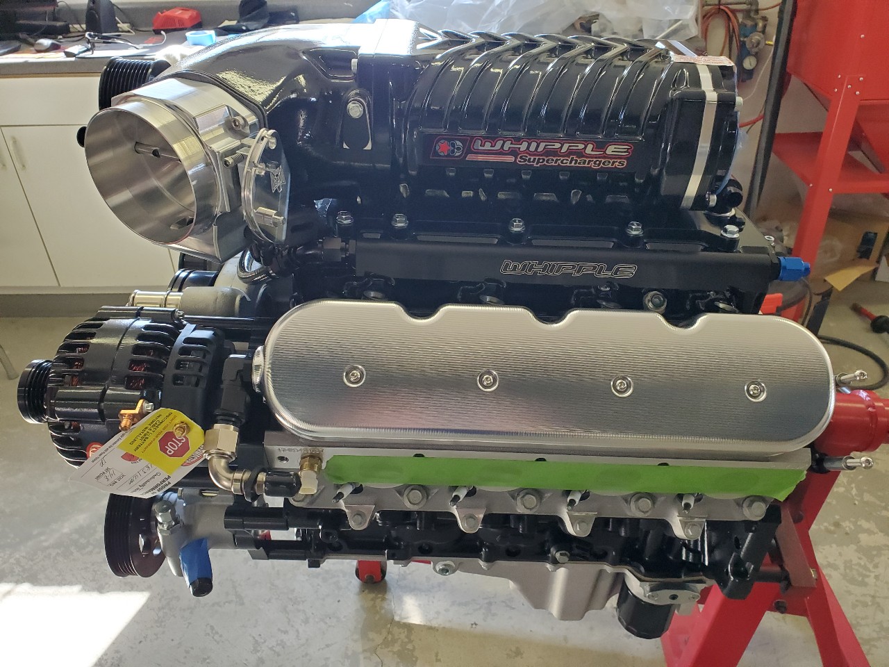

Thanks!! These are actually for my buddy (mine's a turbo), who's building a clone to my 70, other than an LSX/3.0 Whipple. His chassis is on order and his headers showed up, so I removed my exhaust and checked the fit for him. Super nice stuff from Ultimate Headers.

Funny you mentioned the 3.0 Whipple & Wegner combo-- I also have a brand new 3.0 Whipple and Wegner accessory drive sitting at the house... LOL
(It's actually for my car, after all these years I decided to ditch the still not completed twin turbos and go with the 3.0 Whipple. I recently tuned a car with a built LS3 and a 2.9 Whipple and that instant torque seemingly regardless of RPM is just stupid fun.)

My buddy has decided he wants a 70 Chevelle like me, so he's collecting parts for the build (still needs to find a 70 Chevelle lol). Roadster Shop chassis, LSX B15 engine, Whipple 3.0 with Wegner front drive, Tremec trans, etc. The recommended headers from Roadster Shop are made by Ultimate Headers. They showed up a couple days ago, and since my project is in limbo right now I pulled my exhaust off and test-fitted the headers.
Quality is phenomenal, fit is perfect, clears everything easily regardless of engine position, and sit above the bottom of the frame rails. Just wanted to give a shout out to Jim and the guys at Ultimate Headers for a job well done.
