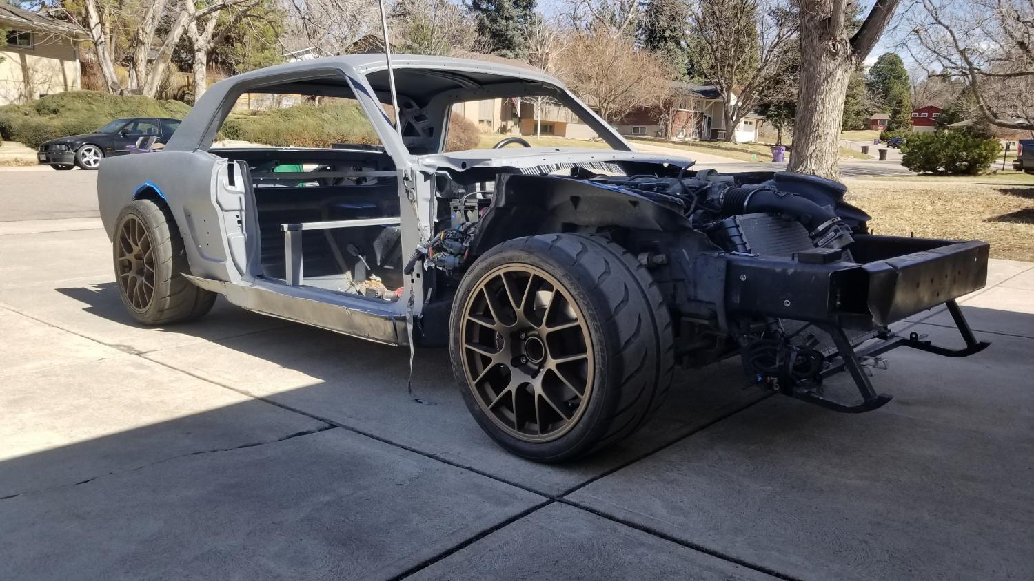

so, i had friends to help me lift the body. it was doable with 1 extra pair of hands, but having 2 extras was great.
i was hoping to keep as much as possible, but really, i think, in the end, maximizing what is kept and what is cut is a fool's errand. just cut everything and fill parts back in...
i did get the shell media blasted. I didnt want too many surprises with body work. I ended up epoxy priming (Eastwood)
I also got my wheels in.
18X11" ET57 APEX EC-7 CORVETTE
Tires: toyo proxee R888R 295 30 18
the stock springs are still in place. this is why the ride height is so great. ~7inches

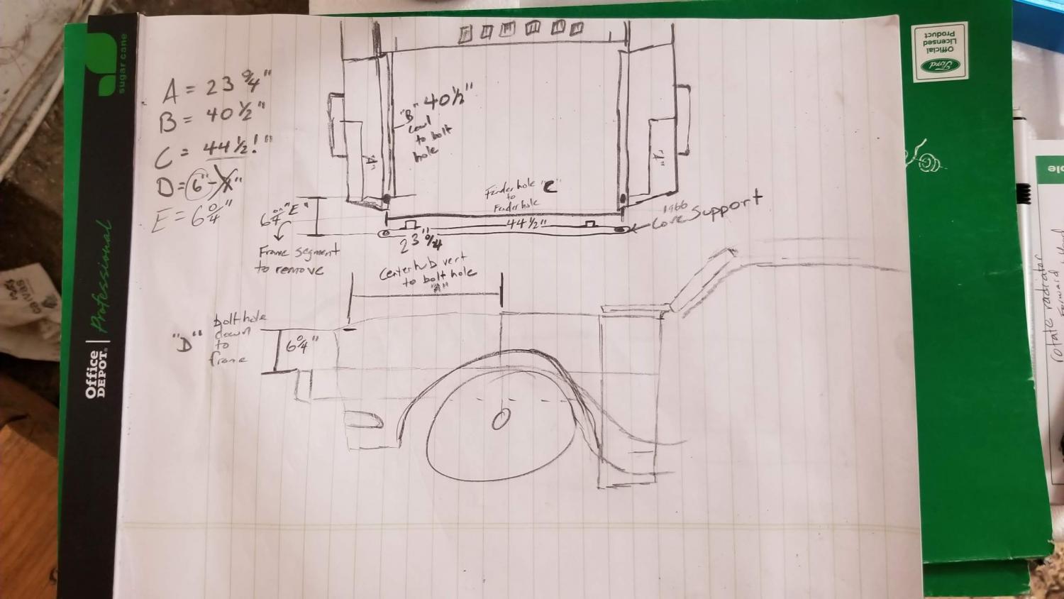

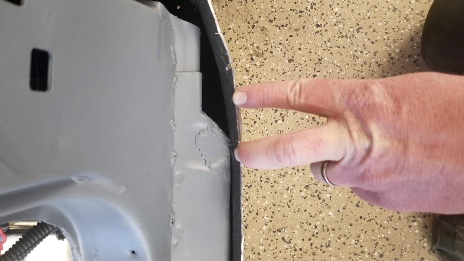

well, it has been a while. progress is SLOW.
because the mustang's wheelbase is about 3.5" longer, i had to shorten the WB on the Mustang body parts. i chose to remove it from btween the front axle and A pillar. I felt it would be least intrusive to the aesthetic if removed from there.
