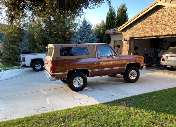

Time to start clean the engine bay and parts.

Mark,
It's going to be nice!. I have 1983 that I am considering going to LS. Mine was originally a 6.2 diesel that I swapped an SBC in a few years back.
Your transfer case looks like the NP208 so did you use an adapter from Novak or did it bolt up to the 4x4 4L70E version directly with no mods? I would also be curious to know what engine mounts you used. It appears you made your own spacers to get a little more lift on the pan. Looking forward to updates
Tom

Originally Posted by Tom.A View Post
Mark,
It was an adaptor from Advanced Adaptors. Bolted to the 4L70E and gave a electric vehicle speed tone wheel and pickup for the ECM.
The engine mounts were Holley, but because we used a GM truck oil pain we spaced it up a 1/4 inch.
