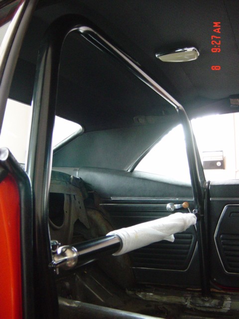

I bought a 8 point roll bar kit (11 sec. NHRA legal) from AME but only used it as a 4 point...the side bars hit the deluxe door panels and until I get my seats I wount know if I can put a slight bend in them to clear the door panel and seat at the same time. Other than that everything else fits nice and tight! All parts come a little long so you can fit it as tight to your car as you wish. Also the Chassisworks swingout kit I used for the harness bar is a very nice piece and well worth the money!! Check out pics of the install Here

I was pretty happy with the fit of the Alston unit - this was my first attempt at installing a cage and I think it fit pretty well.
Click Here
