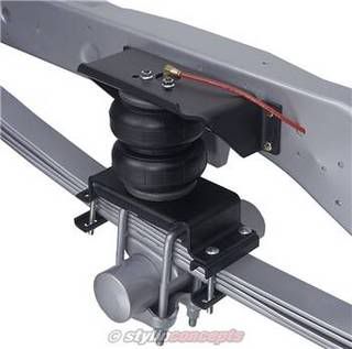

and for the rear: I want to go with the stock monoleaf+airbag. what airbag do I choose? the 7000 series or just a standard airbag+shock?
anyone suggestions?
  #20
Old 02-20-2007, 09:06 AM
darren@ridetech's Avatar
darren@ridetech darren@ridetech is offline
Join Date: Oct 2005
Location: Jasper,IN
Posts: 140
As long as the speedtech arms correct the ball joint angle and add caster, you could keep them. The 7000 series Shockwave would be nice on the back, but you will have to fab. the mounts, I wouldn't count on the oem mounts being strong enough. If you want something really easy the Air Over Leaf will work. Use part # ARK2004, that will give you the under frame mount for a 2.5" wide leaf.
