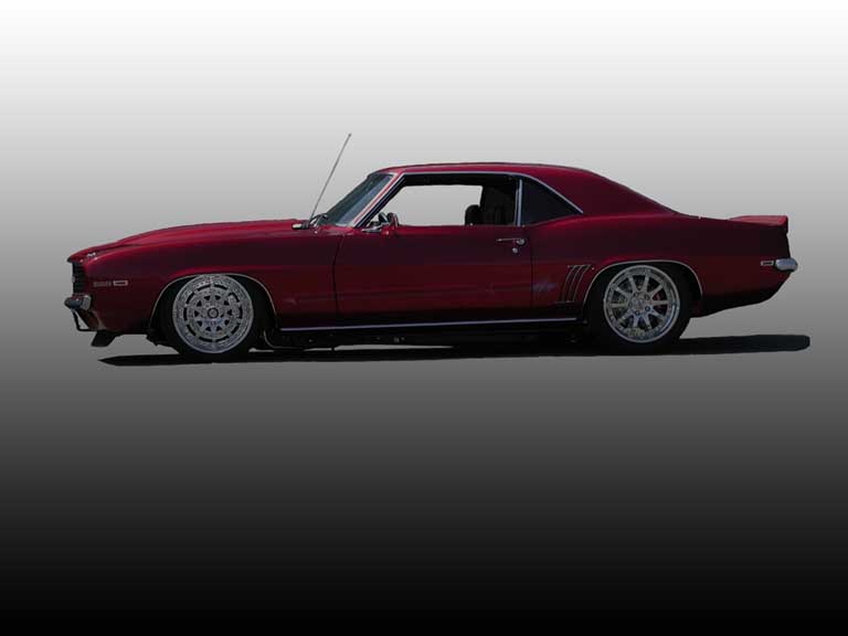

Thanks for all the great comments everybody. Here is a new photo-shopped image to get rid of all the noise.
