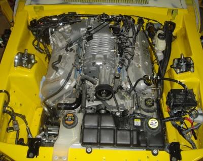

Hi RV,
I think that a yellow silver black color scheme would look great. Silver is also nice, but EVERYBODY is going silver (silver is the new red).
I was facing the same issues when deciding on a color for my car. I finally choose the path least traveled.
For your ref, here is a photo of my engine bay showing the colors I picked.
Bob

I like yellow, and your car looks nice. But what is it they say, that yellow is the new orange??
I think I will try to have a custom color made which will be the yellow pearl pushed heavily toward silver. Then use plain silver stripes. I think it could work. I'll keep the tires black just for contrast...
Why be normal.
I think you may be right about the all silver look...
Once the car is all in primer, I'll decide.
500+ HP, 500+ Ft. Lbs, 500+ Cu. In. Yeah the numbers match!

Hi RV,
Actually, I think they are saying that orange is the new pink.
If you are still thinking silver as a possibility, might I recommend the PPG Vibrance series. Their silver is the most intence I have ever seen. It is what we were considering before we went yellow.
Good luck with your project. Maybe when we are both done we can race for titles. I always wanted to own a nice Vett and I am sure that yours will be very, very nice when complete.
choise of color aside, I am sure your car will look fantastic which ever color you choose.
Bob
