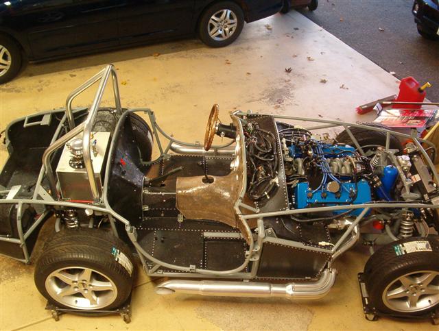

This is the story of my build, This starts over three years ago, I will try to get this story up to date as fast as possible;
Well, most of the stuff to get the build started is here. Now let the lunacy transpire. This frame promises not to be original style but more of a hybred of sorts. Read way to many chassis books and head still spinning for details now.

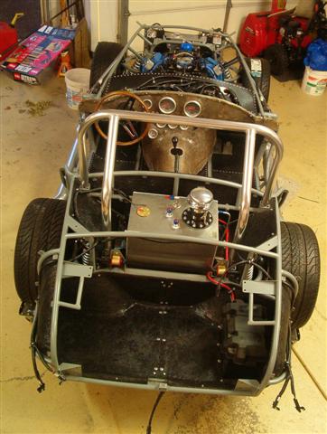

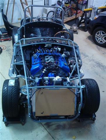

Hey everyone,
Look what happened, while everyones out driving around I'm in the shop working. Just a few photos of what I've been up to.

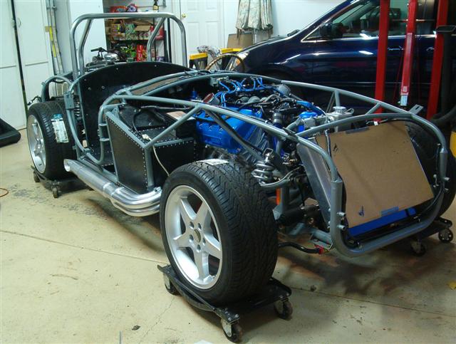

Hey sever crash wont stop us, reposted pics from Saturday. Have been cutting parts Sunday and Mon. eve. Yes the framework sticks back far but it will all come out in the wash, you'll see. She's going to fuel 289 style with the tank sitting on that framework.
see we're right back where we were. Patrick
