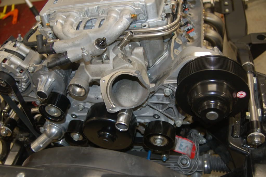

Originally Posted by DJW32 View Post
Mark,
Why not ditch the roots blower and use turbos? Wouldn't the turbos also save you some weight? Is ALL that torque down low in the RPM range absolutely necessary?
I thought about turbos but the blower has the following advantages
1 The GM blower drive is fully sorted out and validated
2 Less Heat
3 No turbo lag - better throttle response
4 Less fabrication - better packaging
5 The blower has intercooler built in
I've done turbo cars and I like the blower cars better so far.
The blower weights about 65 lbs and rest of the parts needed weight 20 lbs. So for around 85 lbs I'll add a bunch of power.
My plan is to have the car ready for Father's Day at Motorstate Challange. I'm not doing Autoramma due to my engine swap.
I've had the last week off for vacation and I've be able to modify the DSE sub-frame to clear the A/C comp. The GM A/C compressor would not fit so I mounted a Vintage Air unit. Also, to clear the A/C comp I need to swap to a 2002 F-car engine mount.
Last night I finished angeling the throttle body. My aluminum welding is OK but Joe's at Stenodes is great. So I'll take it to Joe tomorrow to weld it up.
Speaking of aluminum welding. Joe is also mounting my new Griffin rad, VA A/C condensor and the aftercooler. The Griffin rad is BIG. It it about 20 % bigger than the one I used in JA. JA never over-heated but we will be making more heat than JA.
Mark
