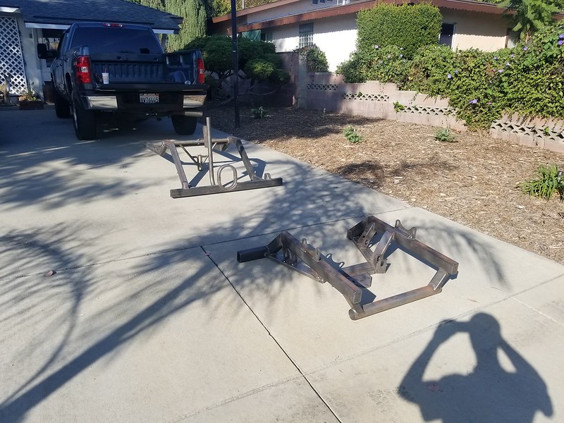

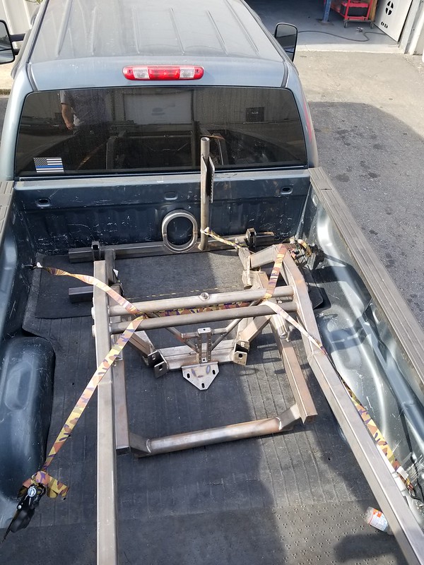

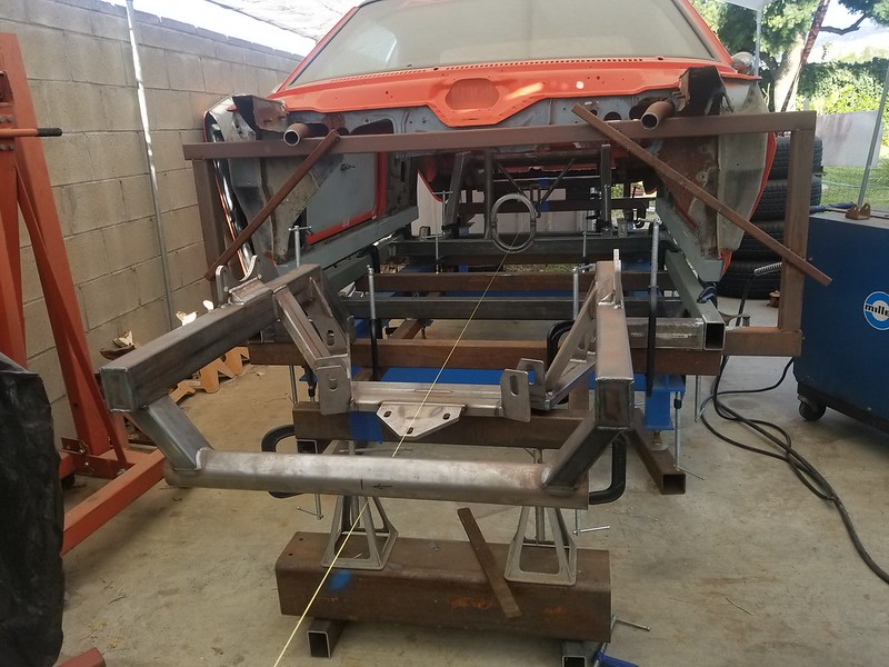

I want to build a nice pro-touring/autocross/track car.
For the front suspension I am going use C6 corvette components and a weld in sub frame that a forum member here, Scott Mock, built for me. It will have Strange Engineering coil overs and an AGR power rack.
Scott did a really nice job on the frame and even took the extra time to tig weld it for me. He fab'd up the steering arms and bent the sway bar arms. He always kept me updated on the progress he made, and shipped it out exactly when he said he would. Scott was great to deal with and answered all my questions. If you are looking for an awesome subframe, I would call him up.
