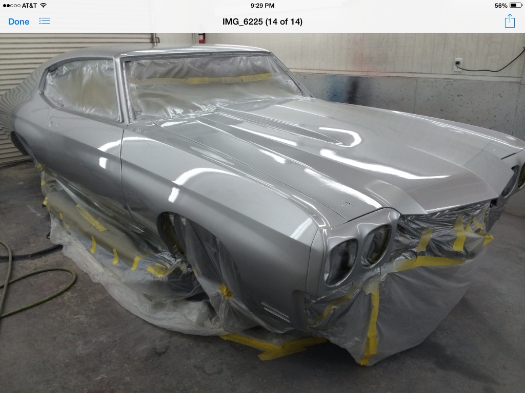

I am not, repeat, am not building a show car. I will drive this car. A lot. Having said that, my paint job will be a quikie. It will be nice, don't get me wrong, but I'm not gonna spend up all of my home equity doing it. I've been there and done that. So I'm gonna spend nearly all of this cars budget on chassis and drivetrain. I considered an aftermarket chassis, but I love fabbing my own stuff. I knew That I wanted a true coilover car, and I had a direction that I wanted to go. I looked at my GM frame and started with measurements, and went from there. After spending a lot of time on my front end, I realized that I could buy the Global West extended travel kit as cheap as I could build one, so that was first in line.
It's built very well.
