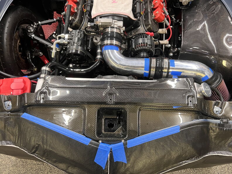

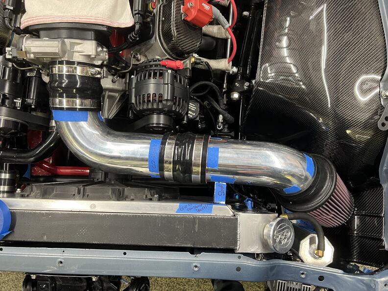

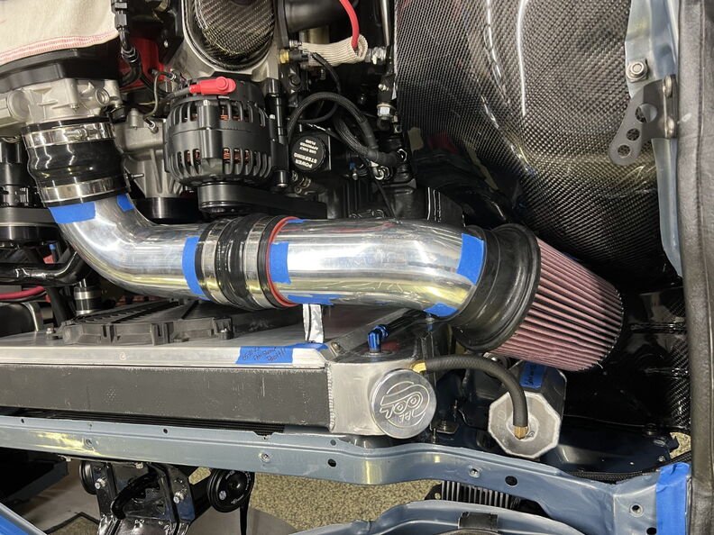

Default Final Intake Tube Mock Up (( 02-21-23 ))

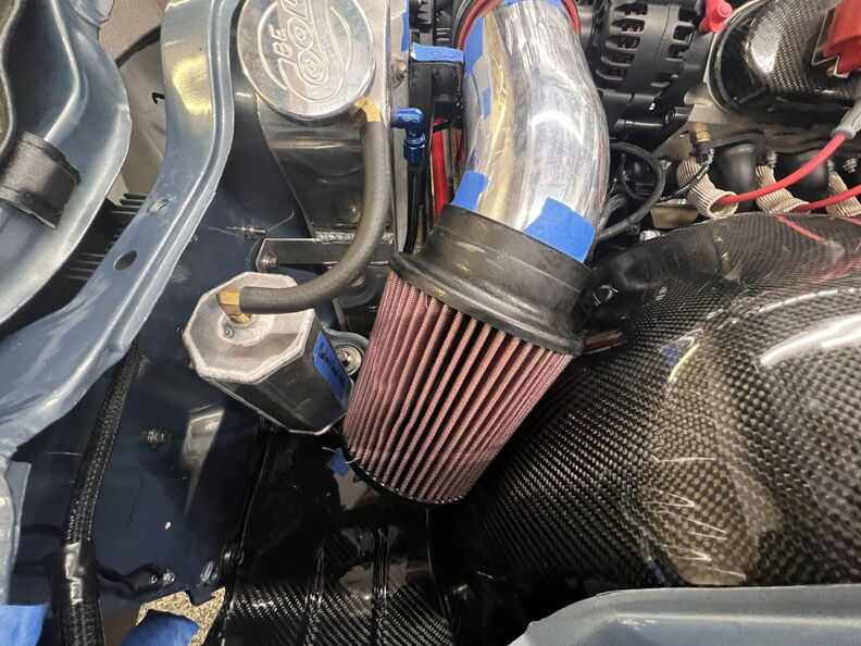

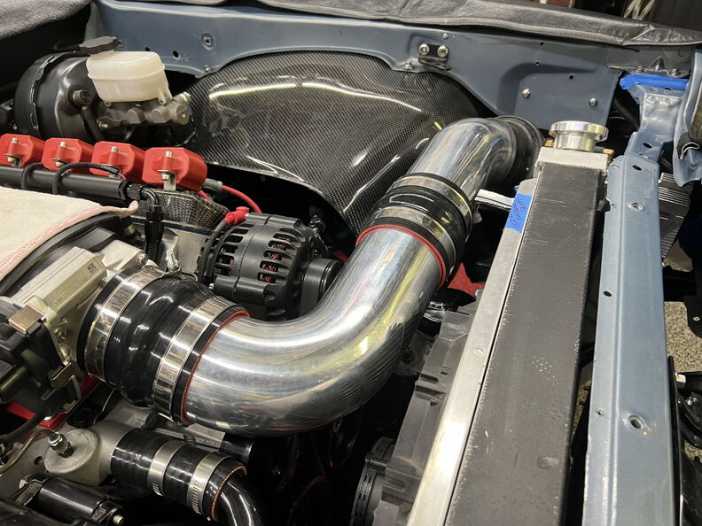

Once again I played with the intake tube so I can get the bracket made to support the intake tube.
I used the blue tape to reference where the tubes need to be once the clamps are tight. What you can't see is how
far I had to push everything into the couplers.
You can see where I plan to install the bracket from the fan shroud to the intake tube.
More ARP Hardware.

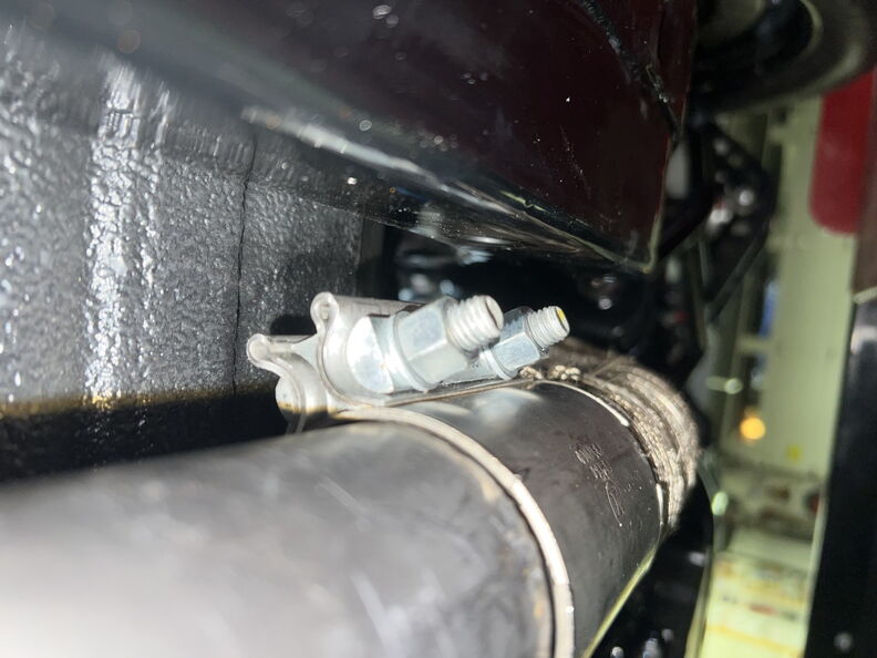

Apparently I forgot to tighten the exhaust clamps when Dr EFI Andrew was setting up the tune on the car. Good News
they are now tight and at the proper angle so they are above the frame rail.

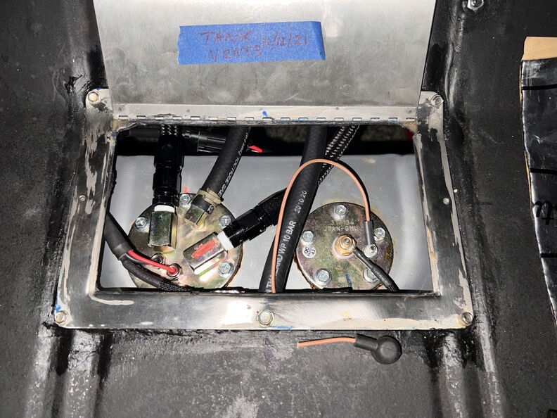

Fuel Level Wiring complete

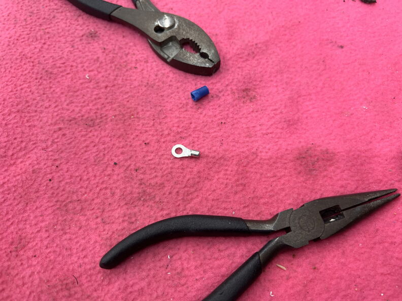

How could I have used this many tools

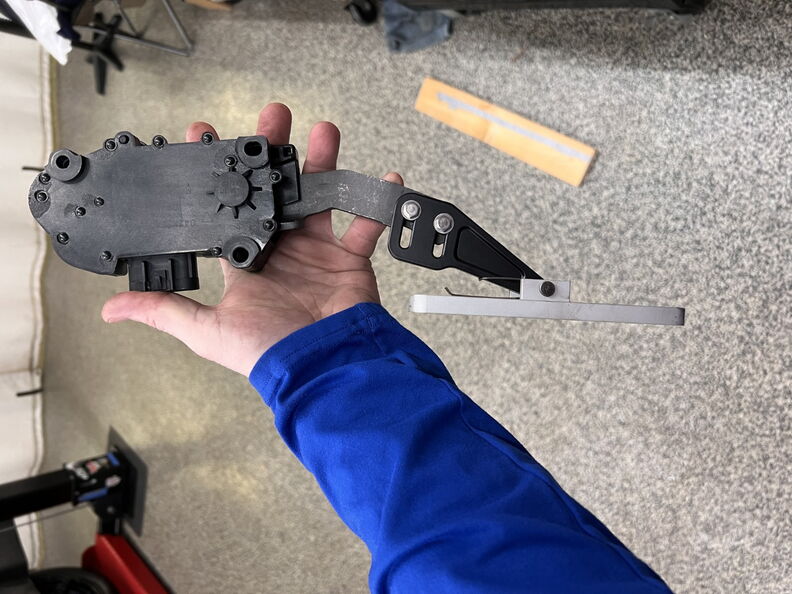

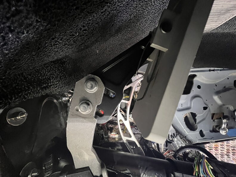

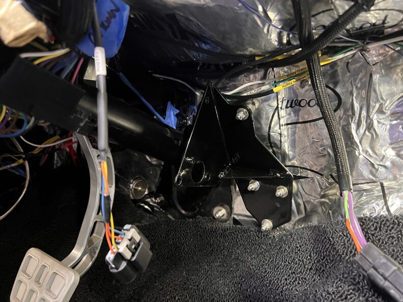

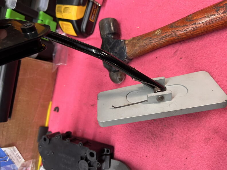

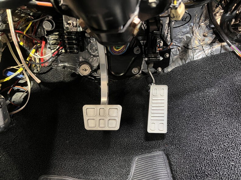

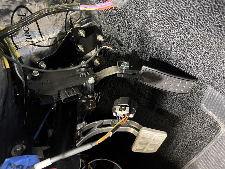

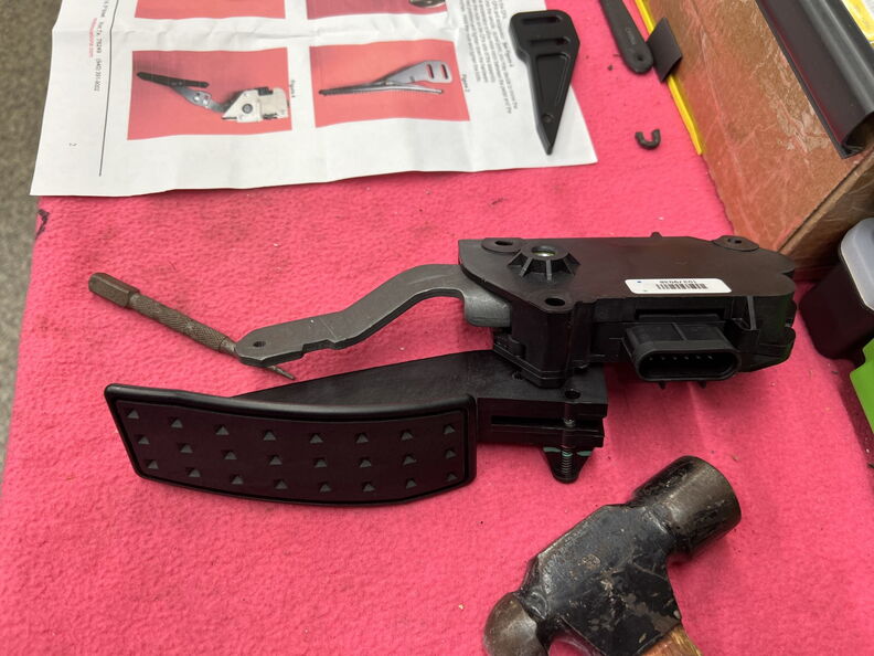

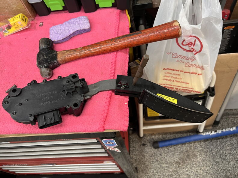

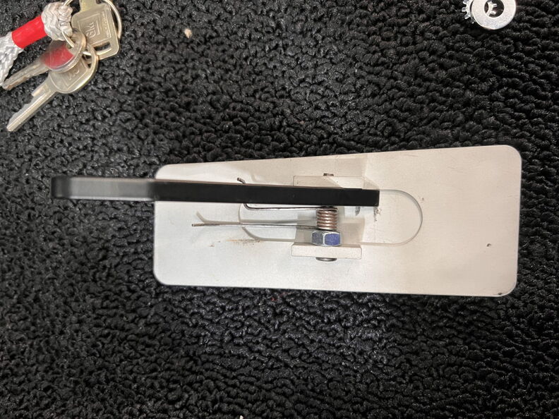

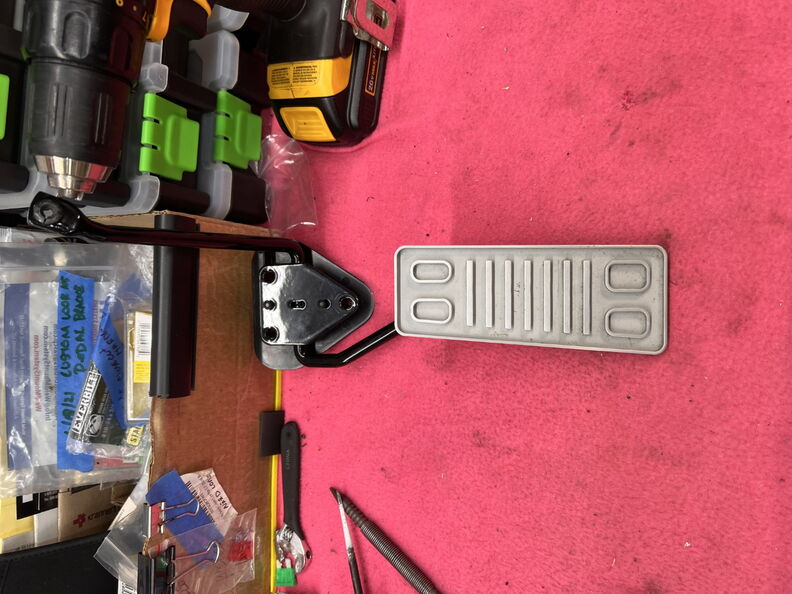

Default 2nd Chance Screaming Chicken DBW Pedal Bracket (( 02-25-23 ))
I ordered this bracket a long long time ago and somehow misplaced it. When I ordered I told Dave at Screaming Chicken
that the best way to find it is to order another one. Well, I was correct as the day I went out to the garage to install the
bracket I found the first one I ordered.
Step One - Remove the DBW Assembly
Step Two - Remove the factory pedal.

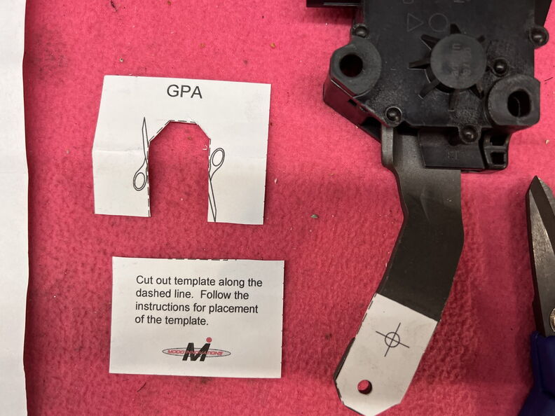

Step Three - Cut out this Template

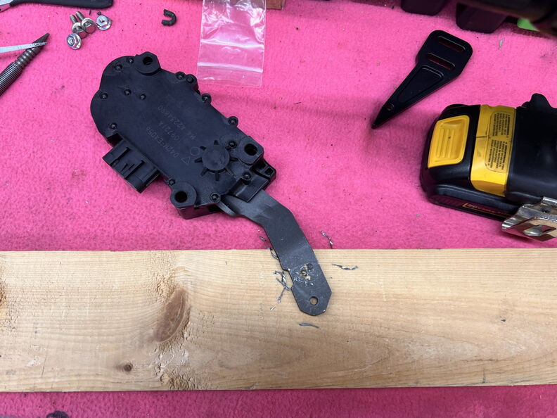

Step Four - Place the Template and Drill a hole in the target.

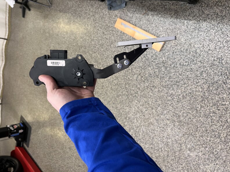

Step Five -- Remove my bad ass Billet Pedal
Pictures for reference
Step Six -- Install Pedal on the new bracket from the guys at Screaming Chicken.
One of the features I like with this bracket is it allows me to move the pedal over roughly 1/4"
which I think is what I need to miss the carpet on the trans tunnel.
Eventually I did move it over to the other side and it clears the carpet
One thing that I will have to do is replace the nut that I am using as a spacer. If you are using a factory
pedal you won't have this issue.

Great progress. I am glad you posted info about your air filter as I’ve been wanting to ask questions about it for months. So THANK YOU. It looks like it will fit my junk perfectly.

I know I'm the minority here but every time I see an K&N air filter I think back to this story my buddy told me last year - how he'll never use a K&N air filter again.
He had 2 different vehicles with problems resulting purely from those filters.
"It's the oil on them. It ruined the MAF sensors. 01 Silverado and 18 Diesel Cruze. 65,000 miles and 82,000 respectively and poof! Sensors went bad."
FWIW I guess.
The Following User Says Thank You to 1_Car_Guy For This Useful Post:
syborg tt (03-08-2023)
FWIW I guess.
I have heard the same story's and if I put 60,000 miles on this car and a sensor or two go bad I am going to be happy as it means i am actually driving the car.
Hotwire (03-15-2023)

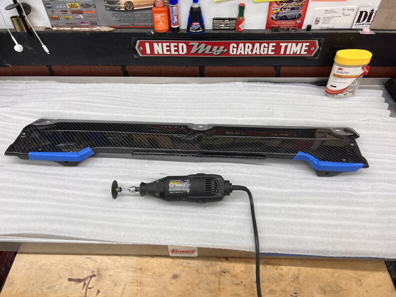

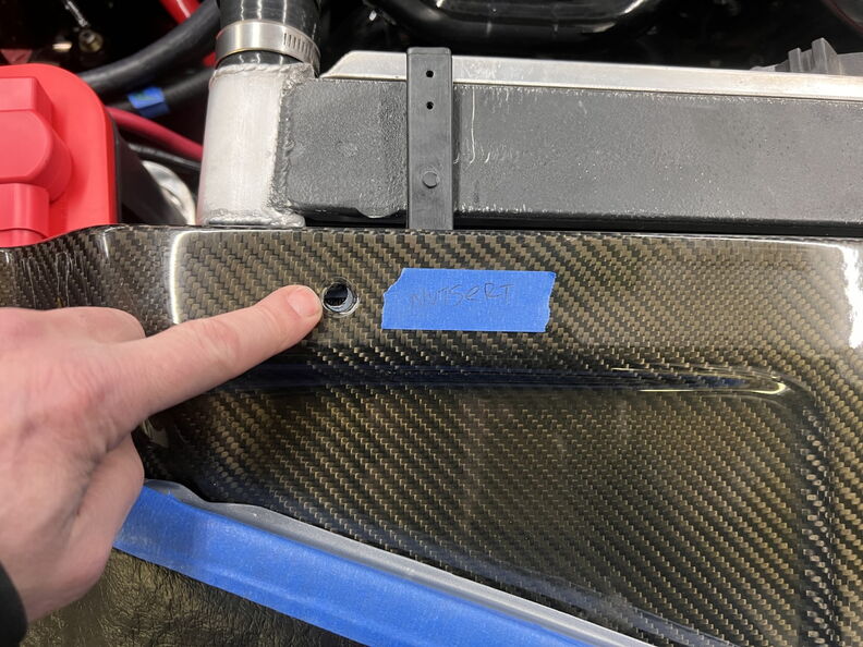

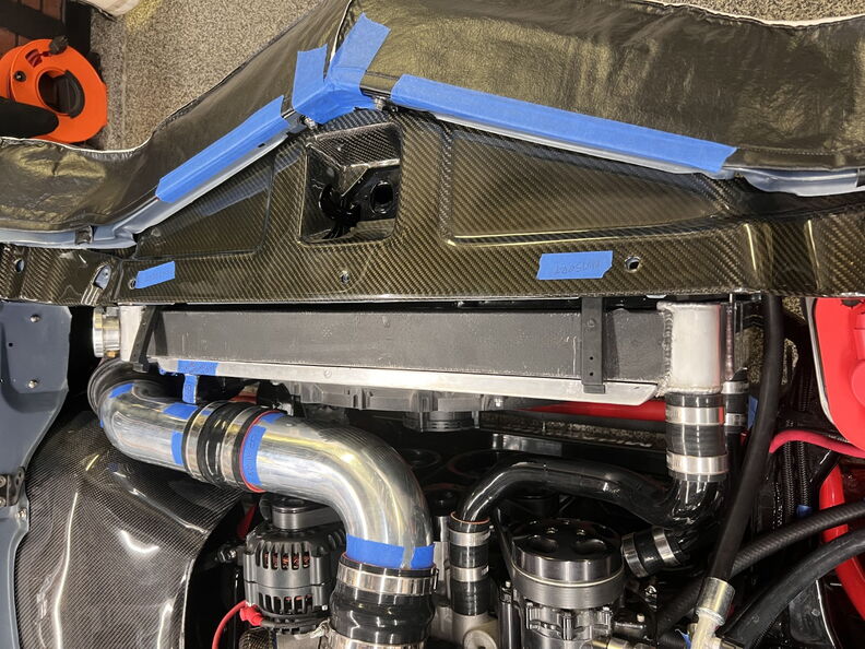

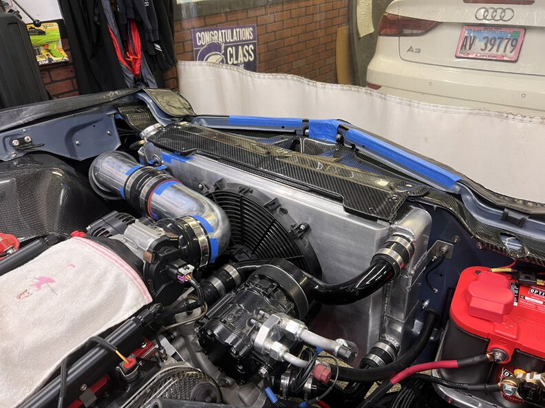

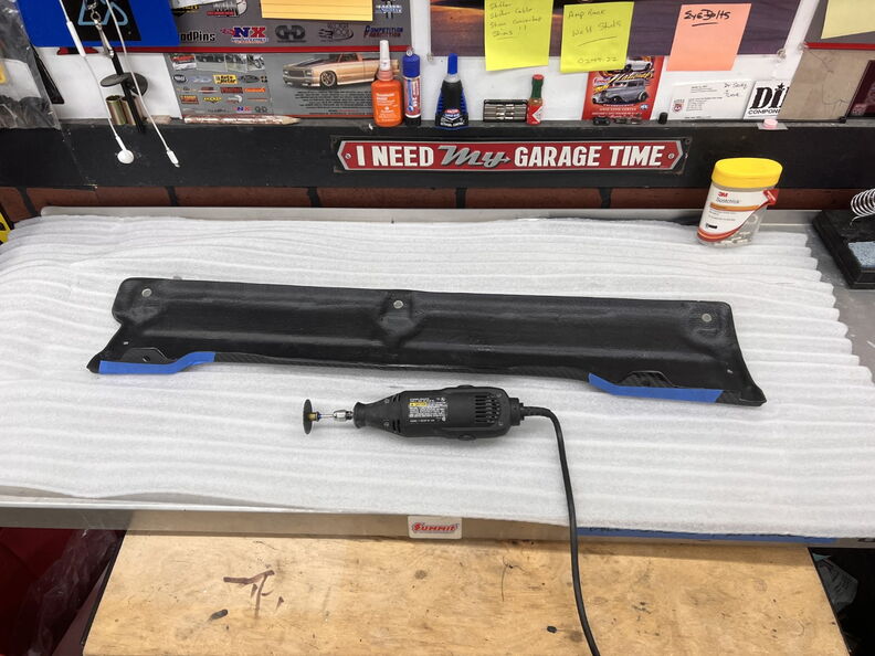

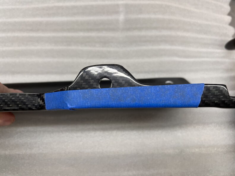

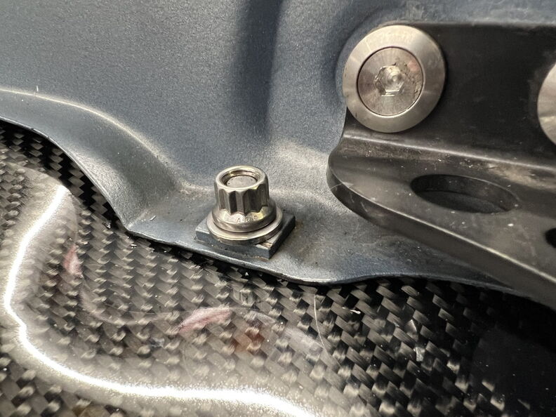

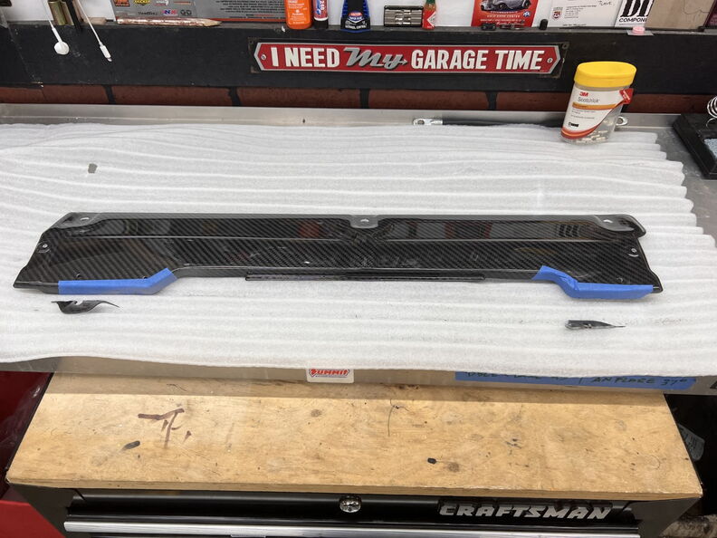

Default For the Love of Carbon I love my little Cut Off Wheel (( 02-28-22 ))
Since I am using the Afco LS Radiator setup which is larger then the stock radiator I need to modify this beautiful Anvil Carbon
Fiber Radiator Cover. Out comes my trust Dremel with the tiny cut off wheel.
In the next two pictures you can see how much needs to be removed.
All Better !!
I will need to install Nutserts since this piece uses the out most holes.
I have had the closeout panels since the first build and I contacted Anvil to see if they have one that matches the radiator
cover. They do have one that matches and they are taking very good care of me and sending me one that matches perfectly.
FWIW I guess.
Not to worry. He does not have a MAF sensor.
Andrew
