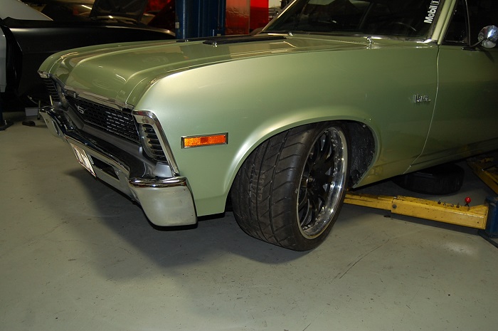

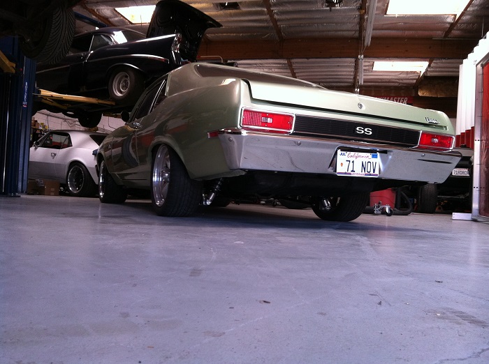

We are doing a 71 and we fit a 18x 10 6.750 back space.

Originally Posted by 31069ss View Post
Do you have a build link for that car ?
not yet, still in progress.
here are a few pictures.
What engine is in there ? Car looks amazing
