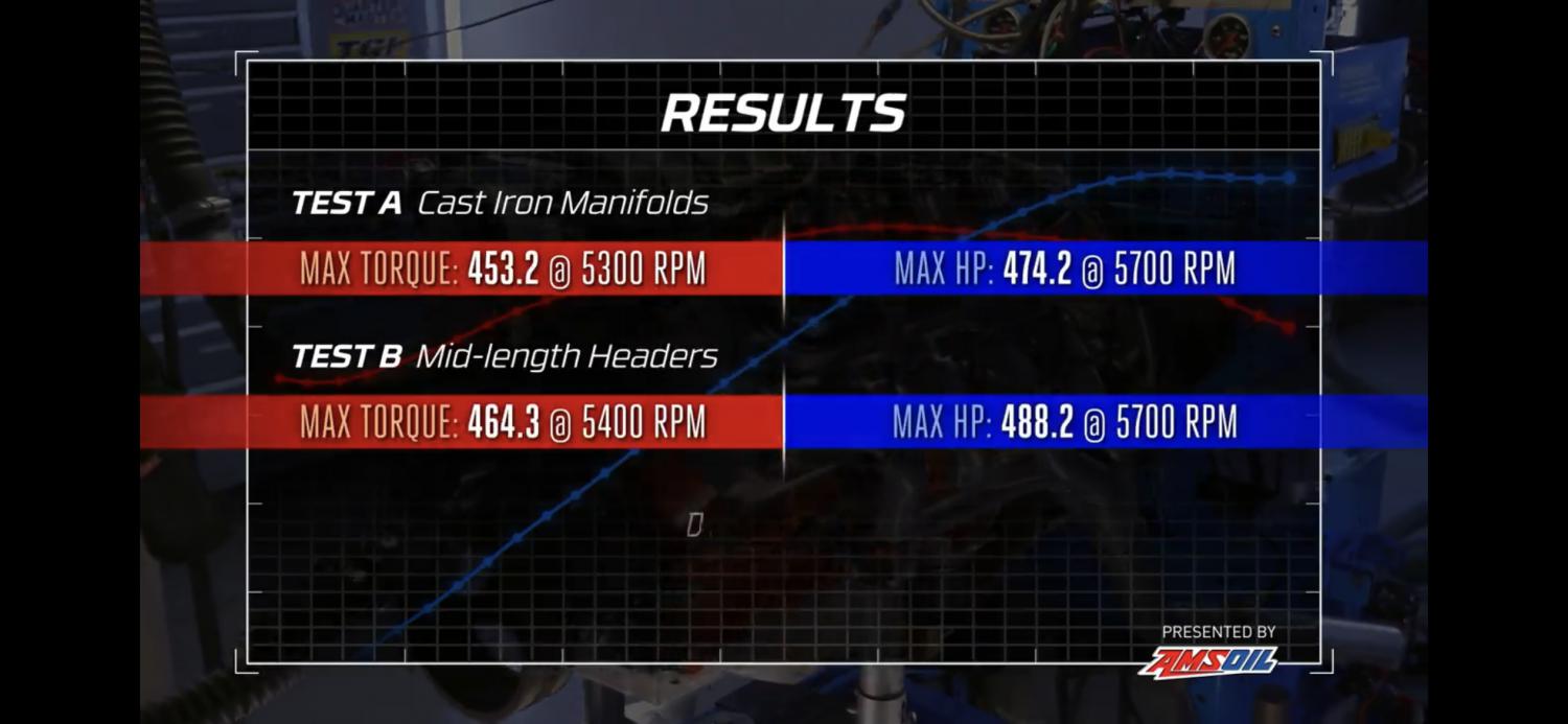

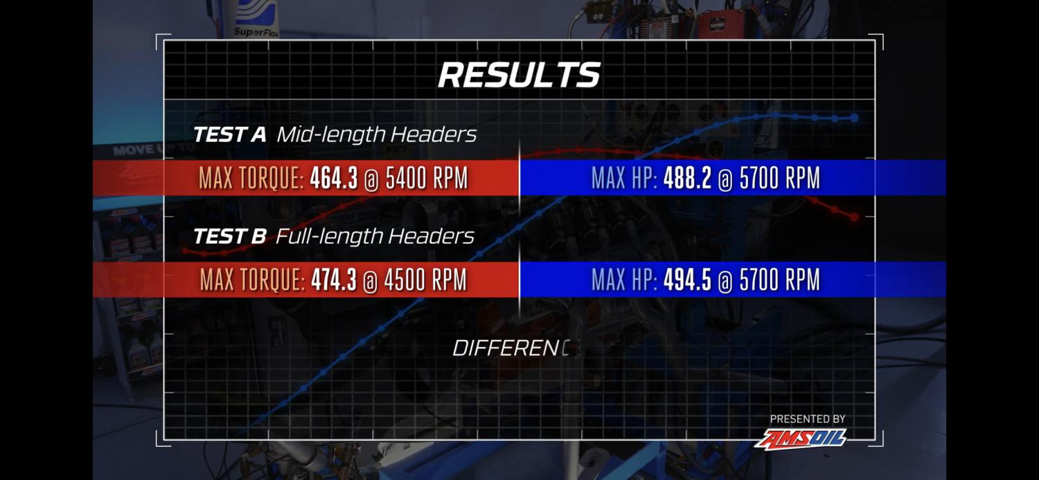

On season 1 episode 15 of Engine Masters they tested the Holley manifold against a mid and full length on a LS.
But for those that don’t have the capability of watching.

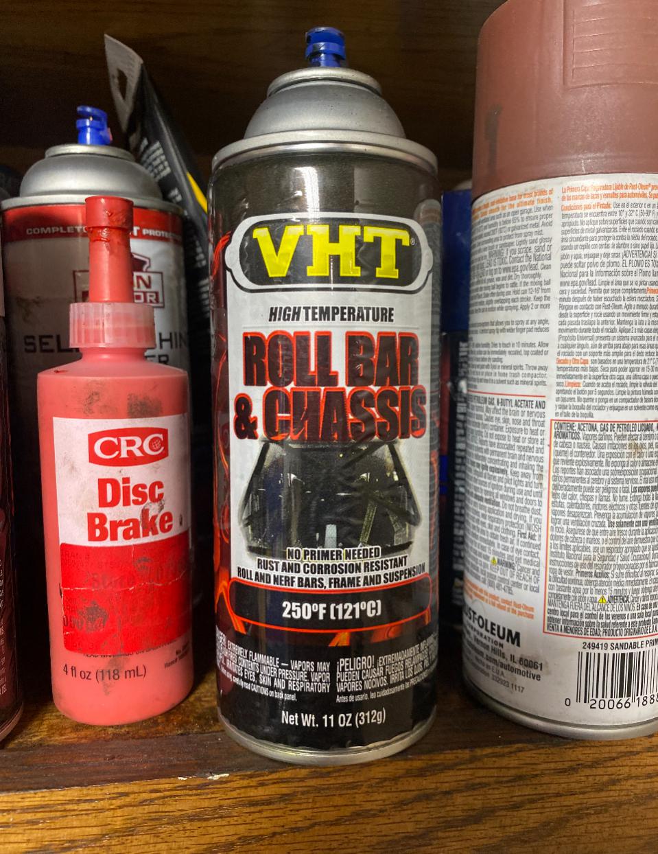

I am so torn with painting my Radiator and AC Condenser as I feel the paint always flakes off. Do you have any suggestions as what to use.
I’ve never had a problem, but I just had the Dutchboys paint them. Not sure on the process.

Marty I’ve had great luck with this - can’t recall but i think matt has used Eastwood chassis black on marks previous builds - project looks great mark
