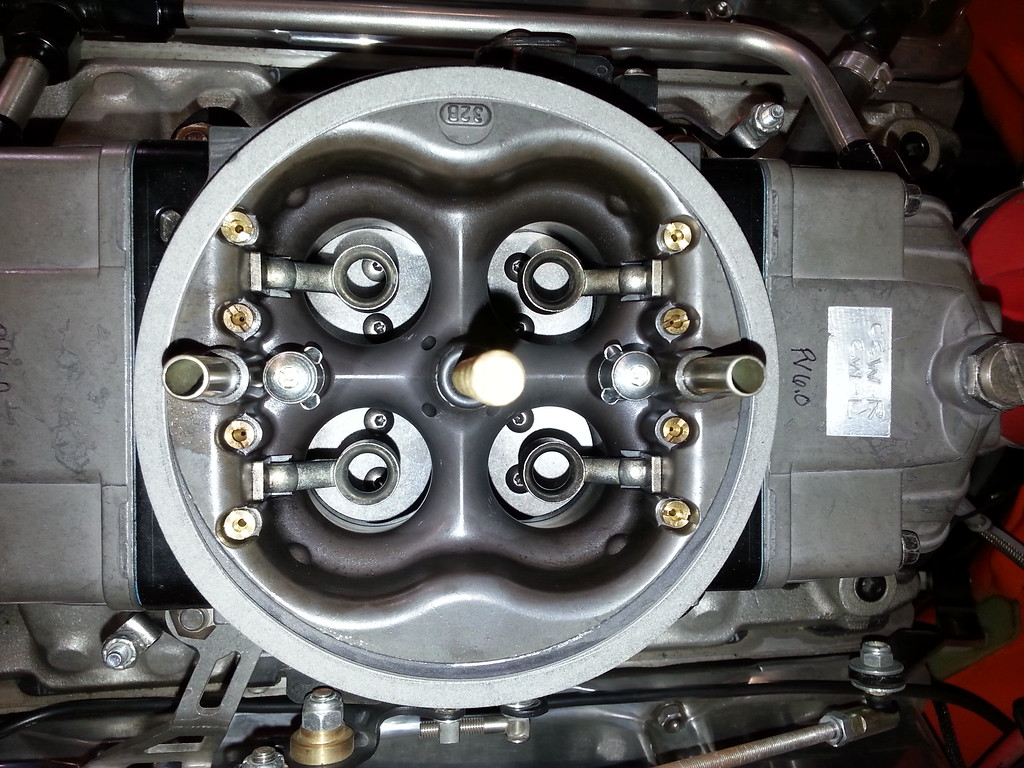

I've also been working on fine tuning the Ultra XP carb, pulled #2 plug yesterday and it looks like I'm gaining on it.
