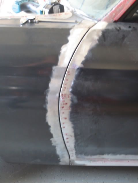

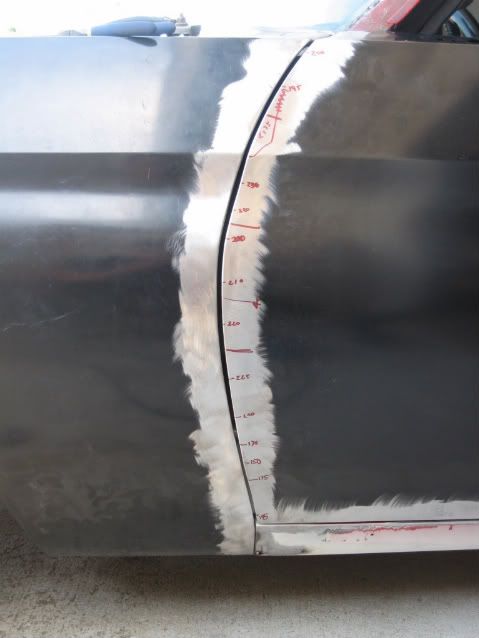

i finally finished the drivers side. i will start working the passenger door tomorrow. heres a before and after of the door to fender gap. one area in the middle looks a little tight in the pic, but i dont see it in person and it measures perfect.
