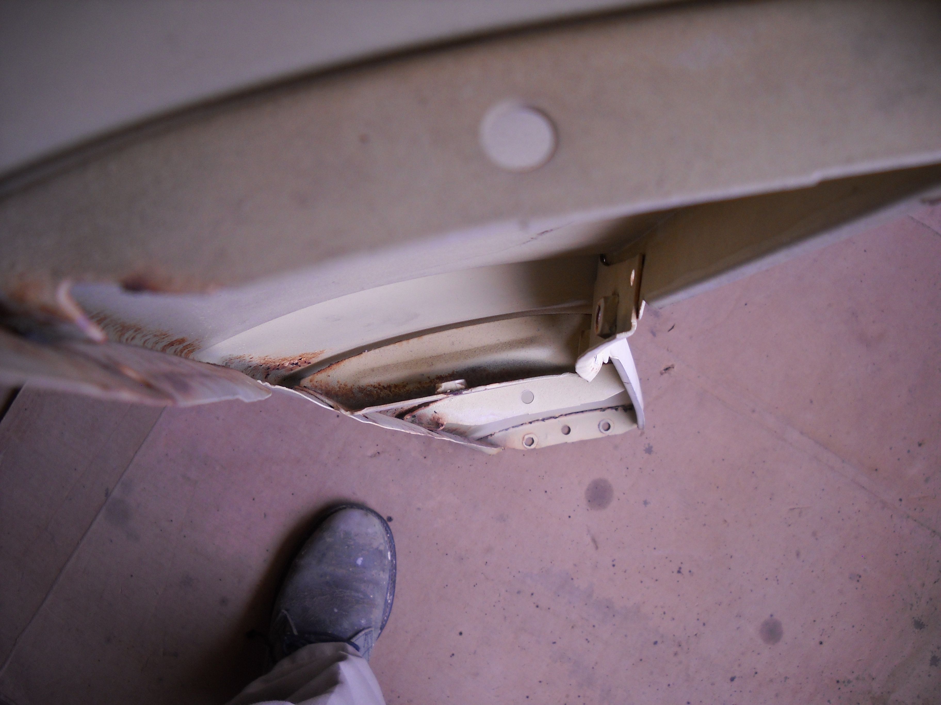

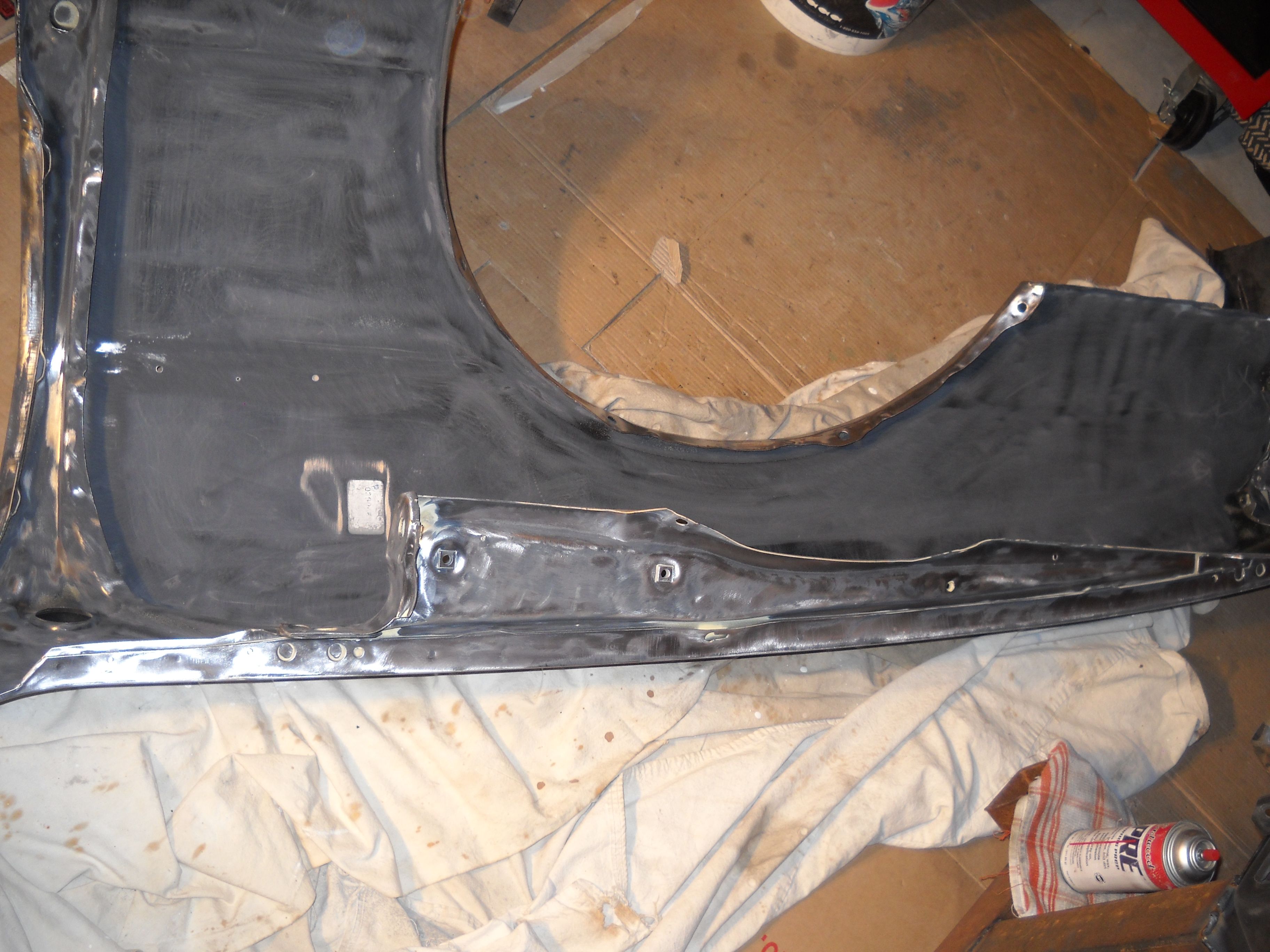

Not too exciting today... just finishing the fenders and getting ready for epoxy primer, still have to do the fender extensions ... and POR the surface where the fender and the extension meet. Bad news for the header panel - RUST ... so put a NOS header panel on the list!
Rust ...grrrrrr, scrap now!
Still need to get into a couple corner.
Scuffed the back side EDP for primer.

you cant sand blast the inside of the header???
If it were a single walled I would, but it is double walled on the ends and the middle ....and the rust would come right back to haunt me. So to play it safe get a new one.

Originally Posted by Sonar Chief View Post
Thanks...
If that is an original header panel, then I would have it sandblasted. Reproduction parts, no matter who made them or what part of the car they fit, are NO WHERE the quality of original GM. Get that sucker sandblasted and prime it and you'll be happier in the long run. You shouldn't have to worry about any future rust issues if its properly blasted and primed
