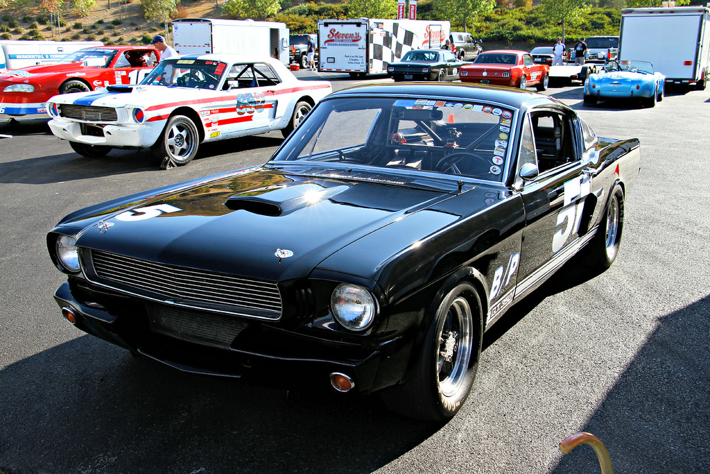

Isn't that the same set up you currently have? Was it just the ballpoint or did the spindle fail, I can't tell.

A fully documented one of six GT ordered without factory stripes that's campaigned in Vintage Racing East and West.

While I agree 100% with all of Ron's points, the blue Mustang went off track with all parts intact. The wreck caused the balljoint to break, not the other way around. We spoke to the customer a day or so after the fact.

Carl are those stock spindles on the fastback, they don't look quite the same as mine, maybe just a later year.
Besides the BJ, how did the rest of the equipment do? And just to clarify, I'm not throwing stones or starting anything, (this time) just trying to learn.
