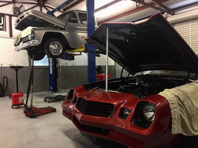

I still love working on this car, and it's even more apparent after working on the truck - race car simplicity is just hard to beat. In the span of a few hours on a Saturday morning I had the motor and trans basically ready to pull by myself, and we finished getting it out in short order in the afternoon.

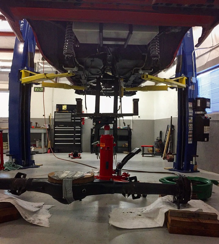

By lunchtime Sunday things were starting to get a little crazy. Front springs out, rear end out, just chaos.
Before this shop, there is literally no way we would have tackled all this at once. It's been a complete game-changer being able to spread out and get the car off the ground. A year in, we're completely spoiled..
By the end of the day, we had it mocked into position at ride height using some shock analogs fabbed up to hold everything at the current ride height.

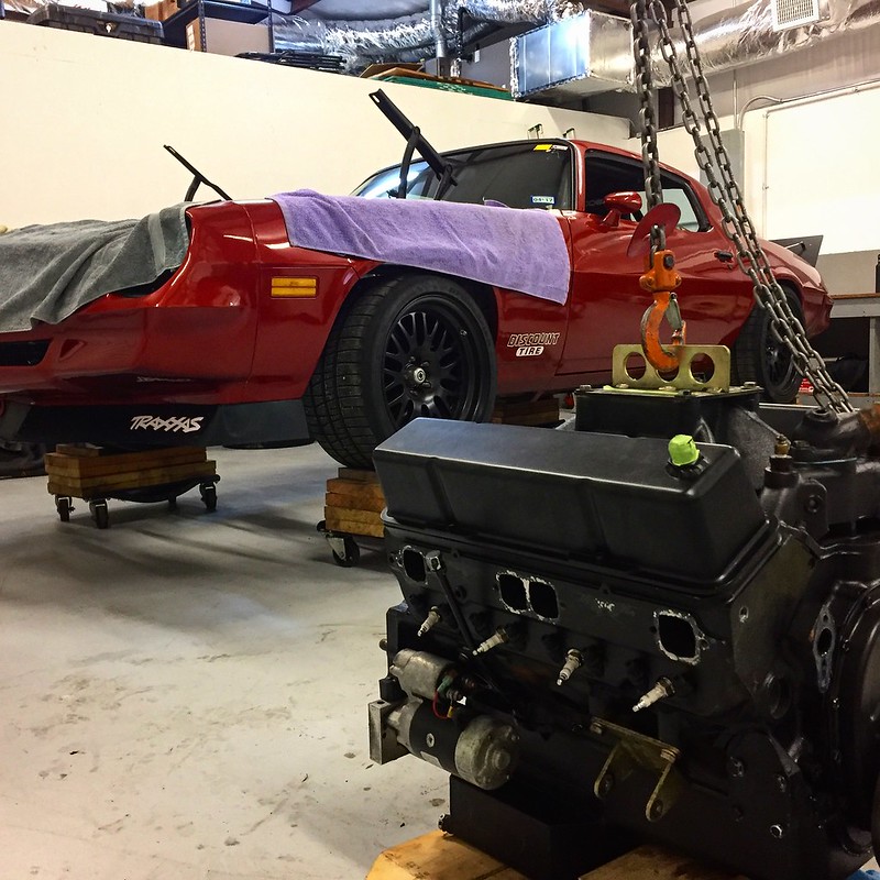

About that fresh motor..

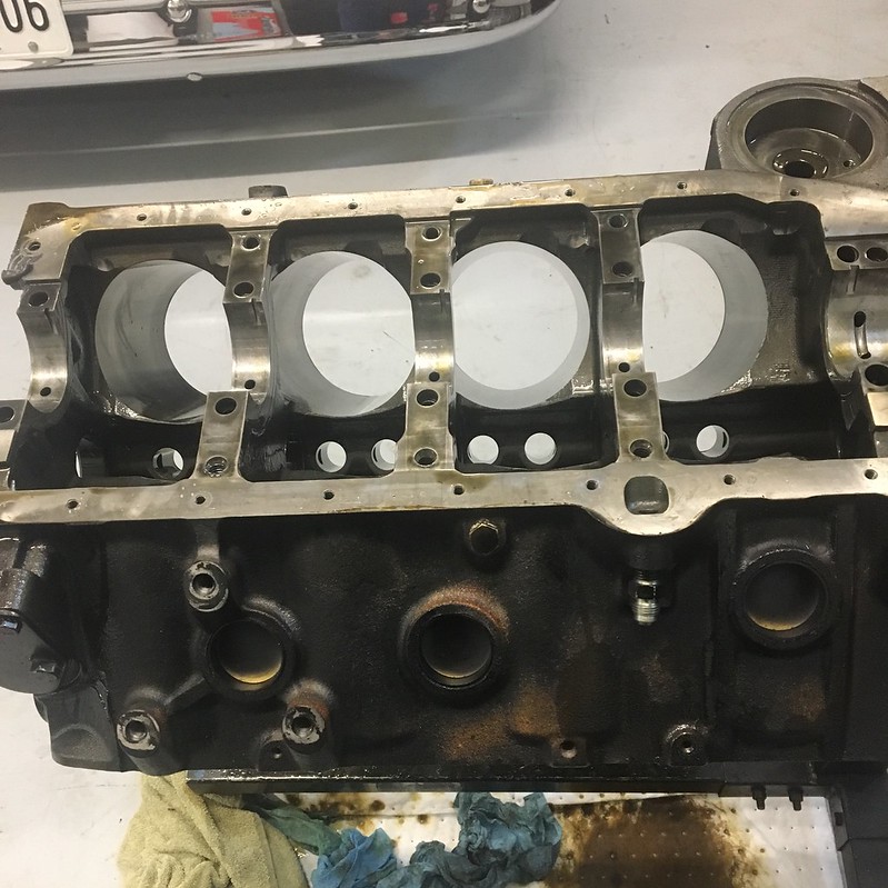

Replaying the videos from COTA alerted us to a bit of an oiling issue. Turns out, it's less than ideal dropping to 5 psi in high speed corners for multiple events. Spot checking a few bearings led to the decision to play it safe and go ahead and put a set of rod and main bearings (and a new oil pan) in.
We'll be going back with the same Canton oil pan we had on before. That one had some sealing issues on the rear main, but hopefully that won't be an issue with this being a new block.

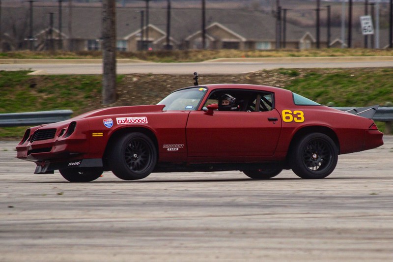

We hit a local club's autocross, where Dad got to drive the car for the first time and officially became HOOKED. Everything went well there so it was off to Motorsport Ranch Cresson for a NASA HPDE.
This proved to be an up and down weekend chasing some braking issues, but worked out well in breaking my fear of working on stuff at the track. I was also able to bump into HPDE4 and take a step closer to the crack of Time Trials.

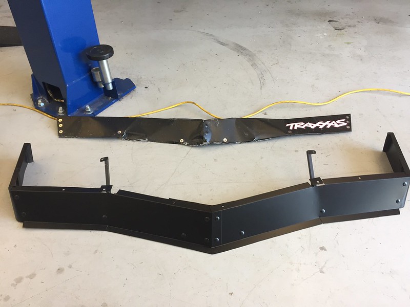

We still had some time left before NOLA, and the stock spindle and bearing setup began the stick out as the last weak link in an otherwise strong chain. We sourced a set of C5 bearing spindles from CPP along with 5x4.5 pattern hubs from Detroit Speed and blew the front end apart again.
With a few weeks left, the schedule fell perfectly to get an open track day and two autocrosses in before leaving for Louisiana. This would be the perfect shakedown for all systems, as well as a significant amount of seat time.

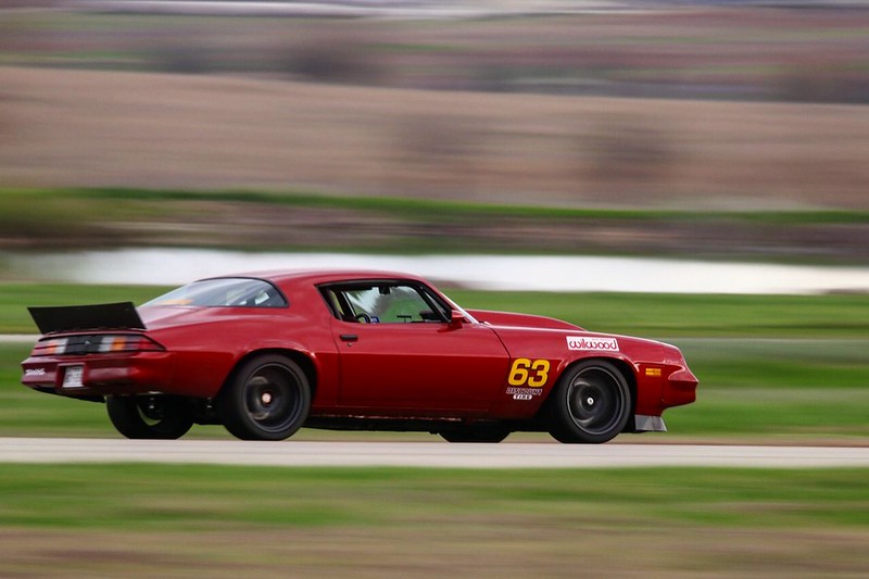

We headed to Eagles Canyon Raceway with the goal of getting a few sessions in with no issues. It soon turned into 3 sessions, playing with shock settings and tire pressures and actually tuning the car for the first time in a while. We chased a push through the center of the corners, eventually stiffening compression on the rear shocks a few clicks and going up in tire pressure to get some rotation on throttle.
That thing where you're -that- guy at the track day
When all was said and done, we had dropped 4 seconds off the lap time from last year and felt fantastic about where things were sitting. There was an autocross that Sunday, and it was too good to pass up..

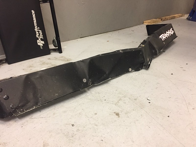

The event was being run at a lot known for being rough, and one section went across a ridge that fell smack in the middle of a braking zone. I had the unique experience of watching the car get broken, as Dad was driving it in a separate class during the heat I was working.
We loaded up and went home, and after a few days I had kinda sorta calmed down. Fortunately, I had the next Friday off and was able to rebuild the center section and get it buttoned back up for one last event before NOLA.

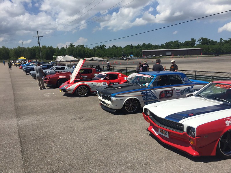

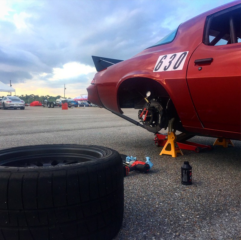

With a quick wash, some fresh brake fluid, and a general once-over completed, we loaded up and headed south. Got to the track, got tech'd, fire drilled, and decaled, then headed out to find some gulf coast seafood.
I'm not a 'take pictures of your food' kinda guy, but sometimes you just have to
Saturday we started out the day with design & engineering judging out of the gates, and finished in time to get our first autocross run in on the first trip through. I spent the whole morning tagging cones and being a general mess, finally gathering things up for a clean run as we went into lunch.
The course was fun, and required pushing right out to the limit of several cones to be where you needed to be. In the afternoon, I found time early, then fought all afternoon to put all the sections together into one run. We sat on a fairly comfortable lead until the next to last run, when Cody Puckett in, of all things, another 79 Camaro, got within .03.
He put together another clean run but wasn't able to improve on his last lap, and with the pressure off I let out a deep breath and finally stitched all the parts from earlier together into a 30.9.
The new format has autocross going all day on Saturday, which ended up being fun because we got to run with all the cars in our class vs. being split up like previous years.
Saturday evening was the road rally, D&E points were posted (a bloodbath for us again), and then we did some general maintenance including a pretty substantial carburetor change for the incoming cold front.

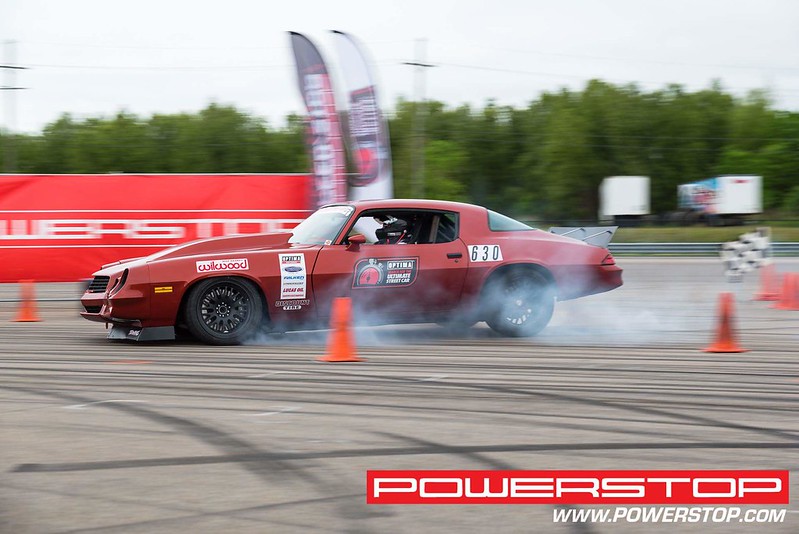

In previous years, Sunday has been pretty typical of a standard track day. Go out for 20 minutes, come in and chill and look at the data, repeat. This year, the Speed Stop moves to Sunday and makes for a pretty hectic but fun affair.
Timing issues in the morning caused some delays, so we spent time at the Speed Stop chasing time on both sides of the mirrored course.
The whole day was kind of a blur, and I never managed to get video of any of the Speed Stop runs. Through random draw, we kept getting the right side first which put us on the left with hot brakes and tires. A 9.46 came fairly early on the left, but I just couldn't find the pace on the right until the very end after road course session 4 with a 9.37. We weren't able to keep up with everyone in our class, but felt good about the times and called it a day with that.

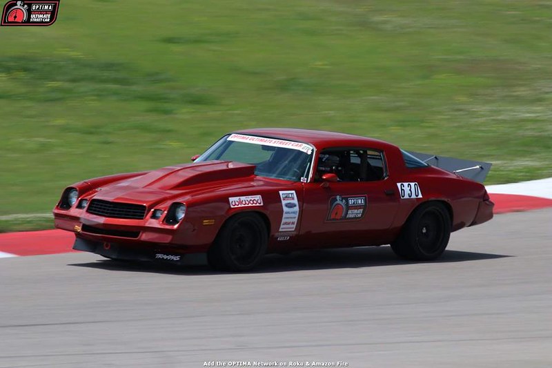

Road Course
Oddly, we came into this event with way more seat time at the track than on the autocross. I had studied up on video and track maps, and felt pretty good about the layout. The back side of the track has a similar flow to the front section of COTA, just without the hundreds of feet of elevation change.
Thanks to Optima for the shot
Consistently found time throughout the day, and our move to the expert run group proved to work out well with tons of clean track in every session after the first.
The T56 really paid off, as the car now just keeps pulling hard in 5th gear, running up to 145 on the main straight. We are planning some aero work for the front end that will hopefully help it out in that area in the future.
It once again came down to one final session. We had waited for the charge from Mills in the Beach Cruiser 68 all day, and went out for the last session to take one more shot at improving after sitting on 1:58s for three sessions. I was able to hook up with Feras in his Z06 through much of the lap and get some help with the line, and cracked the 57 mark with a 1:57.840.
The predictive timer on RaceChrono wasn't working, so I had no idea if the lap was good or not. It wasn't until I pulled into the hot pit after a cool down lap that I realized what the time was. It was an awesome feeling to finish up all three events with our best time of the day at the end.
When it was all tallied up, the road course was our best overall finish, which is huge.
