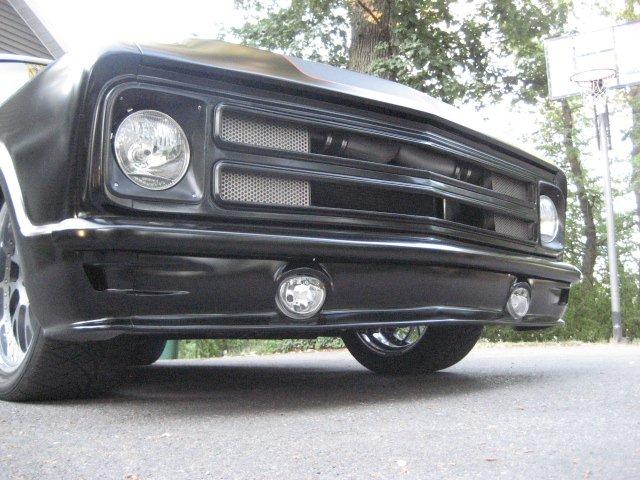

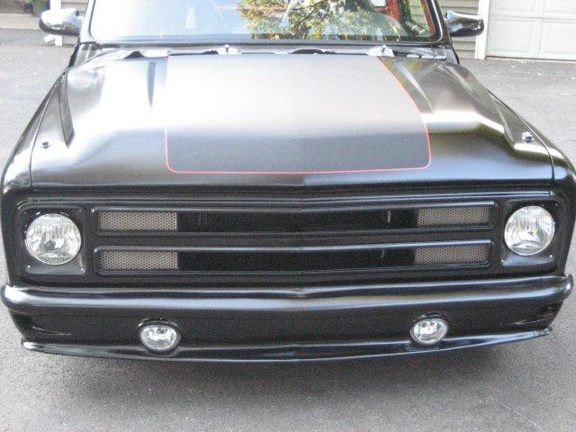

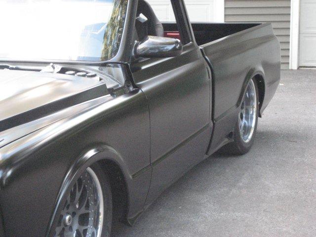

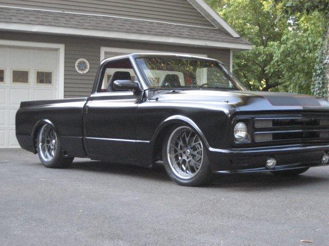

heres a few progress pics. i took a good break from working on the truck due to youth travel baseball and softball,so my pics dont show that much progress. im currently in the shake down phase. everything is working good and im super impressed w my ls set up. thanks for checking in bill

Oh man that looks awesome. nice very nice.

All I can say is WOW! Now I know I need to get down to see you. That is awesome.

Looks great Bill! I love this truck!
Other than the cowl panel what is left to finish?

windows, interior,a/c hooked up. still alot of headaches but atleast its driving.thanks bill
